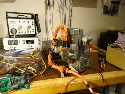

For the Audi A2 conversion I will be using the left over A/C compressor from the Gen2 Leaf motor stack (probably the same for all Leafs). Here is what I have found out so far
Logic connector: - 1 2 - 3 - (3 pins blanked) 1 = GND, 2 = 12V, 3 = LIN
LIN baudrate is 19200
I have found data to be returned on id 17, 33, 35, and 38
I connected some low voltage to the power input but never saw any of the messages change.
Bit 16 of id 17 goes high as soon as you try to send on any of the read-only ids but also on id 60. Maybe that is the control message? Will need to monitor the other data as well. Will keep updating here.
UPDATE:
listens to messages 32, 34, 59, 60.
When 32.0.0 (byte 0, bit 0) is set to one, message 33 becomes alive. Shows undervoltage flag in 33.2.6, voltage in 33.7. Must be multiplied by 2 to obtain bus voltage.
UPDATE:

Alright, some more insight
Byte 2 (not bit 0) of message 17 certainly flags LIN errors. When all is good its value is 0xF8, in case of error 0xF9. So bit 0 of byte 2.
It also signals errors if you send a control message with wrong length. With the help of that I found that it seems to listen to messages 32, 34, 59 and 60. I haven't found an effect of 59 and 60 yet. All control messages need to be 8 bytes long
When message 34 is send, message 35 changes its content from all zeros to 03 7f 00 11 ff ff ff ff - no idea what it means yet
More interesting is message 33. It changes its content when message 32 is sent with only the first bit set. If you set any other bits, it returns to all zeros.
Byte 2, bit 6 is one when there is too little voltage on the high voltage input. Not quite sure what the threshold is. Maybe about 100V, 170V is enough and thats as low as my transformer goes.
Byte 7 is proportional to the bus voltage, namely udc/2. It doesn't become 0 when there is no voltage but settles somewhere around 90V.
Byte 6 also sometimes changes but I don't know what it means yet. Settles at various values and slightly changes when HV is turned on. Maybe current?
Apart from that I haven't gotten it to spin yet, but then it's just sitting on my desk with no gas in it. So maybe that's as far as I can get for now.

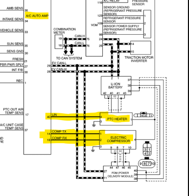

I run leaf compressor. It need only one frame to run ID 0x3b 0xb3, 0x05, 0x00, 0x90, 0xff, 0x00, 0x00, 0x00
0 and 1 bit - AC power
I dont revers what compressor answer. I think that must be information about RPM, voltage, current.

Re: Nissan Leaf A/C compressor 92600-3NF0A
It sounds like you need to send frame ID 0x3b then fill the data frame with
LIN is funky if youre used to CAN. its a master/slave setup. The more PC way to phrase that and according to recent standards is Commander/Responder.
Anyhow. The Master has a schedule table that sends out the frame IDs periodically. Just the frame ID thats it! then the other devices will fill the data portion of the frame they are programmed to publish. Typically the master will send the frame ID for the command message will respond to itself with the commanded value(compressor set speed) and then the slave devices listen to that response and implement it. this is what prevents collisions. Then the master will publish the Frame ID for the slave to fill with the response message (measured speed/status) there is no back and forth communication.
so, you would send Frame ID 0X3B then respond to it with 0xb3, 0x05, 0x00, 0x90, 0xff, 0x00, 0x00, 0x00 as the data portion of frame 0X3B this is the command message to that the ac compressor is programmed to listen to. I imagine there that data includes an ON/Off request and a speed command. you would then need to send the Frame ID for the compressor status the compressor would see that ID and fill the data bytes with relevant info.

Hello all, I was able to write some code for my Arduino Mega to use UART to mimic LIN, and the compressor ran directly from the microcontroller. Although I tried to directly use frame address 0x3B, the compressor didn't seem to run. Once I added the two parity bits (Bits 6 and 7 of the frame signal, each with value of 1), the "Protected Identifier" (frame address of 6 bits plus parity of 2 bits) becomes 0xFB. This is documented in LIN Specification 2.2A. Using the protected idenitifier of 0xFB allowed the compressor to run from the Arduino Mega. I think my LIN Analyzer software was automatically doing this, and I didn't figure it out until I reread the LIN Specification 2.2A. If anyone wants to see my simple code for the Arduino Mega, I'd be happy to post it.
Thank you again to all on this thread for hacking this compressor! I couldn't have done it without you.
Thank you for the Saleae logic idea, it worked great. I was able to confirm the frame address I was sending (previously I only had my oscilloscope, and it does not have a logic analyzer built-in). Both your comments were helpful to me, so thanks again.
