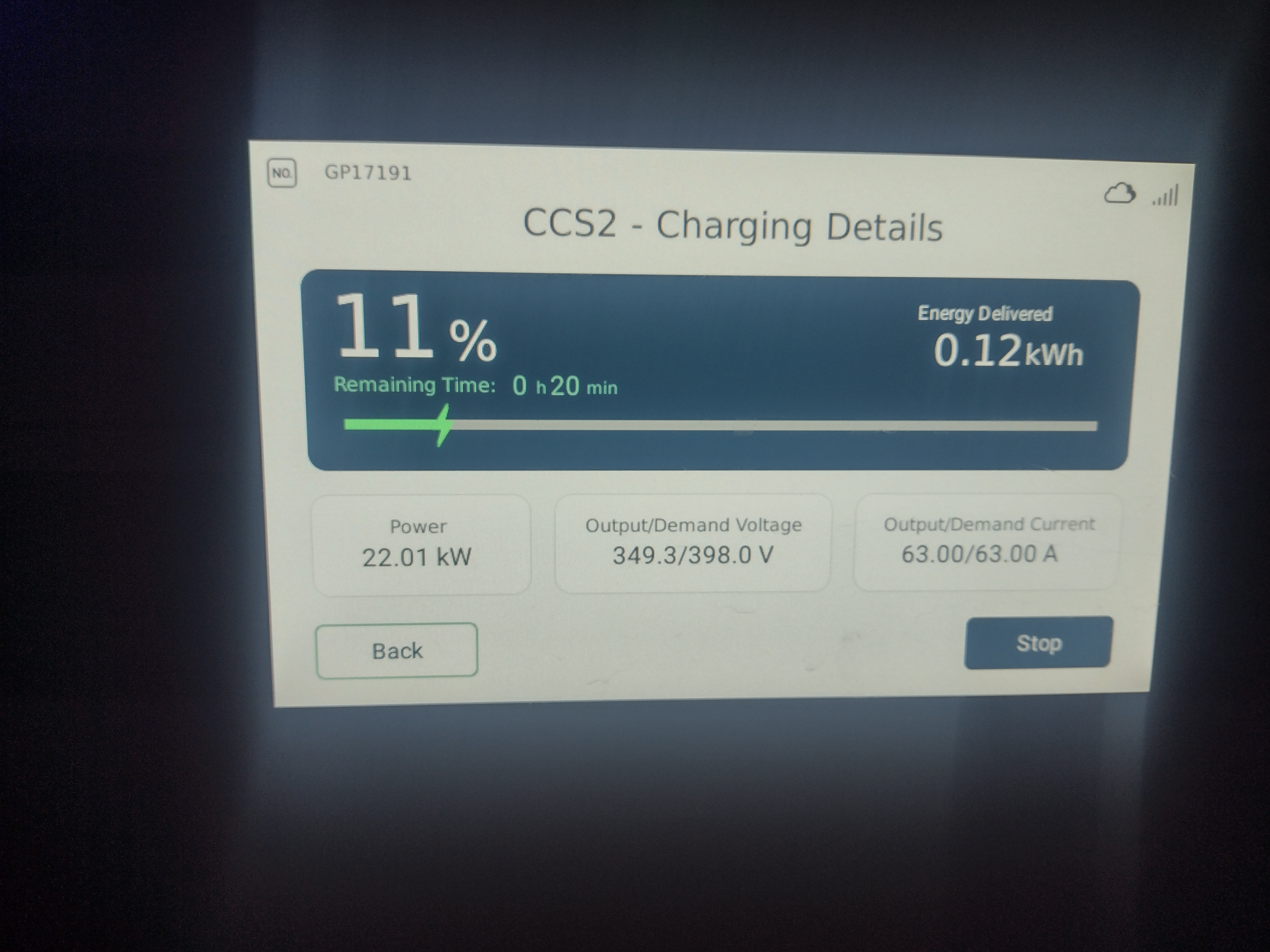

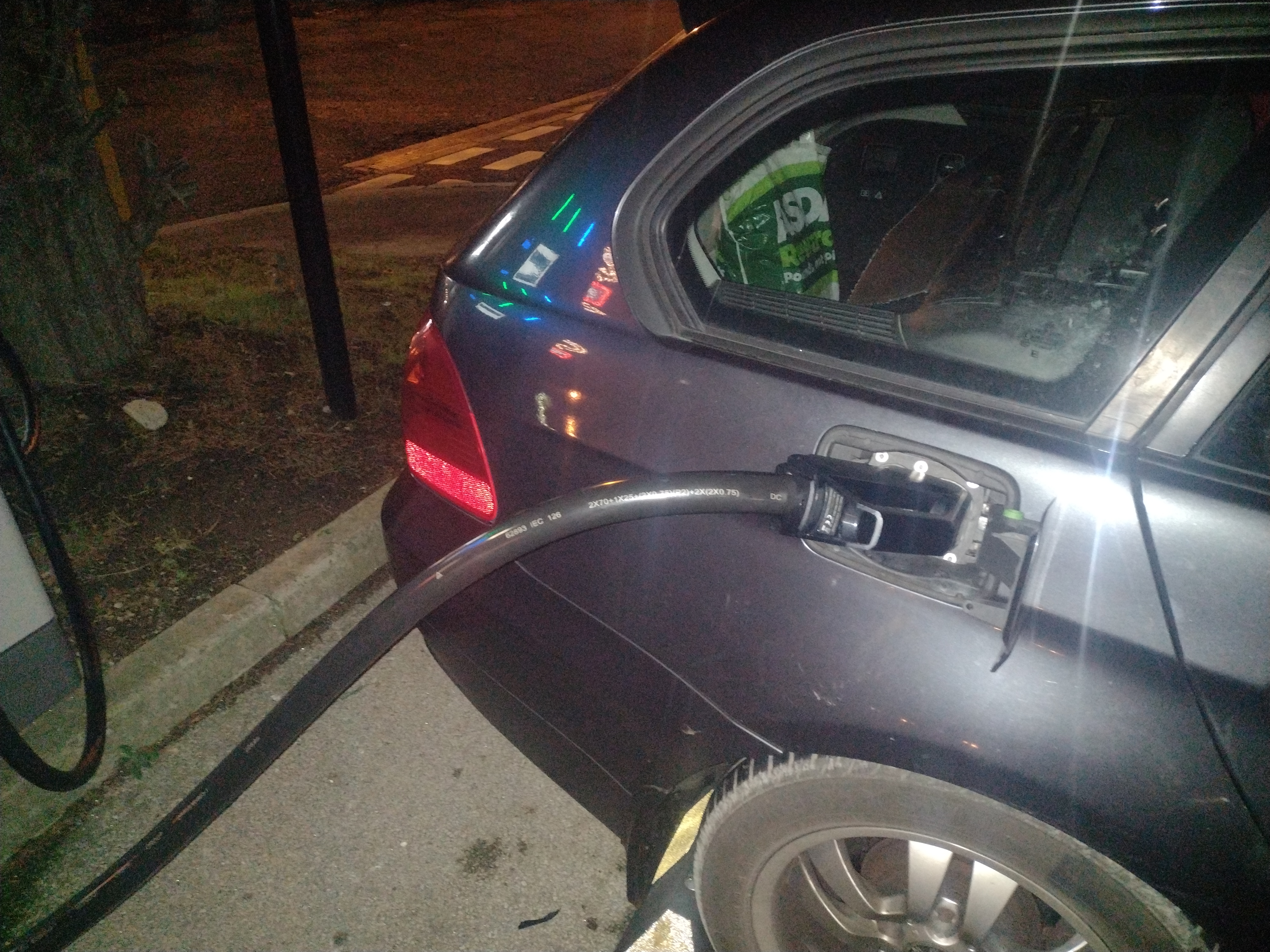

I've now got CCS charging with FOCCCI on the BMW (viewtopic.php?p=78345#p78345) but it uses the max charge rate from the BMS, which is pretty slow as the Kangoo ZE never had rapid charging.
As you can see at: 11% SoC the max charge rate is 63A battery was at 14 degrees C.

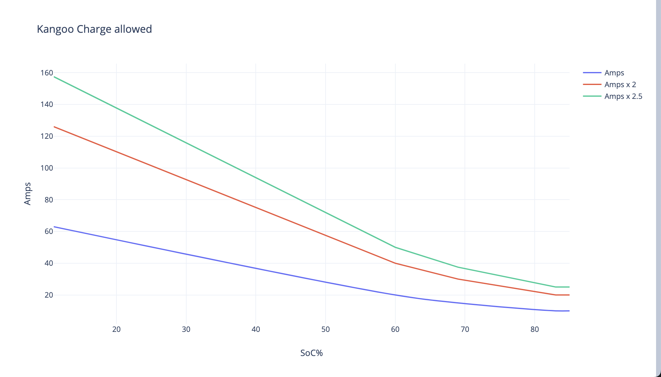

So I put it on charge (3kW) and took a look at the derating:
11% -> 63A
60% -> 20A
69% -> 15A
83% -> 10A
Batteries at min: 12oC max: 15oC
I'm thinking I want to implement my own offset to raise this, based on temperature, so maybe if min cell over 10 and max cell under 30 and charge limit > 10 then either 2 or 2.5 multiplier.
What's peoples thoughts on this? Should temperature have some affect on the multiplier?

Re: [Driving] BMW E91 320d 2006
Yes it should. All OEMs derate at low and high temp. I tried to replicate what VW does:
https://github.com/jsphuebner/stm32-car ... mebbms.cpp
Posts: 1845
Has thanked: 89 times
Been thanked: 481 times
Yes, I was thinking of sticking to the BMS limits outside of a specific temperature range. Within 10 to 30 degrees just multiply by 2.5 the BMS given limit.
Or.do you think that I should also modify the multiplier within this range also, based on temperature?

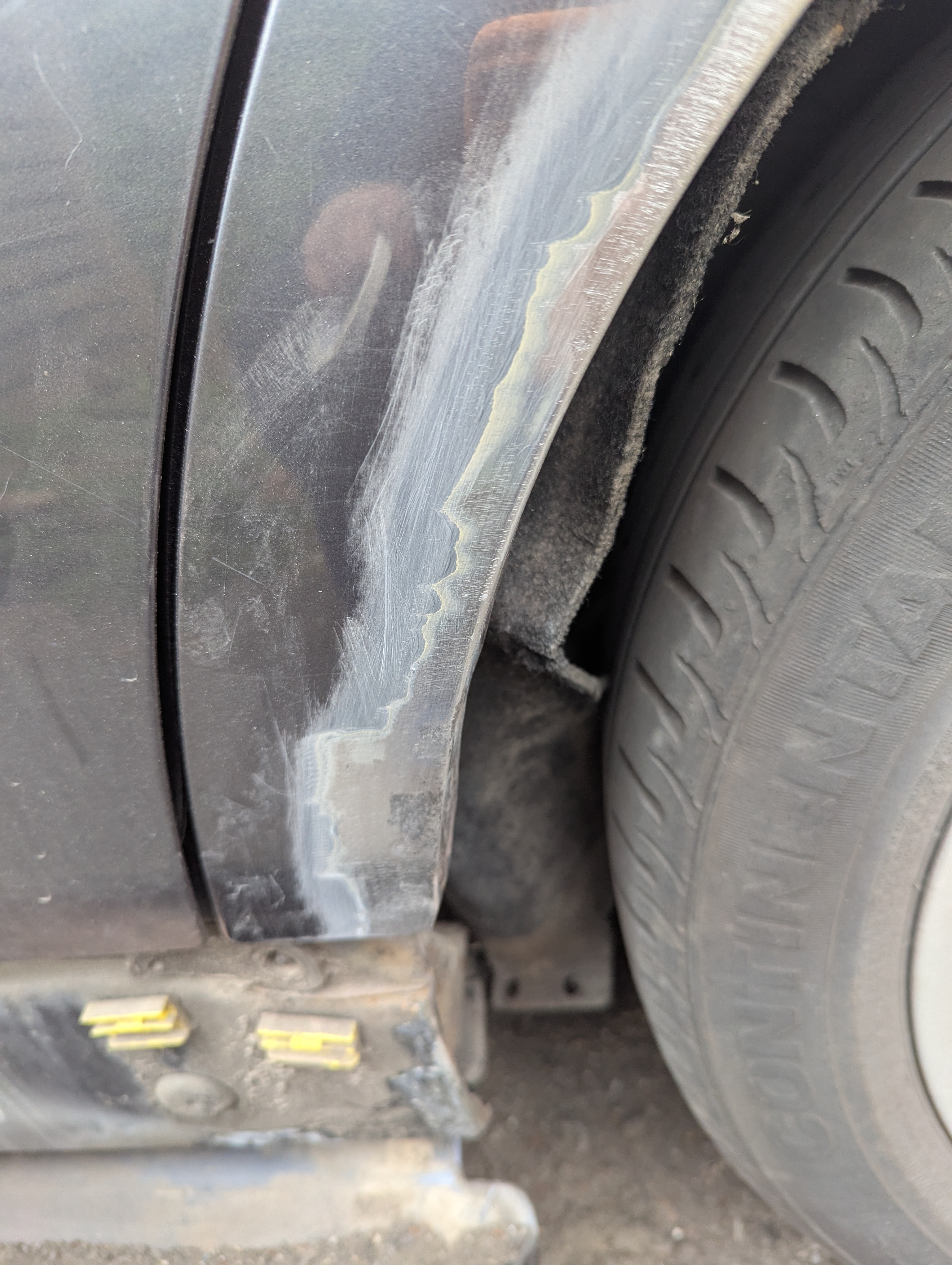

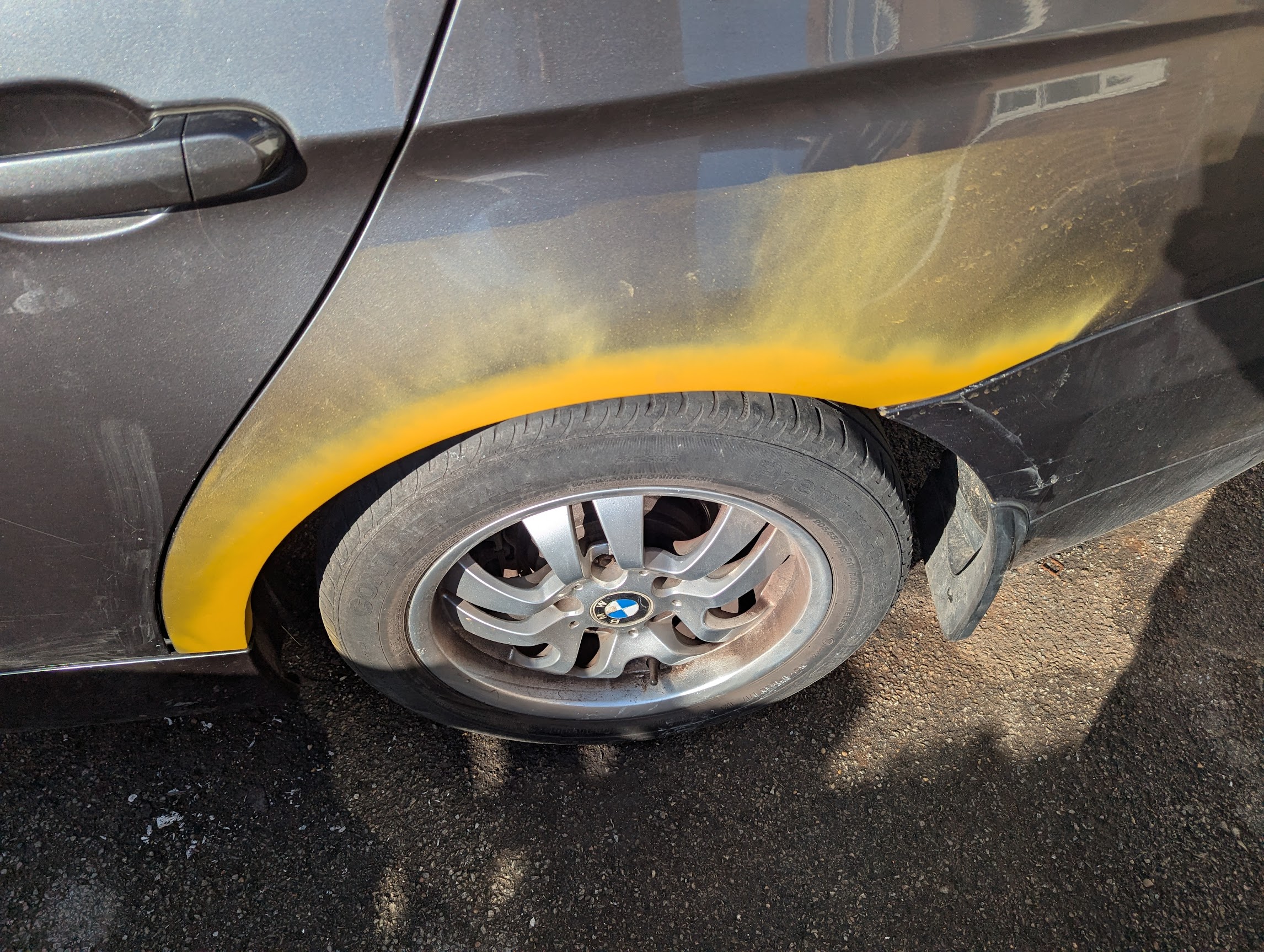

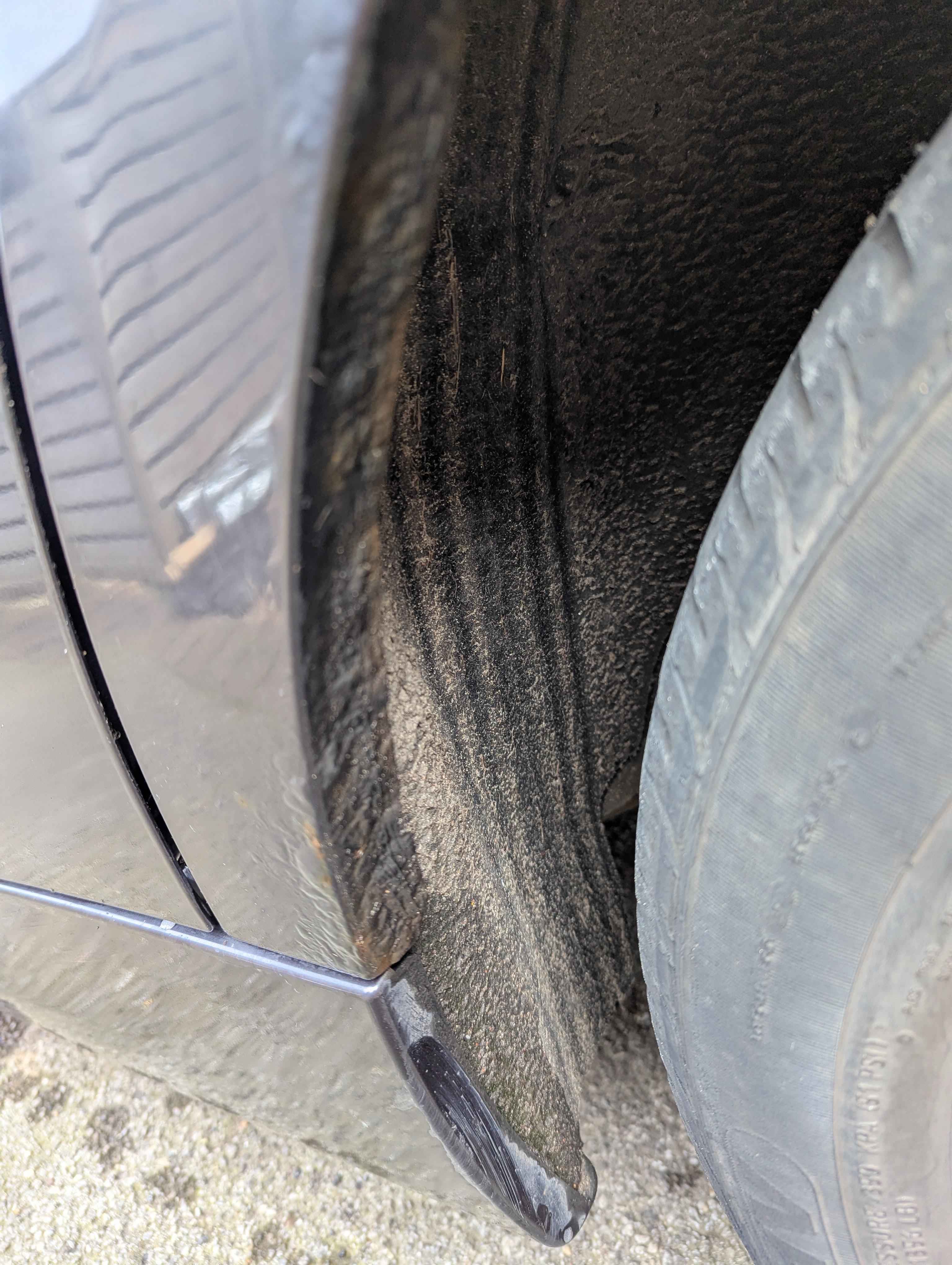

Posts: 1845

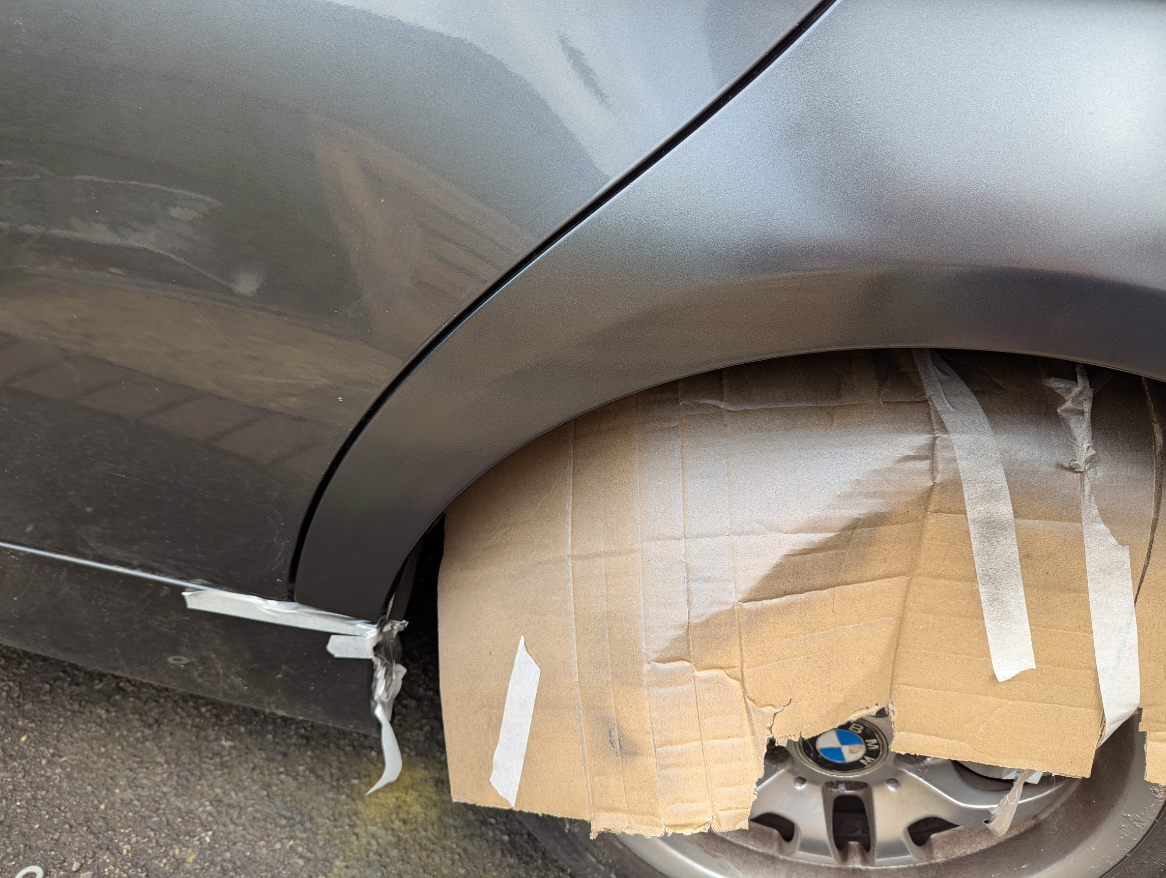

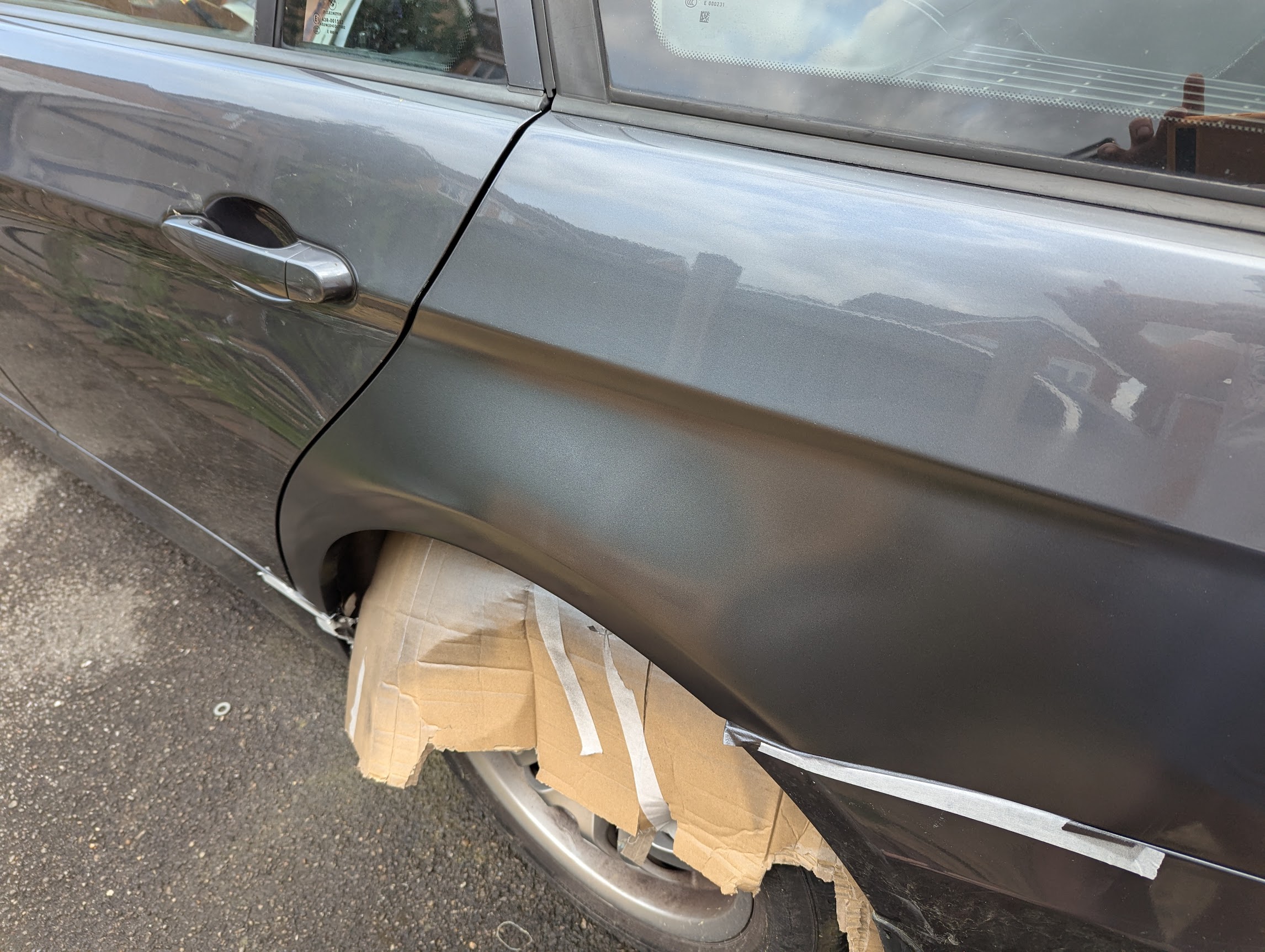

So, the first year is almost over and renewal time for the insurance, looks likes it's going to be £1000 again.
Over last few days I've been tackling the rust on one of the rear arches.
Thankfully it was just surface rust.
Not perfect, but a lot better.
