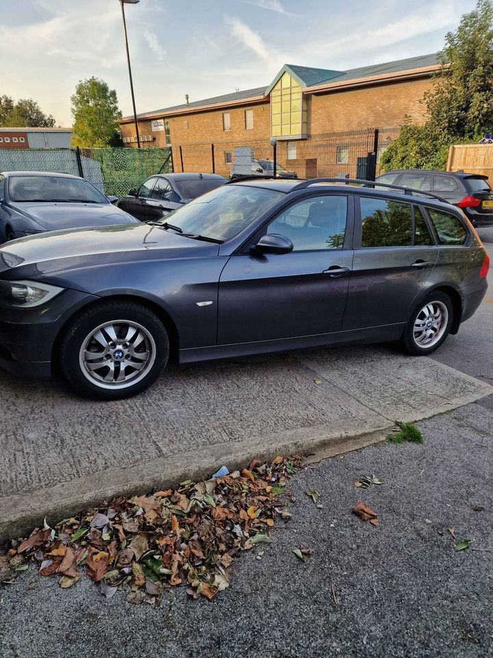

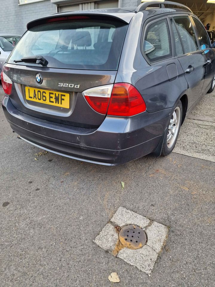

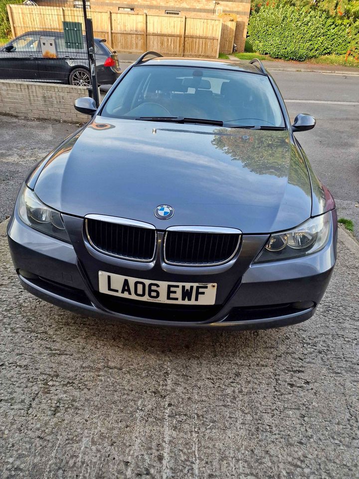

Found this for sale on Facebook with a very blown head gasket for £450 so conversion number 2 will begin. It'll be a GS450h, Zombie, Outlander Charger / Heater / AC compressor. Will have a UHI based CCS.

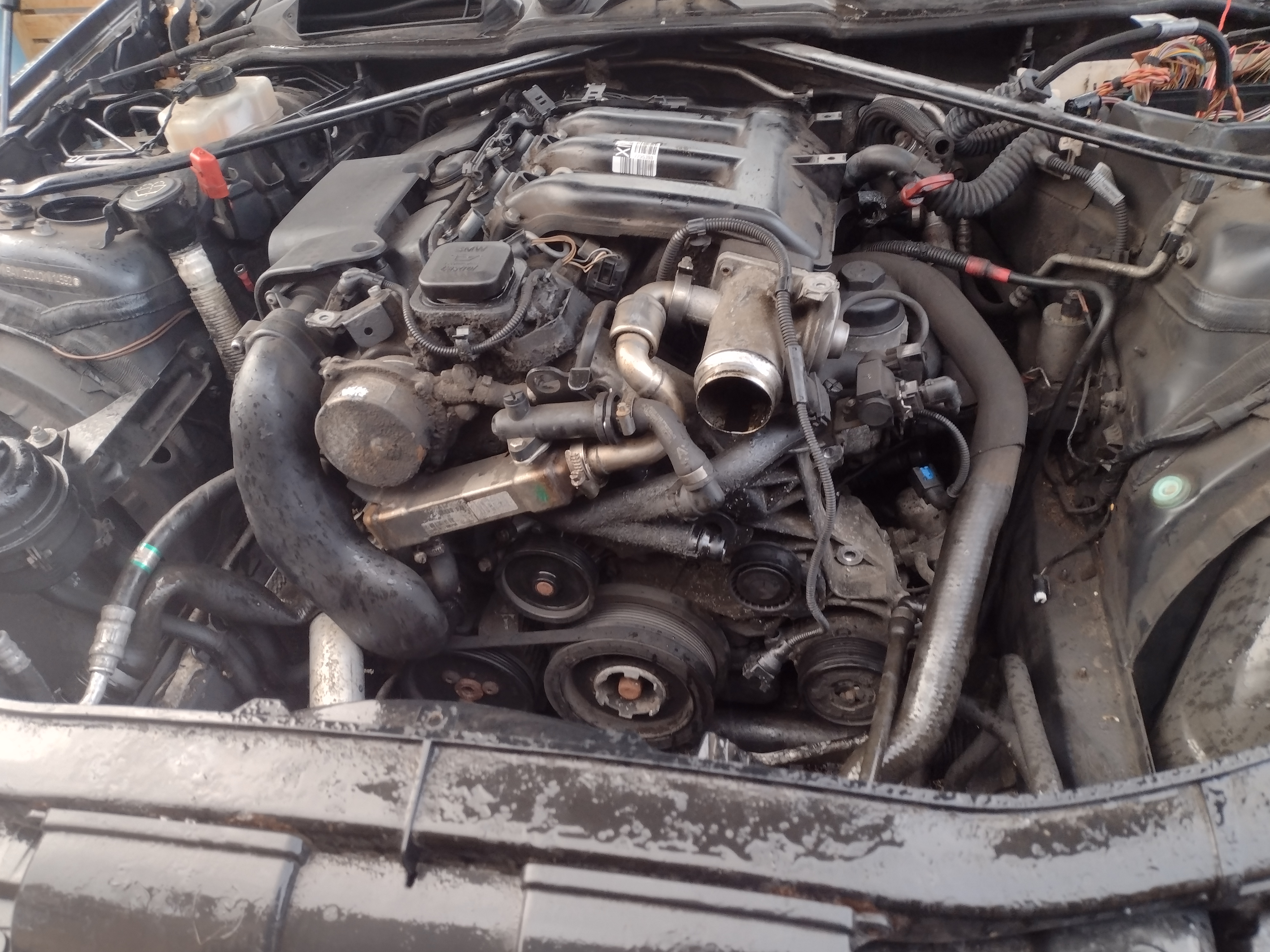

Re: [WIP] BMW E91 320d 2006

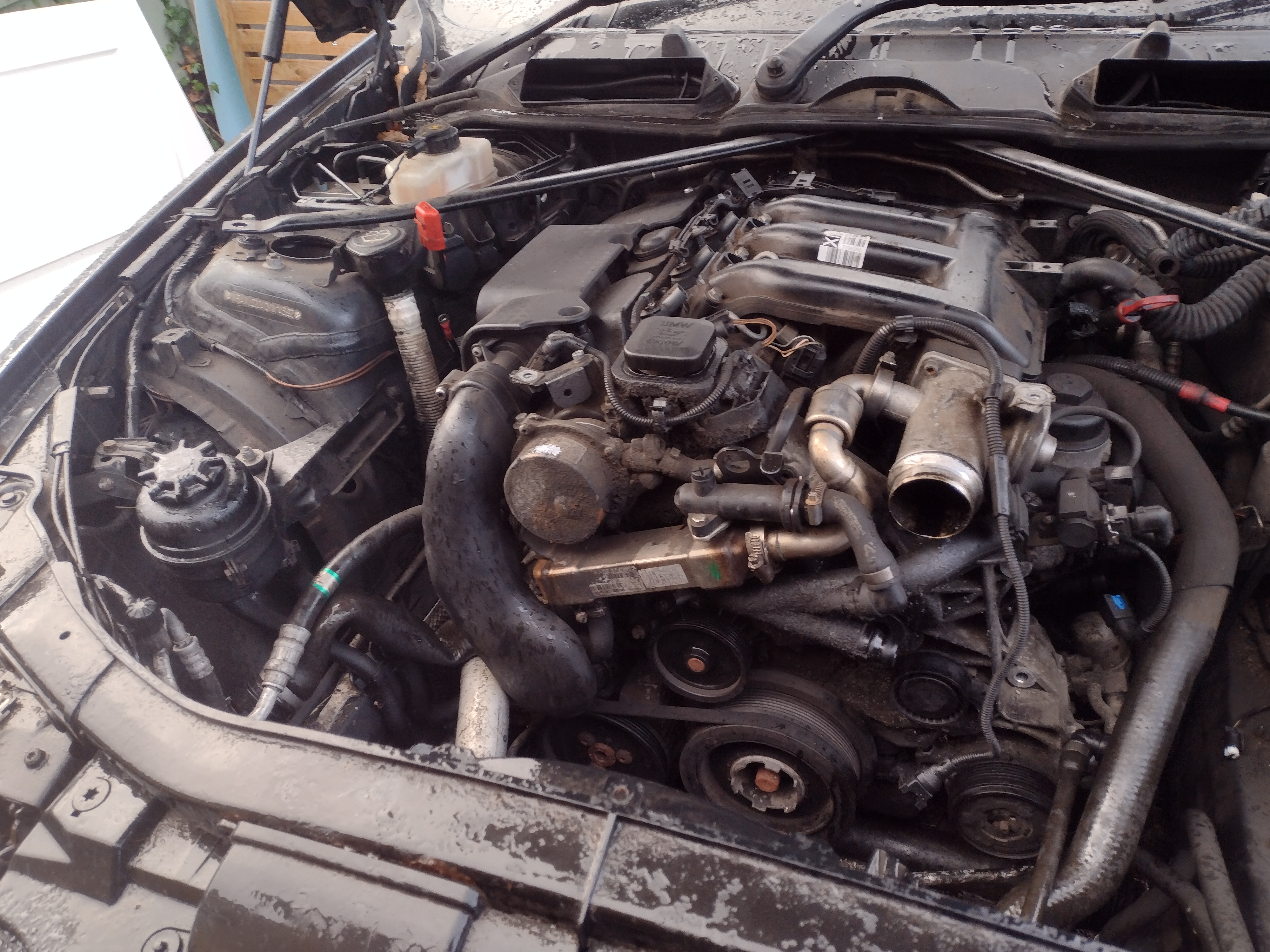

I taken can logs of the PT can from the DDE (BMW speak for ECU) https://github.com/jamiejones85/E91-320d-canlogs I think I'll take a few more logs, car in reverse, AC on, traction control off etc just to be sure I've got enough, then get the AC dude round to drain me (for the environmental and legal reasons) and begin ripping out the lump
- andybpowell
- Posts: 334
- Location: Southend,essex,uk
- Has thanked: 219 times
- Been thanked: 257 times
good to see one of us taking can logs before taking it apart completly forgot with mine had to beg borrow and steal

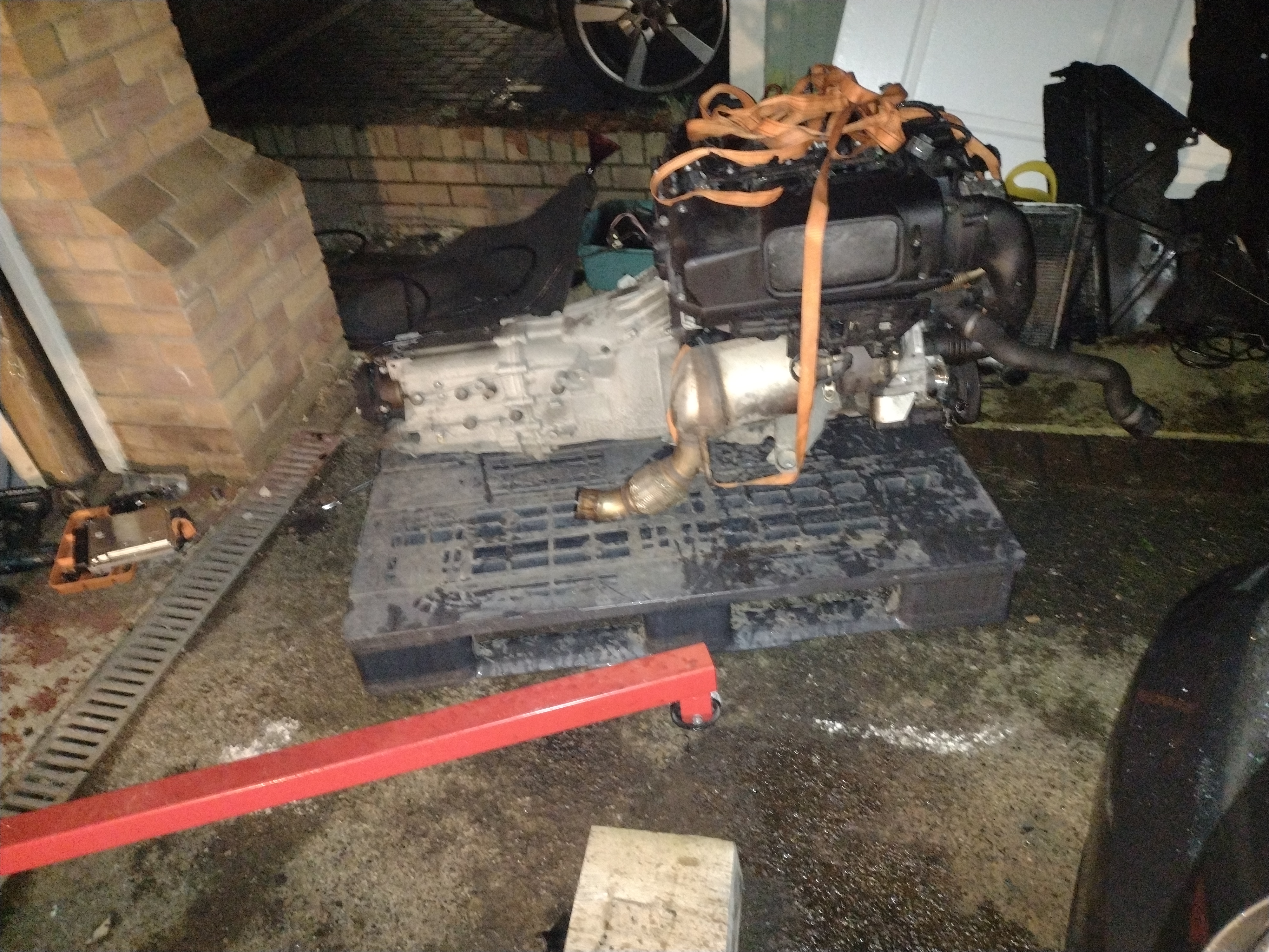

Started disconnecting the coolant hoses and wiring. Compressor now unbolted so that's not holding me up, but the AC people coming Monday to evacuate anyway.
King Kong has put the wheel bolts in, my impact gun will not loosen them so can't get the front bumper off easily. So tomorrow, I'm going to try drop the gearbox off and get that out of the way before going round to my mates and taking his engine crane for a walk round to mine.

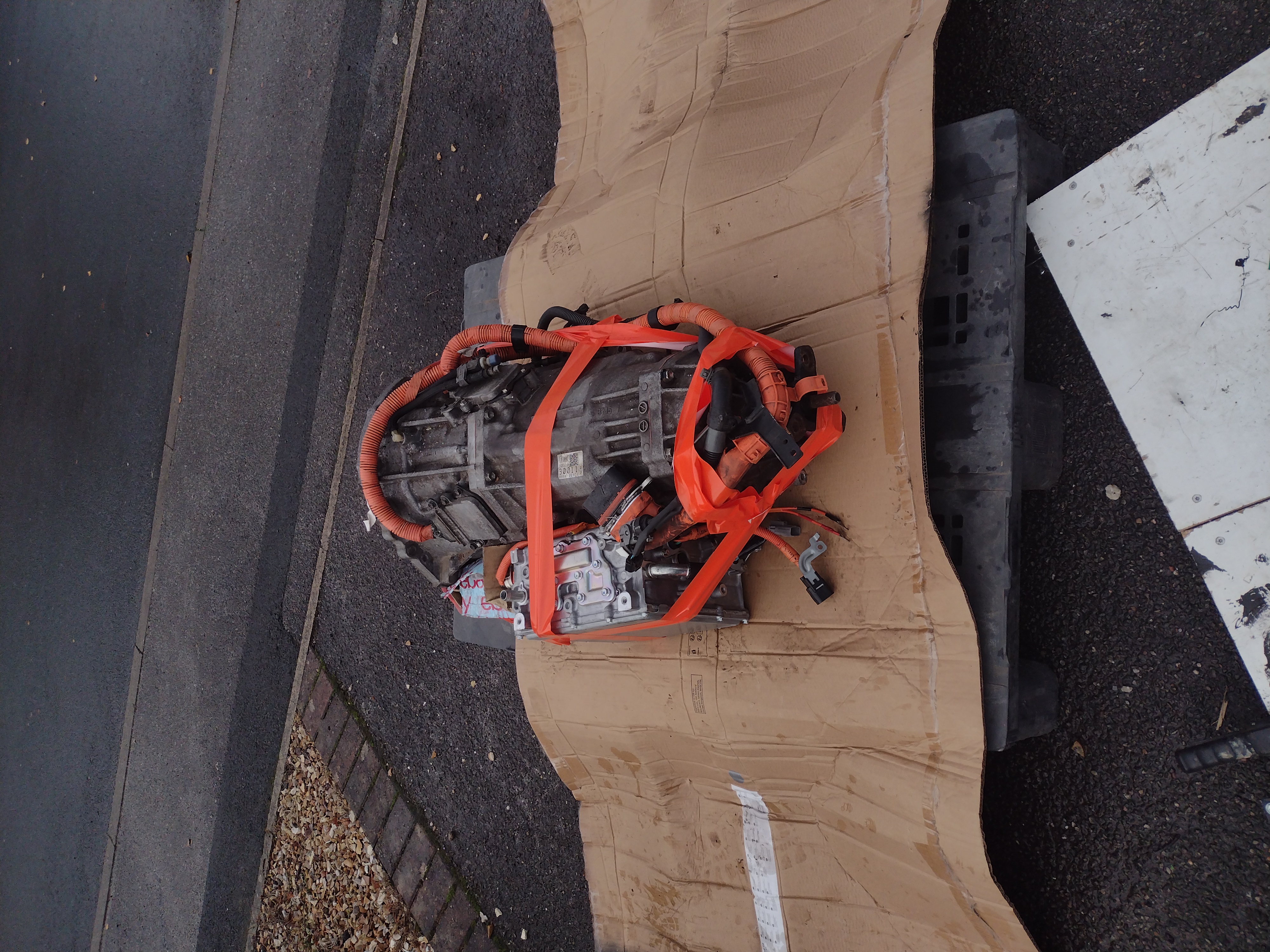

Engine still not out yet, but only needs lifting out now, all stuff disconnected. My GS450h gearbox here now. Still need to source an inverter. Sellers asking too much on eBay for them.

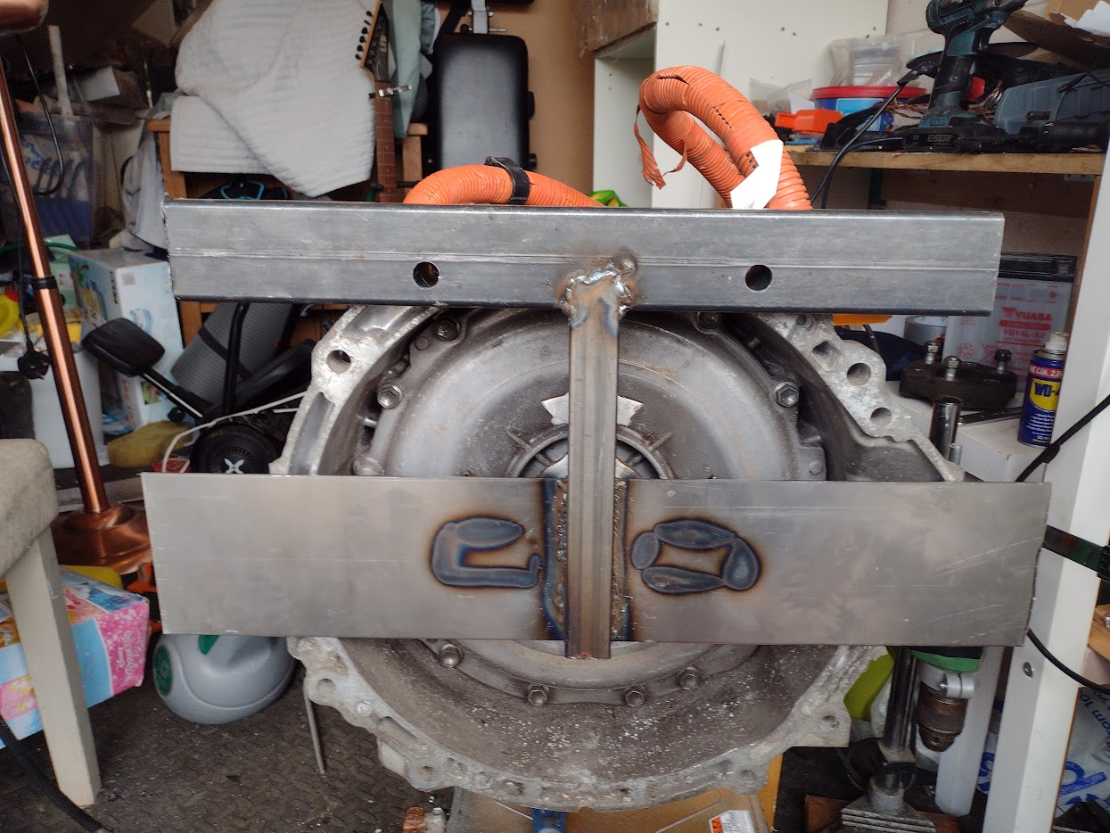

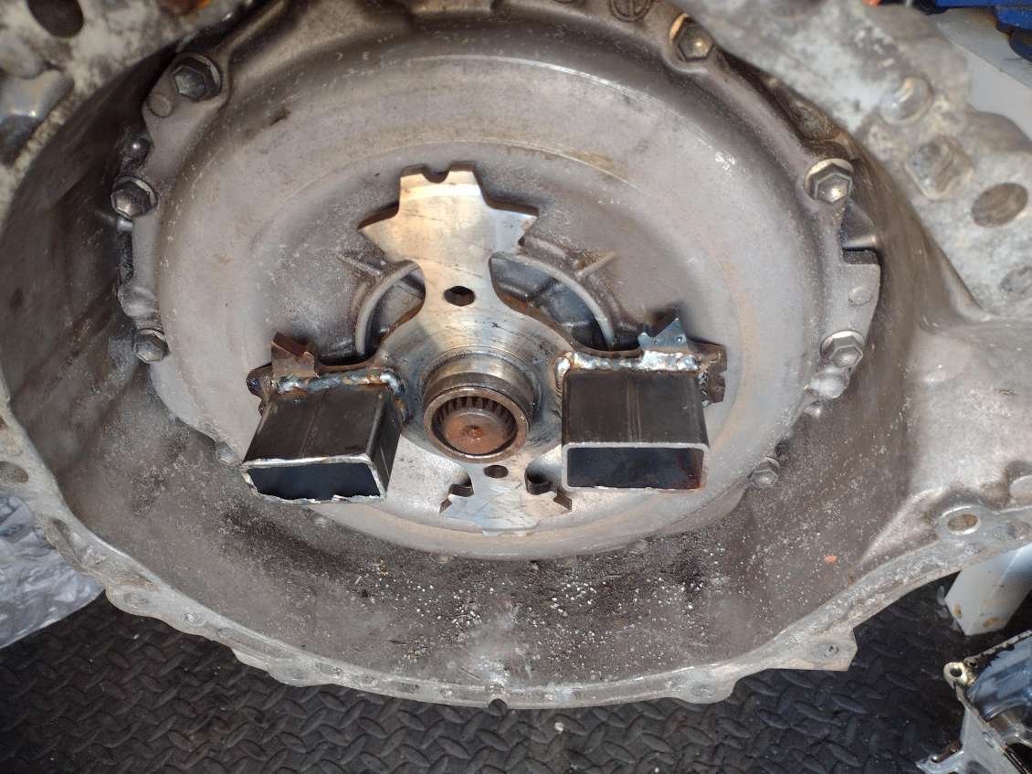

A spot of lunchtime welding, working on locking my shaft
- Posts: 1884
- Has thanked: 91 times
- Been thanked: 517 times

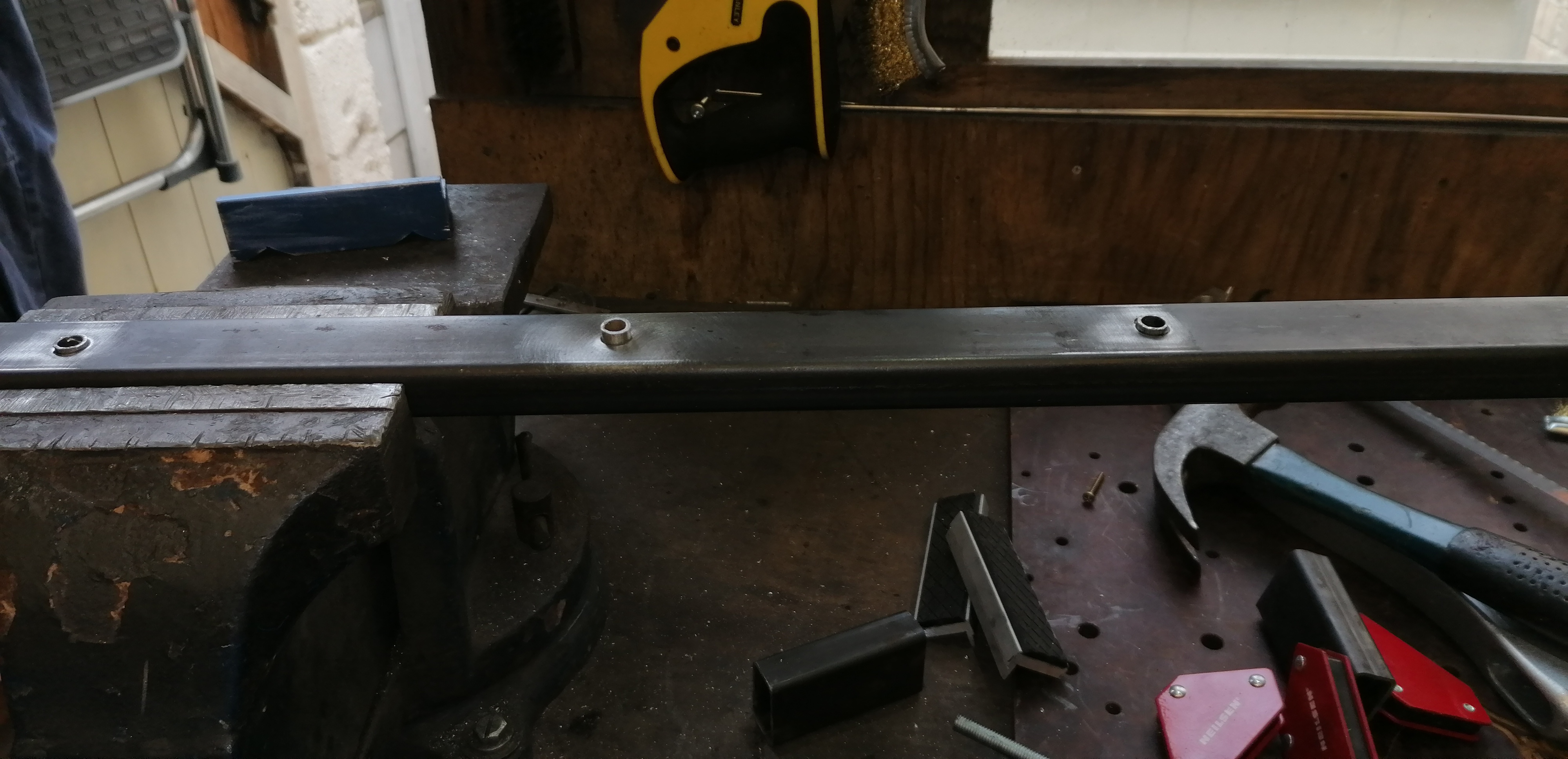

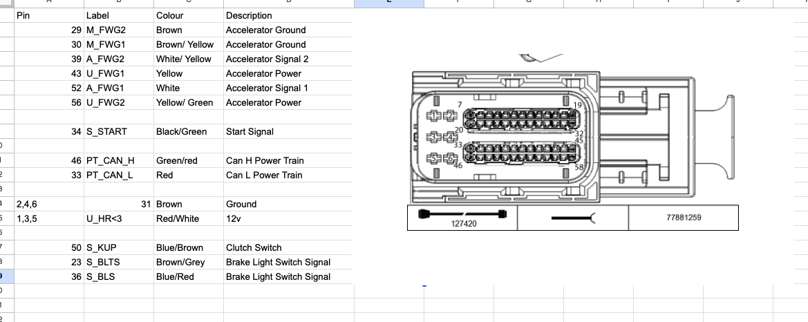

Bit more work on the input shaft lock and also just getting the wiring information together.
- andybpowell
- Posts: 334
the only issue with bolting through box section is it has a tendency to crush down over time and the bolts will become loose so I tend to drill the hole bigger and weld in steel tube then grind it flush to prevent this
- Posts: 1884
That's a good idea.

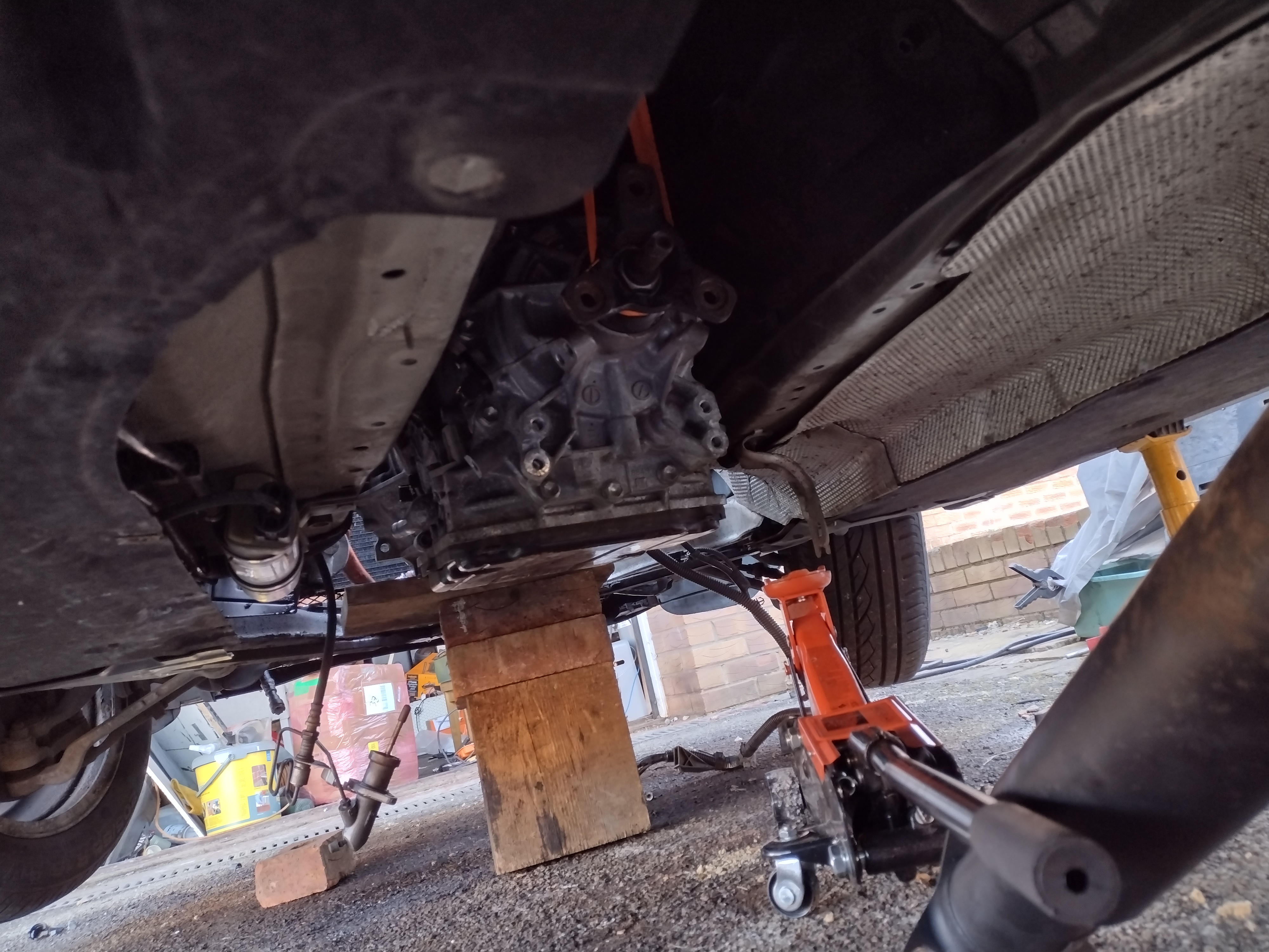

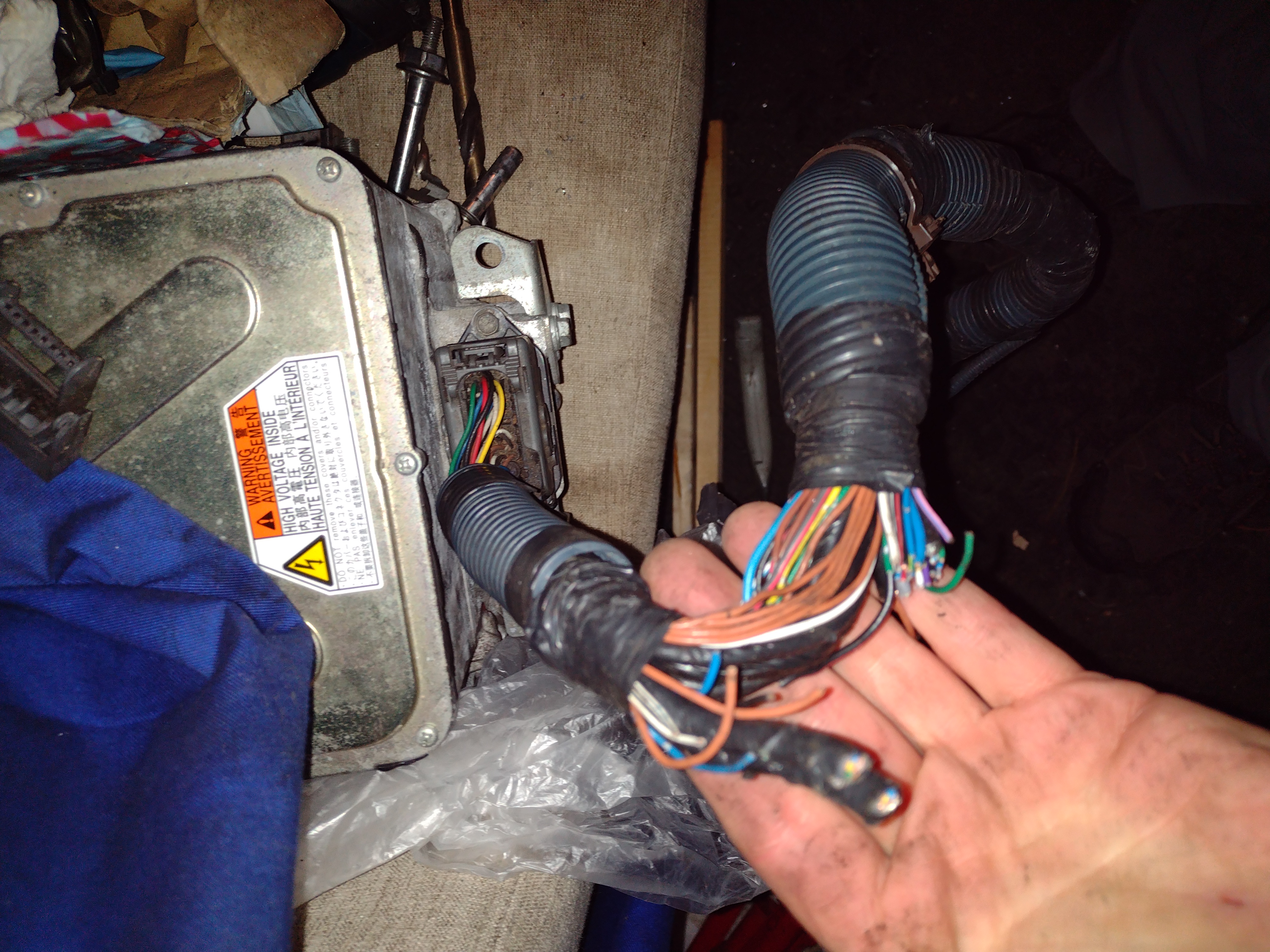

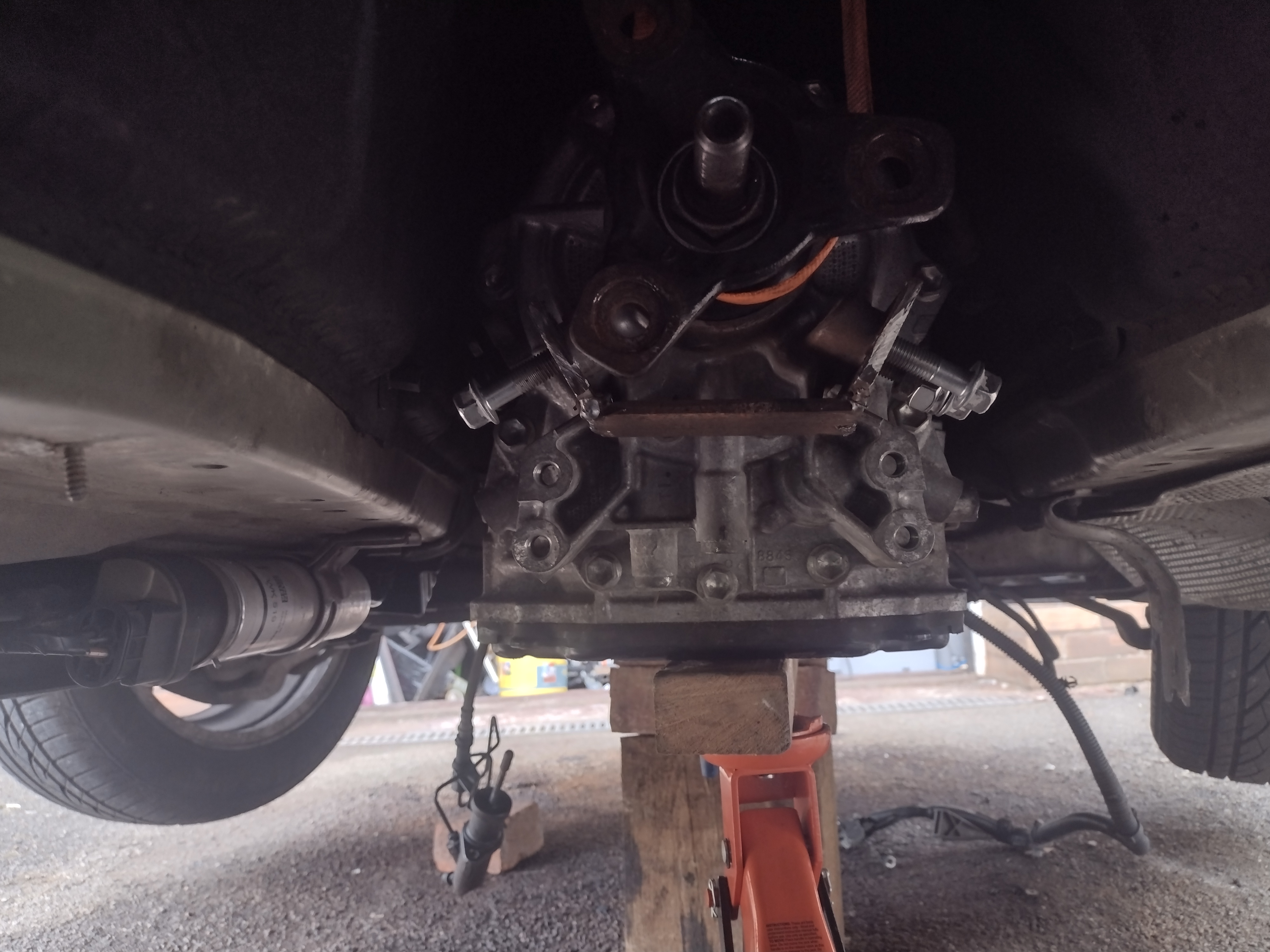

Got the gearbox sort of positioned on bricks. Need to tweak the angles and spacing a little then start on making up some mountings.
Also managed to get hold of a butchered loom from ebay cheap that includes the unobtainable connector.
My GS450H gearbox is arriving on Monday... I'm a little apprehensive about moving it around tbh. Just picked up a massive engine stand for cheap but I've still got to get the bloody think onto it... Any tips?
- Posts: 1884
Lift with your legs not your back. It's heavy AF, get help if you can. I can just about move.ot on my own but it's not fun nor easy.

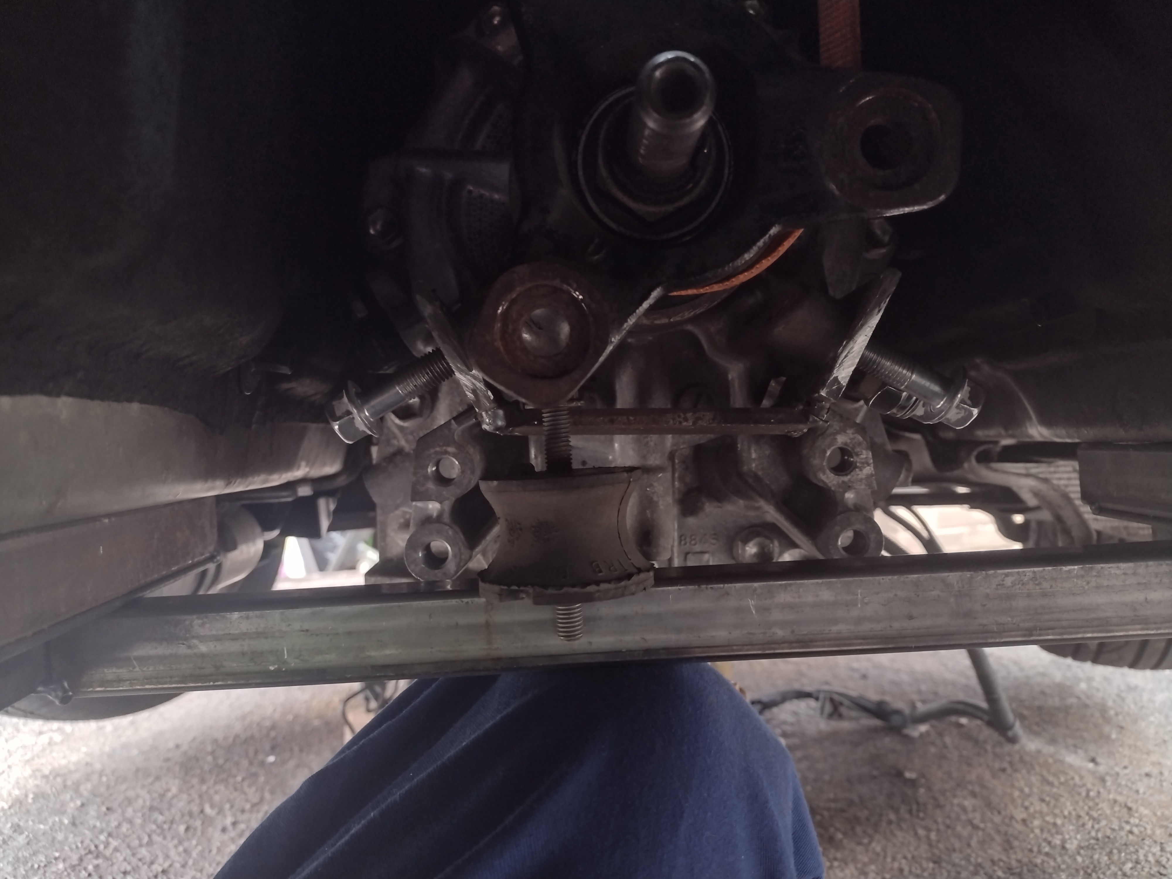

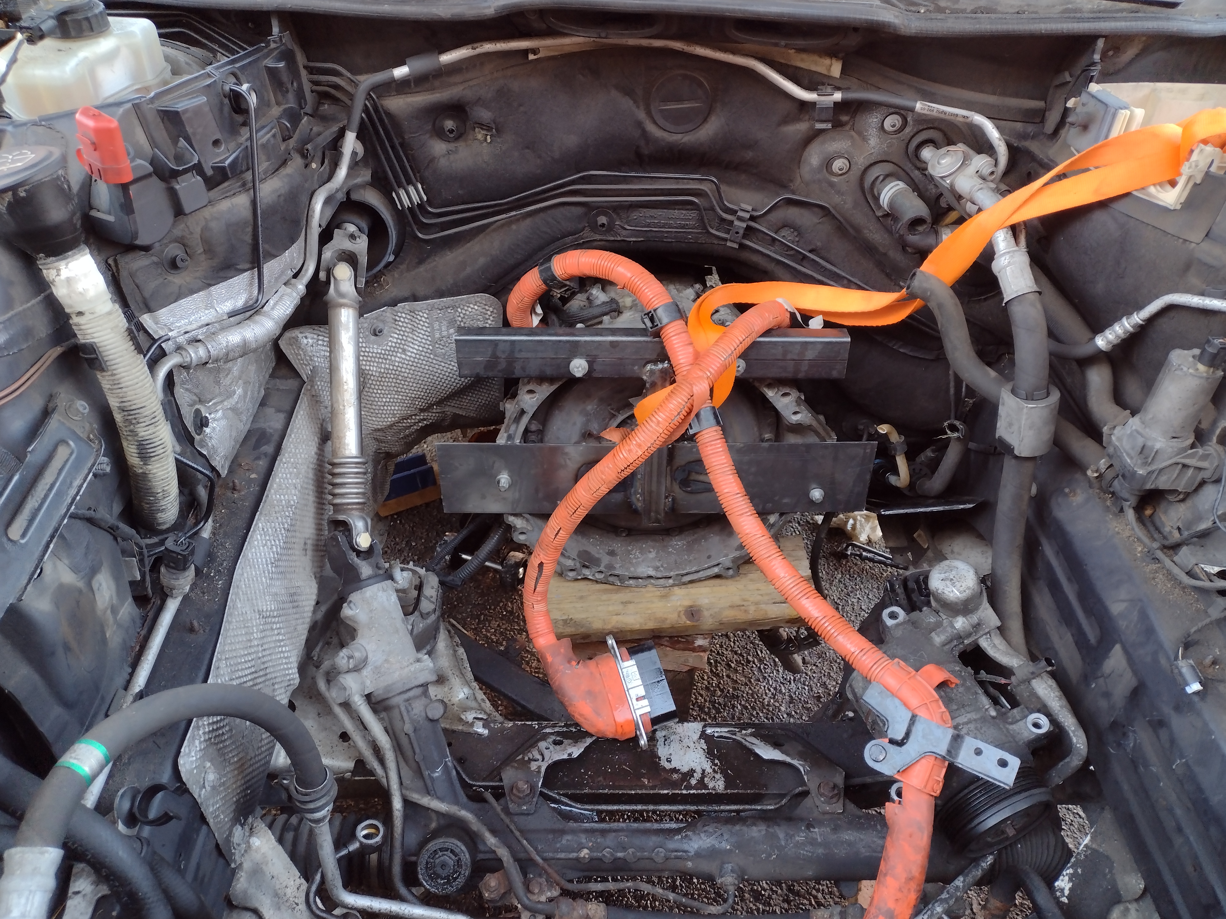

Still working on the rear mount, taking ages.
Transmission isn't quite level on the jack, also need to adjust the height a little before getting the brackets for the rubber thingies made up and then adding triangles everywhere possible.
Once it's roughly mounted I can send the propshaft in for surgery, hard to tell if the angles and height is ok will a propshaft that's too long and wrong flange.
- andybpowell
- Posts: 334
I made up a tube with the right ID to go over the gearbox output shaft and the right length to ensure the correct gearbox position and that it aligned with the spline of the rear half of the propshaft, rubber couplings and UJ's can only compensate for limited alignment errorsBigpie wrote: ↑Thu Nov 16, 2023 1:31 pm Still working on the rear mount, taking ages.
