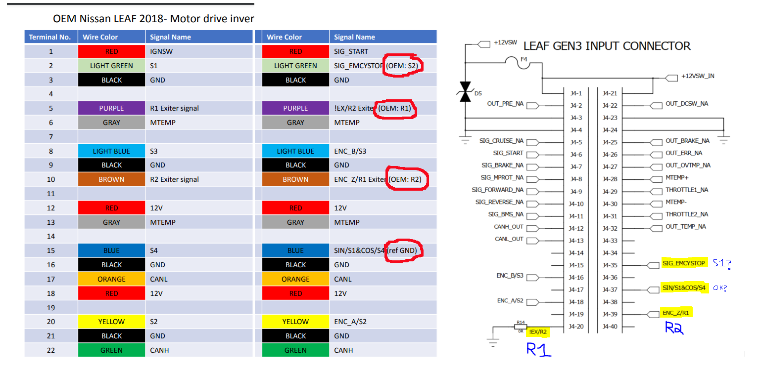

I attached a pdf of the schematic if anyone is willing to look at it.
I decided to link the voltage divider to 5v for addressing. Thanks for mentioning 5V johu. I'm not sure all adapter / OpenInverter boards have 3.3v on them.
Info:
  • I used 0805 sized components. I prefer to not hand solder anything smaller.
  • I picked 4.7K for this board address (R18.) Next to R18 are 2 vias (blue lines) to pop R18 off and experiment with different resistor values if needed. You wouldn't do this normally, just for assigning & testing addresses for different boards and measuring what the brake circuitry does to it. The vias leave nice spots to check the address voltage.
  • SJ4 is a shorted solder jumper that connects JP2, pin 18 (MISO / OUT_BRAKE) to the Nissan connector labeled here as OUT_BRAKE (not sure what Nissan calls it.) If the addressing works out it will be MISO / OUT_BRAKE / ADDRESS. This can be cut for testing if needed.
  • D11 I'll call the oops diode. If someone forgets to put a pull down resistor in and has R15 in place it pulls R15 down to around 3.3v.
  • 5V is there to remind people that this is a 5V divider, not a 3.3V as they would maybe expect for a STM32.
  • Added pull downs for the Pre and DCDC contactor mosfets, 10K, R7 & R8.
  • added a SMB TVS diode (D1 & D2) across the source / drain in case the diode in the mosfet can't take the flyback hit from a contactor releasing. Its a unidirectional 18v. johu mentioned some diodes can reverse power the board on some installs, should this go to a bidirectional 18v TVS? Currently LCSC C80394
  • T_SINK got a 3.3k pull down, mentioned in johu's notes getting the previous to me version of this running. Not sure if this needs to be optimized.
  • R24 is in the datasheet for the ESP32 (inline in USART_RX.) Says it suppresses 80MHz harmonics.
  • QR code goes to the Gen 3 board wiki page (parked for now.) Hopefully this will help eliminate some questions once people get them in their hands.
  • SJ1 & SJ2 are solder jumpers to enable a 120 ohm CAN resistor. Its technically 2x 60ohm resistors in series with a capacitor in the middle to ground to filter noise. Can be soldered / enabled if this is an end of the CAN bus. There is ESD protection inline right at the Nissan connector for the CAN lines (D6) just in case.
There are a few things I'm unsure of:
  • J4 is the ESP32 programming header. This connects to 5V instead of 3.3v as I'd expect. I copied from the updated (V6 & V8) Tesla boards - I assume those are correct but not sure why.
  • J3, J5, and J6 are there to allow easy break out of these different dead ends in case someone wants to use them. J5 I setup to a typical 2x03 programming header pin out, not sure that will work with other stuff going on. If this is a bad idea let me know and I'll rearrange it.
  • The inductor footprints around the outside will be unpopulated. There is a ground shield plane that connects to the mounting holes on the bottom. There's a ring around the outside edges on all layers up to the top. These inductors footprints would connect the 2 planes if needed, and could be capacitors if that worked better.
  • OUT_OVTMP on J6 seems to be a Nissan thing. Not sure if anyone uses this. If anyone knows a use / where it should connect please share.
  • OUT_TEMP on J6 seems to be a Nissan thing. Not sure if anyone uses this. If anyone knows a use / where it should connect please share.
  • CS_ADC / AKA OUT_OUVTG Isn't connected anywhere. Not sure if it should be or where / how. Couldn't find info on it. For SPI, not needed for this Nissan inverter (johu's previous post.)
  • R2 isn't connected, not sure it's needed.
  • IL1 & IL2 are connected to 2 terminals each. This seems wrong. Might be one of each needs ground or? Unfortunately the original Nissan board has almost all the connector traces under the connector bodies for our inconvenience.
  • There are a few 0R / jumper resistors in these unknown connections to allow pulling the resistor then connecting a bodge wire if needed.
  • Not sure the Nissan connector's mechanical pins matter if they connect to ground or not. Connecting to ground helped the ground plane flow so its setup that way for now. I'm assuming they don't really go anywhere and just hold the plastic of the connector. Would be great if someone could confirm.
  • Need to confirm the Nissan connector footprints are correct. The pads are long by around 4mm to help with hand soldering.
  • Boot delay for the ESP32 is 1uF (C13) / 10K (R25.) Its the typical values in the datasheet. The Tesla boards use different values, not sure if it matters.
  • C3 & C4 are currently 100nF to debounce the contactor outputs. There was mention of contators chattering or pulsing at power up, not sure if this was resolved. Either way these should help eliminate contactor chatter (if sized right..) These can be adjusted if needed. Left room around them and did a small keepout area for the ground plane to help swapping them if needed.
*edit* clarified the bottom ground plane info. Also I moved the Q1 and Q2 gate traces to the signal layer to allow better ground plane flow around the contactor mosfets.
Gen 3 Leaf Adapter.pdf
(160.11 KiB) Downloaded 785 times

Thank you very much for your hard work.
I looked through the schematic, only thing that popped up was the pull-up of mprot. That should be hard wired to 12V without the 4k7 resistor because there is one on board already.
Yes perfect as it is. Reverse powering only happens with a regular diode with cathode tied to 12V.
Not sure why I picked 3k3 there, probably had one handy. "Standard" is 1k2. Still need to map out the sensor.
Most USB uart adapters have a 5V outlet but no 3V3
That's just general purpose outputs of all OI boards but I think they are not brought out to the round connector anyway. If exported the should go through a similar circuitry as the other outputs, maybe with smaller FETs 2N7002 or so.
With the older mainboard R2 was GND. Now it needs to be connected to R2 of the main board (pin 20 of J2 presumably)
It seems to be some automotive standard that current sensors have redundant outputs. I was never sure how to make use of these so one pair remains disconnected
They are indeed plainly mechanical and can be connected to anything

johu wrote: Thu Oct 05, 2023 1:10 pm Thank you very much for your hard work.
I'm happy to contribute. Thanks for helping make all of this possible and thanks for your patience with my million questions.
I removed the 4K7 and wired it straight to 12v but something seems off here.
On the mini mainboard 12v goes through a voltage divider and connects to PA3 / pin 17 of STM32. It does not go to either 20 pos. headers though so the STM32 has no feedback on this line from the adapter board, seems like its just an override on the mini mainboard.
On the Nissan 40 pos. connector this is the wiring that jumps out of the inverter box. Seems like this is not required / maybe mixed up with the original mainboard functions? (or I'm missing something..) I'd rather not output 12v through the pc board back out the inverter connector unless it's necessary.
I added a reminder note in the schematic to verify it. Its the annoying one that's going off the page in the pdf. Was this post that mentioned it, viewtopic.php?p=23175&hilit=3k3#p23175
..OUT_OVTMP & OUT_TEMP..
These are currently only labeled on the 40 position Nissan connector that I'm seeing.
Pin 32 of the 40 pos. connector is OUT_TEMP.
Pin 27 of the 40 pos. connector is _OUT_OVTMP.
I couldn't find where they would connect on the mini mainboard. Happy to add some small fets for them but not sure what mini mainboard outputs are supposed to drive them.
OUTVTG could be one of these but I have not found any info pointing to that / linking the labels together.
In the same thinking I added 2N7002's with 10k gate pull downs for:
- PWM_USER output (JP2, pos 20) thats going to dead end header J5 pos 8 currently.
- corrected OUT_ERR output (JP2, pos 17) - removed from the dead end header (J5.)
- corrected OUTVTG (AKA CS_ADC - JP2 pos19) and have it going to the dead end header (J5) after the fet.
- - Should any of these get solder jumpers that can be cut?
I think I see this now. Pin 20 of the Nissan 40 pos. connector is labeled as R2 but goes to GND in Kelju's previous work. I removed that 0R to GND and connected it to JP1, pos. 12 / R2.
I wonder if this is a connector resistance / connector mechanical failure redundancy? I left one of each with a 0R footprint as DNP, removed the other footprint on each and ran a trace across the missing spots.
I added 2 ceramic 10uF caps at the 4x +5V lines on the Nissan 32 pin connector, they're C5 & C6. I don't think this would be an issue with the 5 volt regulator and should help keep the 5V for different sensors stable / clean. Let me know if those should get swapped / removed.
I attached V0.0.1 schematic pdf. Going with small version #s while we work through this.
Gen 3 Leaf Adapter V0.0.1.pdf
(171.99 KiB) Downloaded 858 times
Updated board image for reference.

Oh yes you're right, they mprot signal just no longer exists. You can omit all components.
I also found the OI pin mapping doesn't quite line up with the OEM pin mapping, for some reason emcystop is connected to resolver S1 (this should connect to mini mainboard S4S1) just like Pin 15. You could also swap R1 and R2 to line up with the OEM board.
I think the traditional output signals won't be used by many. If you prefer you could even omit them for now. I omitted them on the Gen2 board as well. Anyway, OUT_TEMP has been renamed to PWM_USER.
Likewise OUT_BRAKE doesn't make much sense to be exported without a FET. I guess omit it completely on the outside connector.
Caps on 5V should be ok to have.
I wonder should we just add a table with assigned voltage levels/resistor values on the mini mainboard page?

johu wrote: Thu Oct 05, 2023 8:06 pm Oh yes you're right, they mprot signal just no longer exists. You can omit all components.
Ok, I pulled the solder jumper and the connection to 12v. Just leaving a test point to the nissan connector.
Having a hard time following. Do you mean the schematic Kelju started is incorrect? Can you include a marked up picture or Nissan connector # to OI pin so I can follow better?
*edit and does this mean you can swap some pin functions around on the mini mainboard?*
I'll leave them in for now, It will help test these theories as there's time or a user who wants to. Can just leave them unpopulated if decided later.
Anyway, OUT_TEMP has been renamed to PWM_USER. Likewise OUT_BRAKE doesn't make much sense to be exported without a FET. I guess omit it completely on the outside connector.
Thanks. I corrected PWM_USER <-> OUT_TEMP and have it driven by a 2N7002.
I swapped the SJ4 solder jumper to open and connected it to the EXT_BRAKE with a 2N7002 that has a 115ma constant current rating. But that wont drive brake lights by itself or even a relay. Whats the recommended way to use this brake output?
I would love to see a table of pin mapping / info for all of the boards available. Alternative pin labeling should be part of this too I think. This would have helped making this adapter board a bunch. I think part of this table should be voltage level / address. Is there a spot in the wiki that exists already that you think this would fit best?
*edit I saw your mini mainboard info about addressing. Some of the voltages are close together. I think we need to define a target for each (you did already) and a voltage range for each. Likely need to keep these at 1% or better resistors but should define that as well.
I'll change 5v to 5.3v in the voltage divider area.

jrbe wrote: Thu Oct 05, 2023 9:04 pm Having a hard time following. Do you mean the schematic Kelju started is incorrect? Can you include a marked up picture or Nissan connector # to OI pin so I can follow better?
It is somewhat incorrect as he connected emcystop to the resolver. Check the pinout.pdf in the second post to see what I mean.
jrbe wrote: Thu Oct 05, 2023 9:04 pm Thanks. I corrected PWM_USER <-> OUT_TEMP and have it driven by a 2N7002.

johu wrote: Fri Oct 06, 2023 5:44 pm It is somewhat incorrect as he connected emcystop to the resolver. Check the pinout.pdf in the second post to see what I mean.
You mean this? (my quick photoshop)
I missed that wires / pins were repurposed..
  • So from that it looks like R1 & R2 need to swap places (as you mentioned.) I'm broken, I needed the visual.
  • And E-stop needs to be removed. But I'm unsure if S1 / SIN/S1&COS/S4 stays where it is (there's no ground there.) Do S1 & S4 wires connect together for S1 / SIN/S1&COS/S4?
  • On the mini mainboard connector for signal e-stop, that needs 12v, correct? If so, I'll likely add a shorted solder jumper and a via on each side in case someone wants to use it.
Posts: 6969
Has thanked: 455 times
Been thanked: 1771 times
Re: Make Nissan Leaf Gen3 adapter board
jrbe wrote: Fri Oct 06, 2023 6:52 pm
Yes, yes and yes :)
S1 and S4 are connected to the same pin of the mini mainboard but individual pins on Nissans connector
