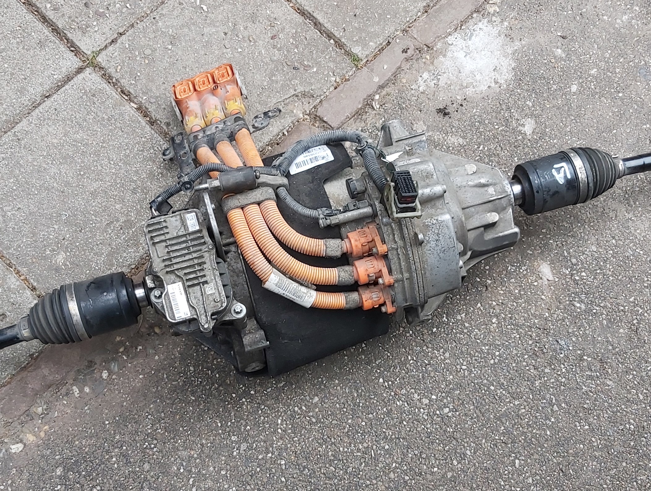

I bought a Volvo motor to connect to the Volvo inverter.
The motor connector looked the same but is was keyed different. Nothing a file can't fix.
Because this is a motor from a hybrid system it has a clutch to disconnect the driveshafts form the motor.
When the clutch whas active one driveshaft whas able to spin freely but the other one whas still hard too spin.

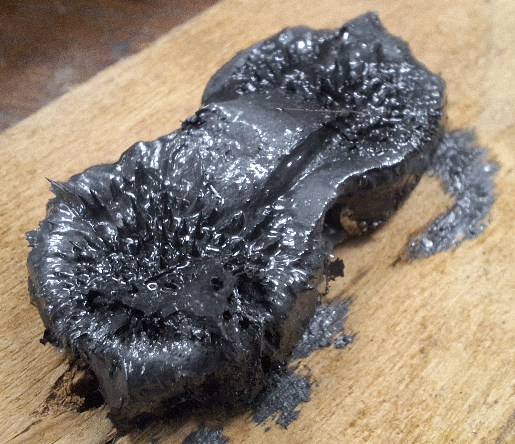

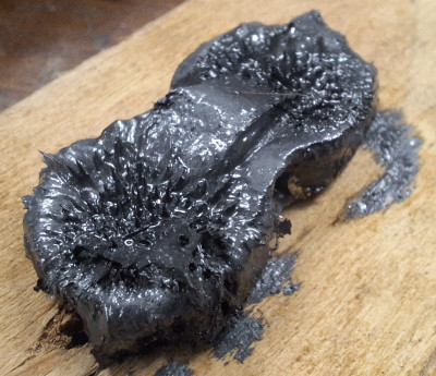

So i took the motor apart.The needle bearing whas damaged and pushed in to the diff so far blocking it.

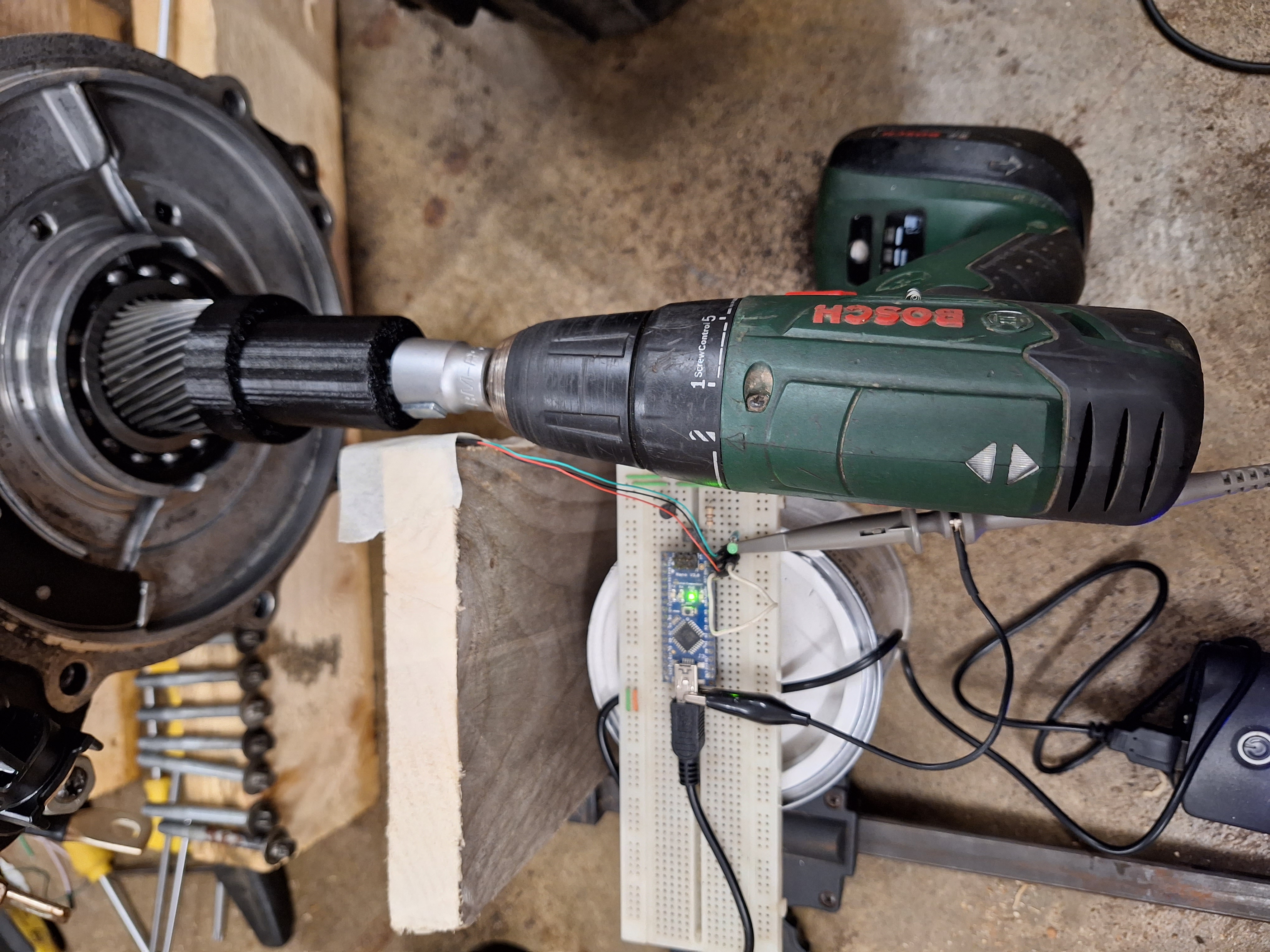

Because the motor whas apart anyway I 3D printed a adapter to drive the motor with drill. hooked up a hall sensor as a referents puls.
Took a scope shot of the phase voltage and the reference and a other of the resolver output and the referents.
So for one revolution of the shaft the phase wire gives 5 sine waves. and the resolver outputs 10 "pulses" for one rotation of the motor shaft.
So 5 pole pairs for the motor?
And 2 pole pairs for the resolver?
For the setting in the open inverter software?

Assume you are driving the resolver with a few kHz? If so then you are seeing the waveform envelope on the scope and the 10 pulses are each a half cycle (so 5 full cycles the same as the phase output) so I would guess 5 pole pairs on both.
Edit - what are the ratings of that motor?

I used the resolver exciter signal from the open inverter board.
the motor is spec'd for 50Kw 200 Nm. I am planning to use it in my Saxo electrique it has the same co-axial design as the original dc motor.
So it will fit with the front battery box. I am running the car with out this box now. I'd like some more battery's
I think you are right about the resolver signal. One hump is in phase and the next hump is out of phase with the exciter signal
So 5 pole pairs for both.

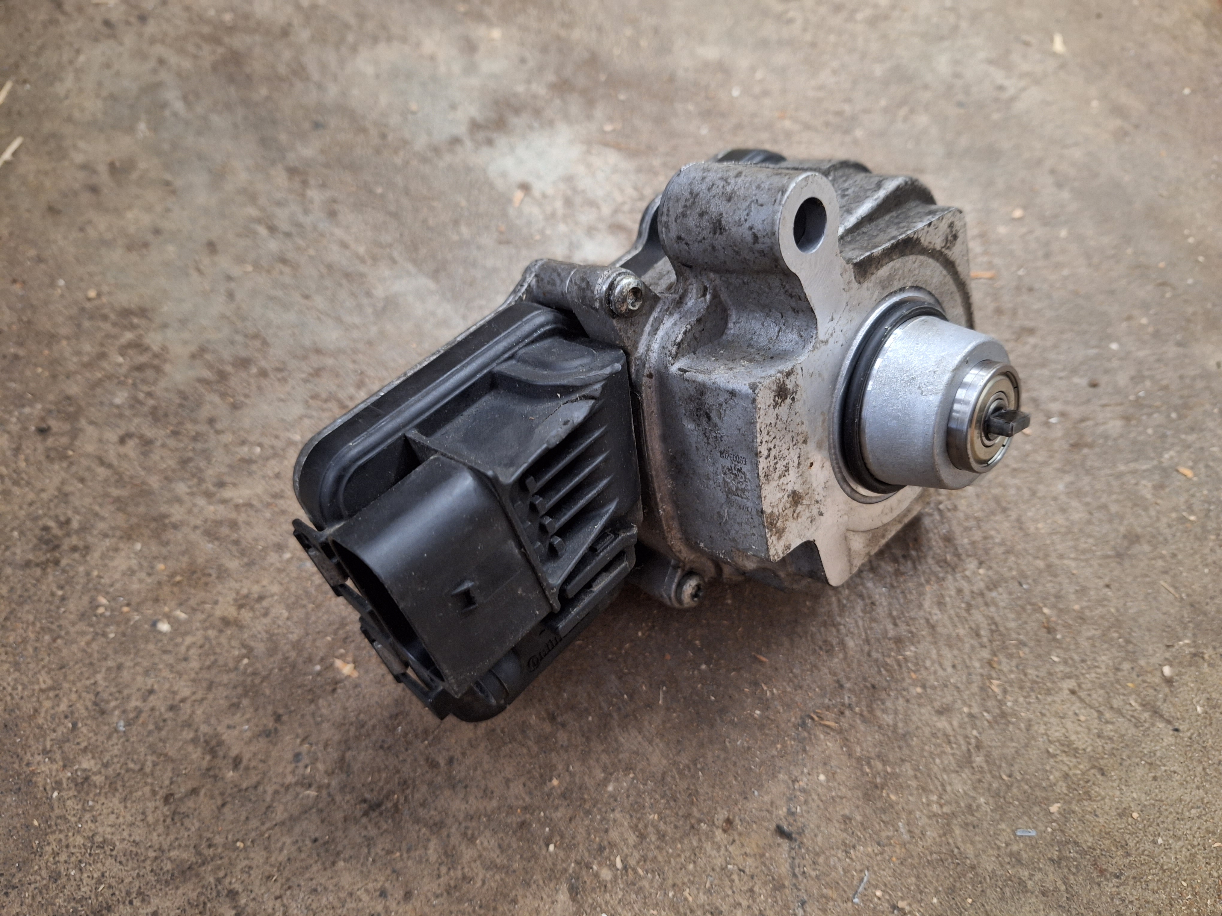

the clutches is controlled by this motor. it looks like a window motor.
as far as I know it is CAN bus controlled. because why not
I used a screw driver to move it takes just u couple of turns

Hm... how exactly does that work? So you apply 12V to the clutch and it works like ac compressor? Or does it need specific CAN command to put torque through...? Or is this a parking brake?manny wrote: ↑Wed Jul 12, 2023 9:16 am The size and co-axial design are the reason I bought it.

The clutch breaks the driveshaft that runs though the motor. And the other one spins free because of the diff.
I do not know how the CAN works with this motor.

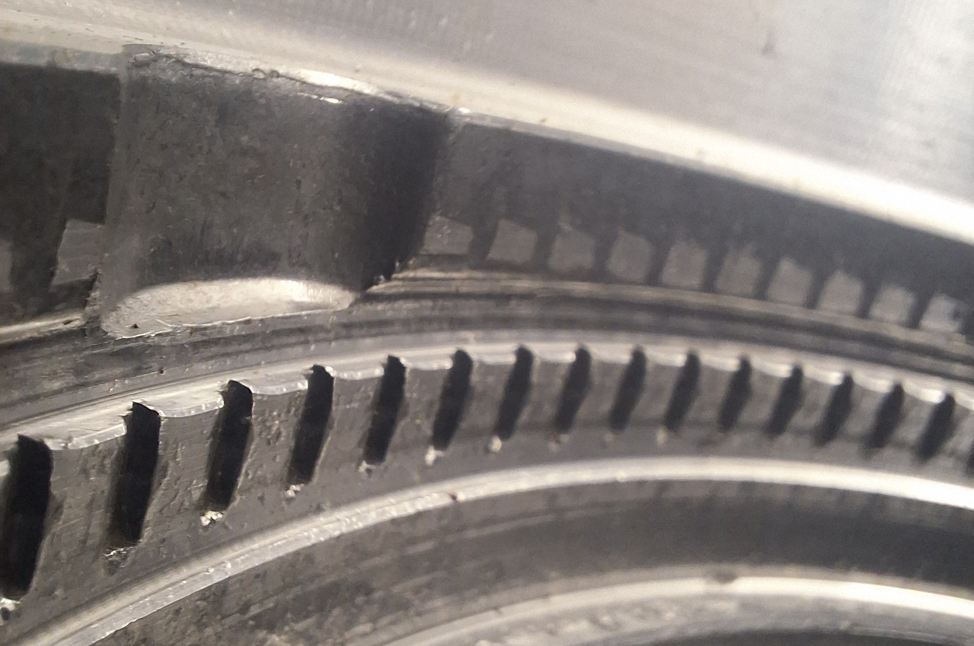

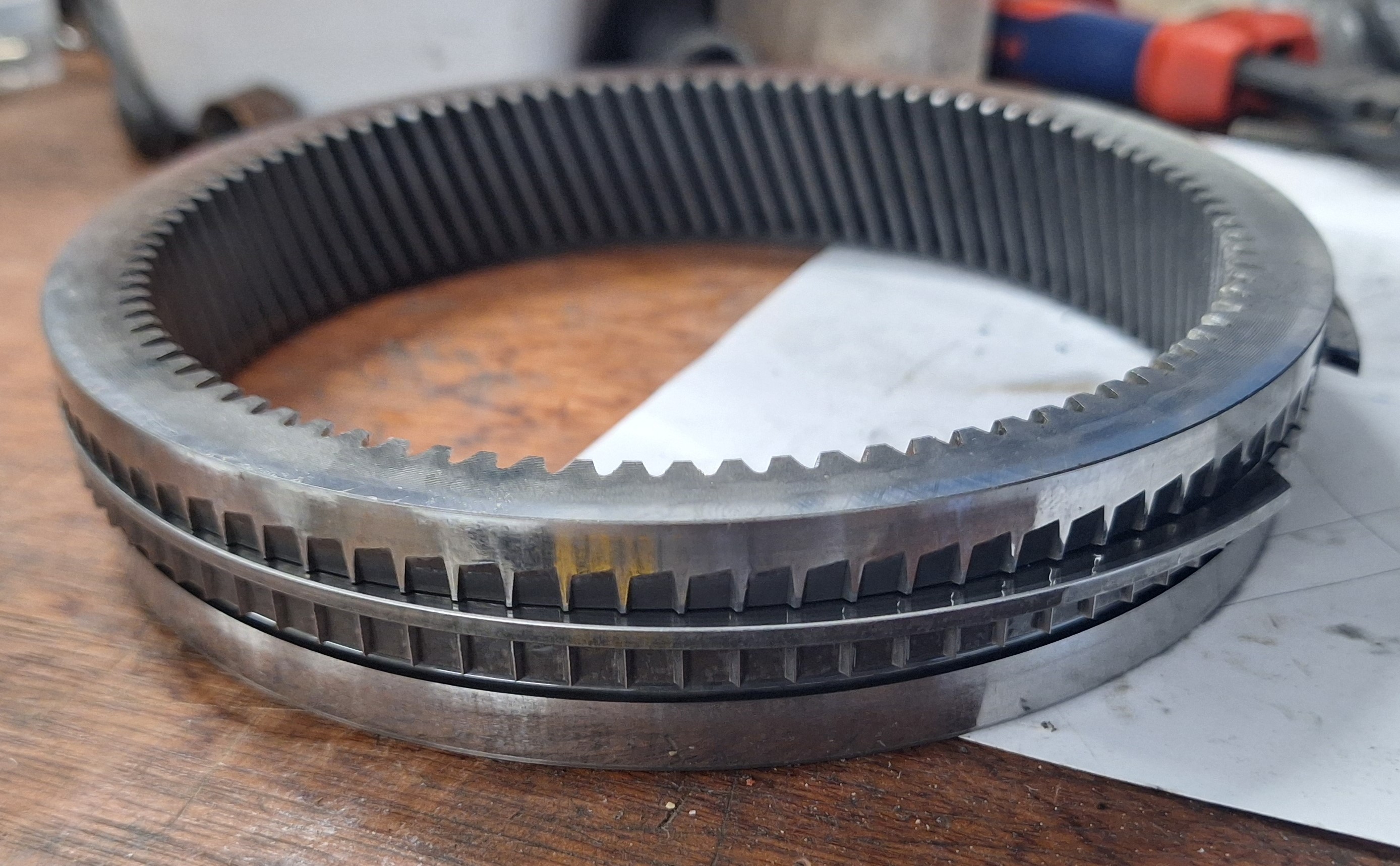

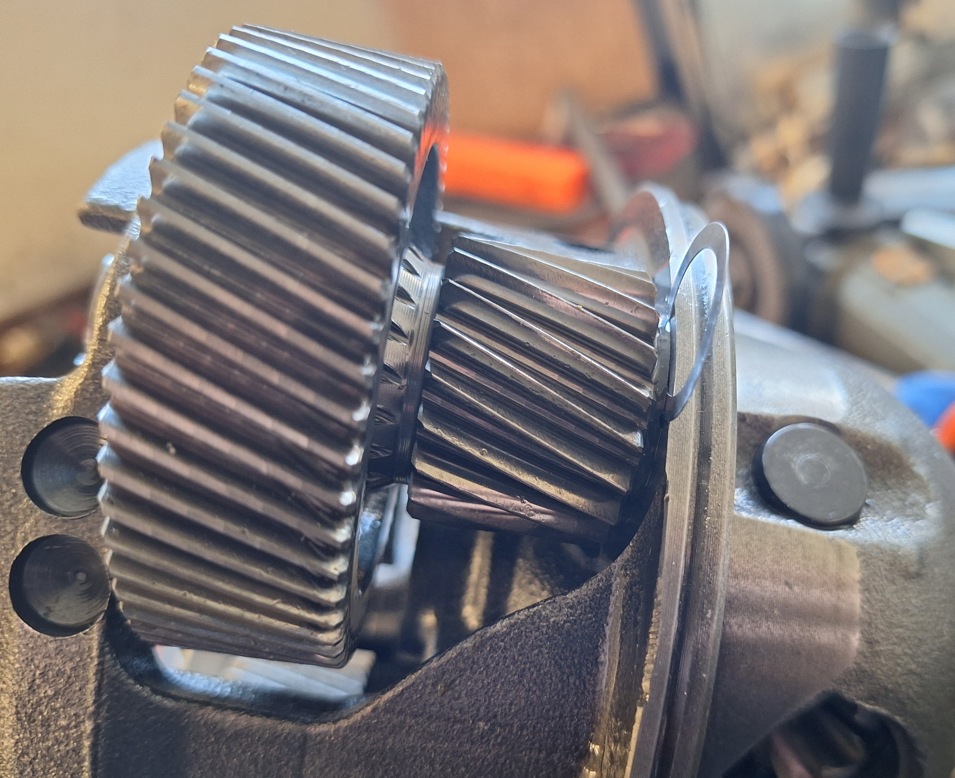

The ERAD in my Saxo project has been making a knocking noise when changing from drive to regen or form forward to reverse.
Had the motor apart a couple of times to find the problem. This time I thought I found the problem when I found play on the planet gears.
The gears are helical gears so they want to move axially. So with change in direction this play may cause a noise? Bought some shim rings to eliminate the play. After installing them and starting to reassemble the motor I spotted the real problem.
The ring gear is pulling out of the housing
the grove for the "snap/piston" ring is destroyed
Because I mounted the motor in reverse I made the problem worse(but it made this noise since day one). I think that normally when driving forward the gear is pushed in to the housing. And only under regen and in reverse there is a pulling force on the gear.
I am amazed that it did not spin in the housing with the ring gear sucked up to the planet gears.

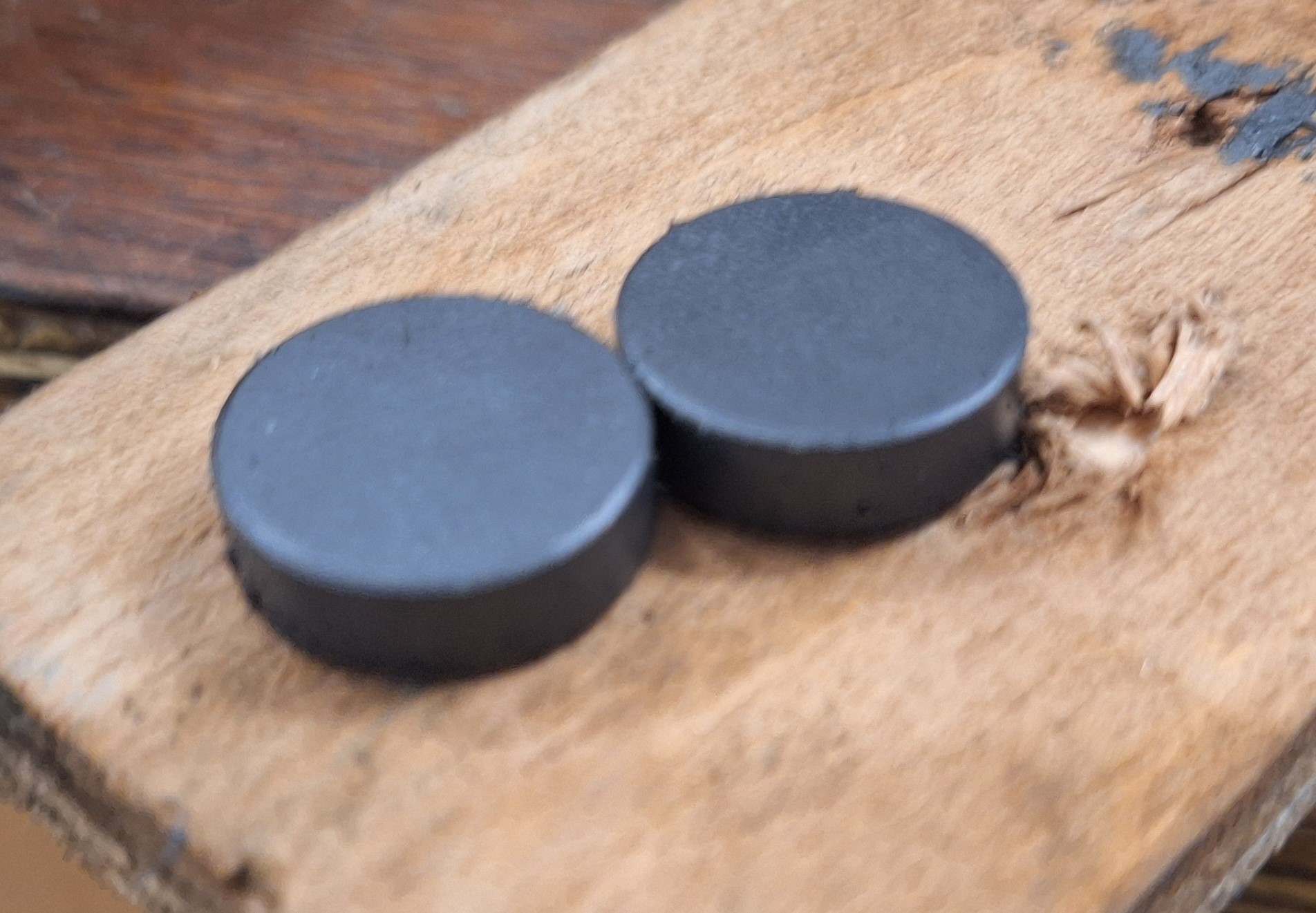

there was a lot of fine metal dust on the magnets and in the oil. So what now. Will probably try to fix it. No shure how yet.
May be cutting the damage out een making a steel ring to fill the gap ¯\_(ツ)_/¯
