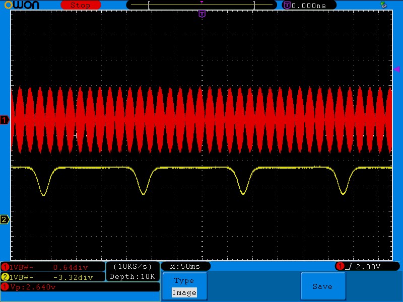

I bought a Volvo motor to connect to the Volvo inverter.
The motor connector looked the same but is was keyed different. Nothing a file can't fix.
Because this is a motor from a hybrid system it has a clutch to disconnect the driveshafts form the motor.
When the clutch whas active one driveshaft whas able to spin freely but the other one whas still hard too spin.
So i took the motor apart.The needle bearing whas damaged and pushed in to the diff so far blocking it.
Because the motor whas apart anyway I 3D printed a adapter to drive the motor with drill. hooked up a hall sensor as a referents puls.

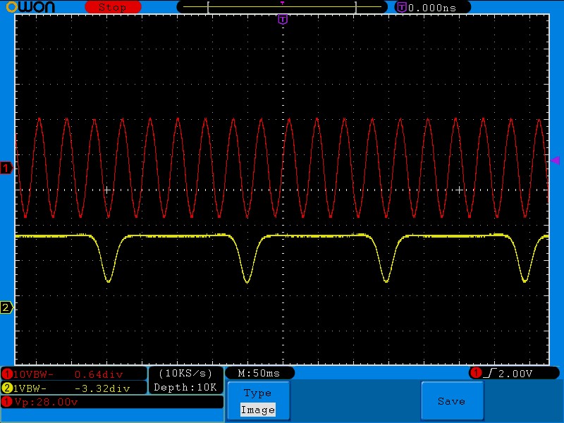

Took a scope shot of the phase voltage and the reference and a other of the resolver output and the referents.
So for one revolution of the shaft the phase wire gives 5 sine waves. and the resolver outputs 10 "pulses" for one rotation of the motor shaft.
So 5 pole pairs for the motor?
And 2 pole pairs for the resolver?
For the setting in the open inverter software?

Assume you are driving the resolver with a few kHz? If so then you are seeing the waveform envelope on the scope and the 10 pulses are each a half cycle (so 5 full cycles the same as the phase output) so I would guess 5 pole pairs on both.
Edit - what are the ratings of that motor?

I used the resolver exciter signal from the open inverter board.
the motor is spec'd for 50Kw 200 Nm. I am planning to use it in my Saxo electrique it has the same co-axial design as the original dc motor.
So it will fit with the front battery box. I am running the car with out this box now. I'd like some more battery's
I think you are right about the resolver signal. One hump is in phase and the next hump is out of phase with the exciter signal
So 5 pole pairs for both.

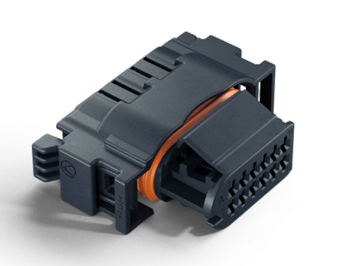

The low voltage connector is a:
Hirschmann-automotive
12way 1.2 SealStar F
806-360-521 A bit hard to find, but the pins are available.
The pipe's for the cooling are 5/8" 15.82mm Quick Connect

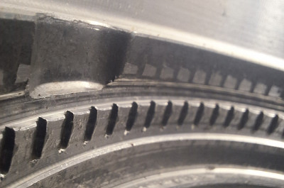

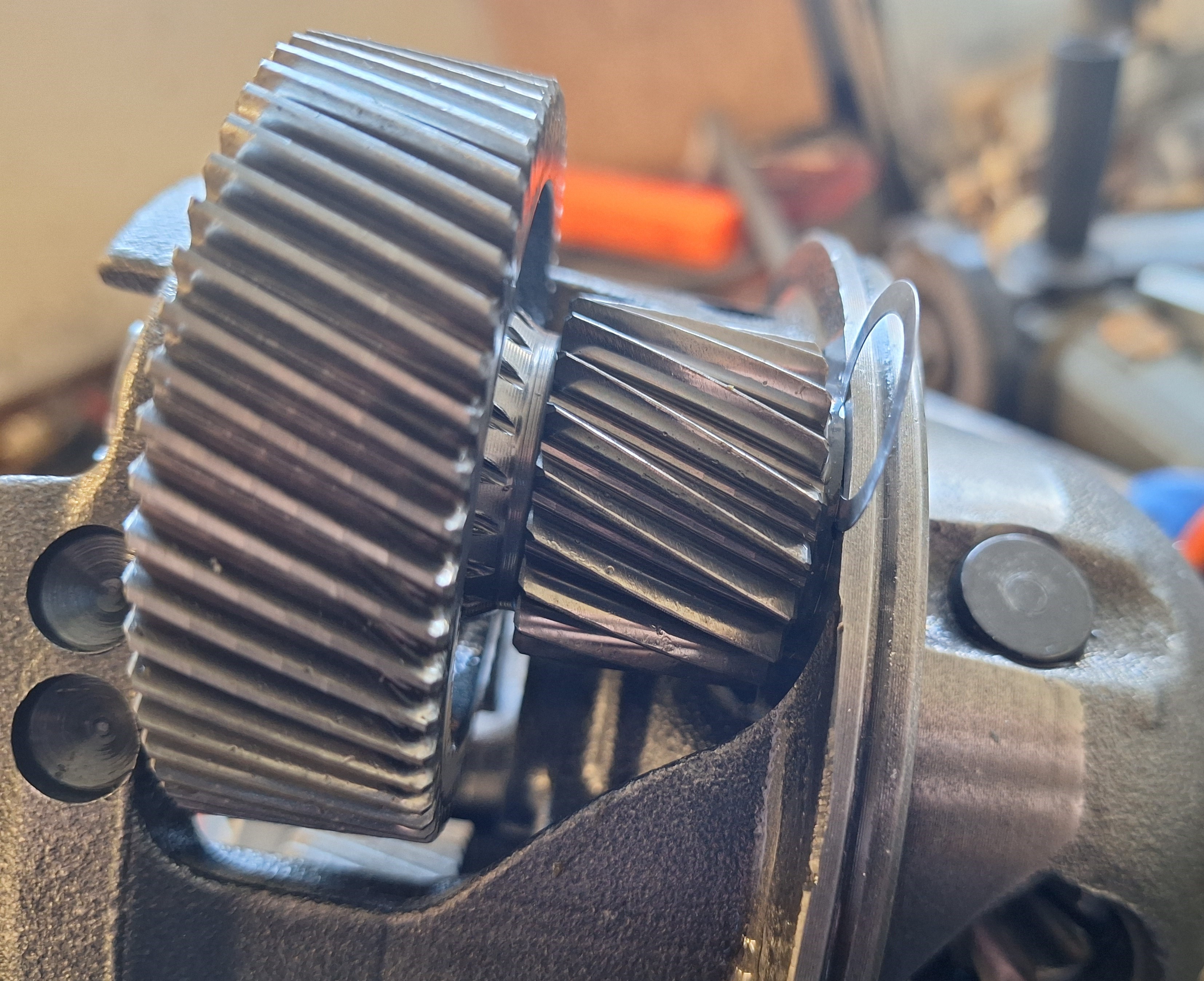

The ERAD in my Saxo project has been making a knocking noise when changing from drive to regen or form forward to reverse.
Had the motor apart a couple of times to find the problem. This time I thought I found the problem when I found play on the planet gears.
The gears are helical gears so they want to move axially. So with change in direction this play may cause a noise? Bought some shim rings to eliminate the play. After installing them and starting to reassemble the motor I spotted the real problem.
The ring gear is pulling out of the housing
the grove for the "snap/piston" ring is destroyed

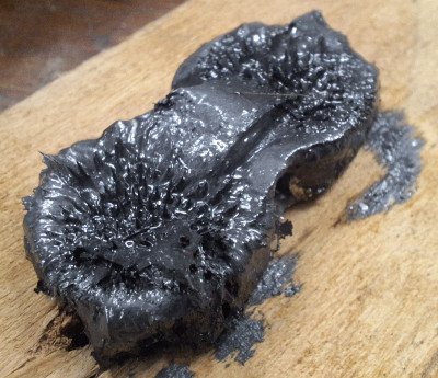

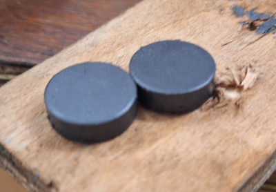

there was a lot of fine metal dust on the magnets and in the oil. So what now. Will probably try to fix it. No shure how yet.
