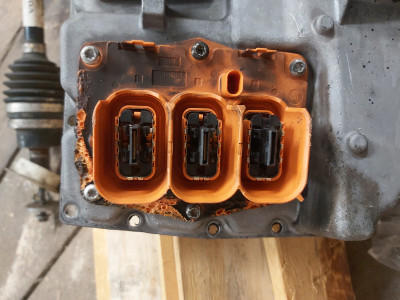

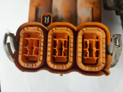

I bought a Volvo motor to connect to the Volvo inverter.
The motor connector looked the same but is was keyed different. Nothing a file can't fix.

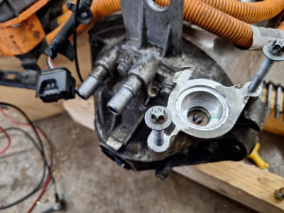

Because this is a motor from a hybrid system it has a clutch to disconnect the driveshafts form the motor.
When the clutch whas active one driveshaft whas able to spin freely but the other one whas still hard too spin.
So i took the motor apart.The needle bearing whas damaged and pushed in to the diff so far blocking it.

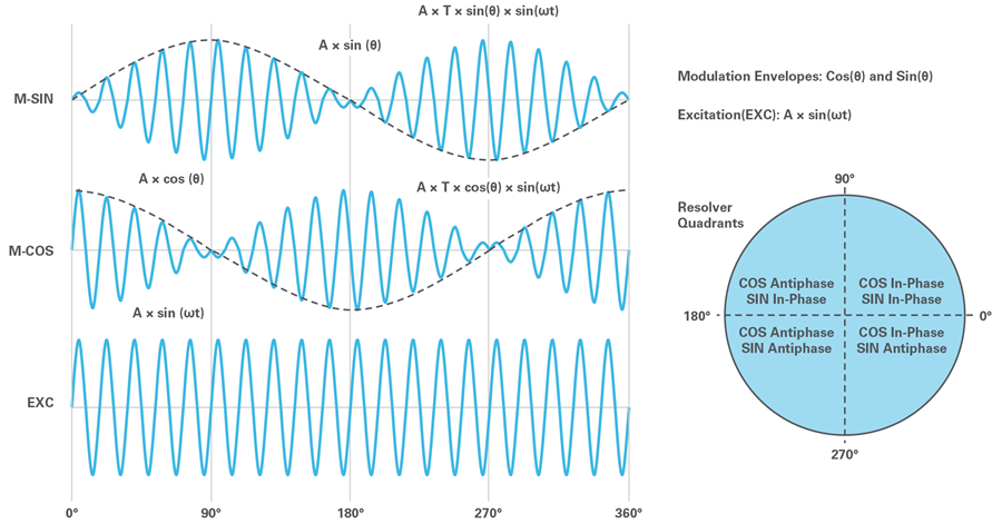

Took a scope shot of the phase voltage and the reference and a other of the resolver output and the referents.
So for one revolution of the shaft the phase wire gives 5 sine waves. and the resolver outputs 10 "pulses" for one rotation of the motor shaft.
So 5 pole pairs for the motor?
And 2 pole pairs for the resolver?
For the setting in the open inverter software?

Assume you are driving the resolver with a few kHz? If so then you are seeing the waveform envelope on the scope and the 10 pulses are each a half cycle (so 5 full cycles the same as the phase output) so I would guess 5 pole pairs on both.

I think you are right about the resolver signal. One hump is in phase and the next hump is out of phase with the exciter signal
So 5 pole pairs for both.

the clutches is controlled by this motor. it looks like a window motor.
as far as I know it is CAN bus controlled. because why not
I used a screw driver to move it takes just u couple of turns

Hm... how exactly does that work? So you apply 12V to the clutch and it works like ac compressor? Or does it need specific CAN command to put torque through...? Or is this a parking brake?manny wrote: ↑Wed Jul 12, 2023 9:16 am The size and co-axial design are the reason I bought it.

The clutch breaks the driveshaft that runs though the motor. And the other one spins free because of the diff.
I do not know how the CAN works with this motor.

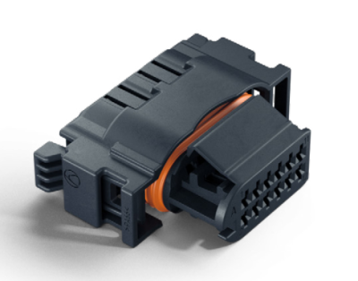

The low voltage connector is a:
Hirschmann-automotive
12way 1.2 SealStar F
806-360-521 A bit hard to find, but the pins are available.
The pipe's for the cooling are 5/8" 15.82mm Quick Connect
