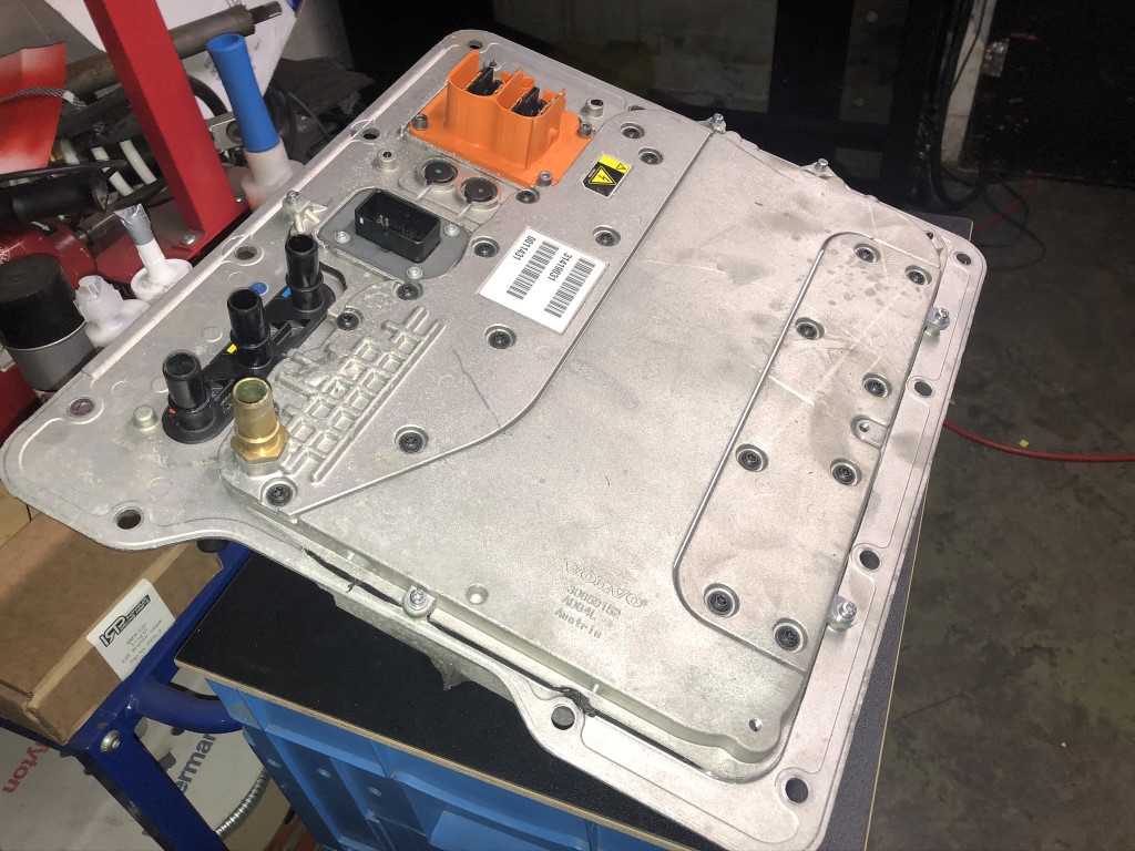

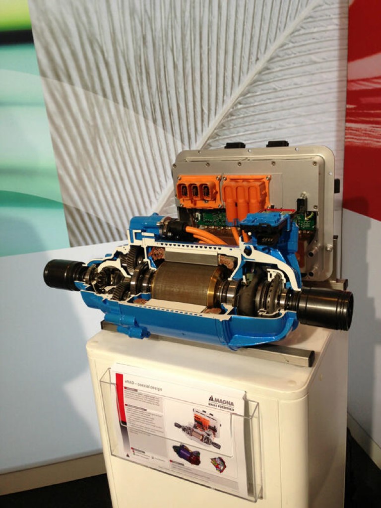

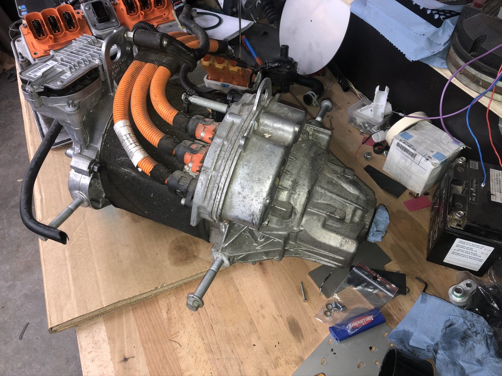

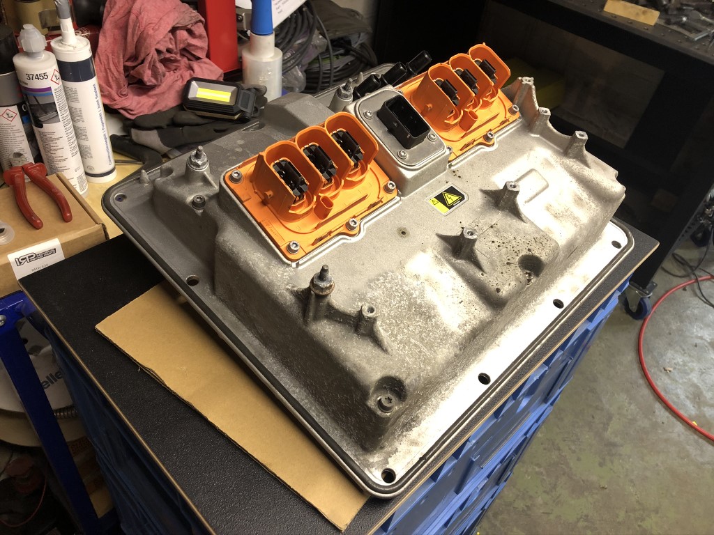

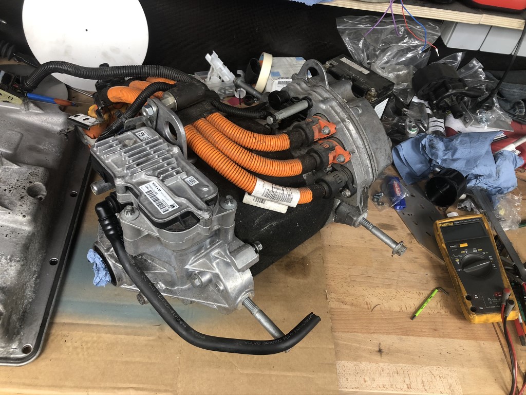

For a small car conversion I would like to get a Volvo V60 PHEV rear-axle motor running. Preferably just by CAN-controlling the inverter, if that gets to difficult, I will 'johannes' the inverter : -) (or use another inverter)
- Does someone have a CAN-logfile of the HS-CAN & SENSOR-CAN of a Volvo V60 PHEV ? Already tried a lot with the Fuzzing-feature of Savvy, but definitely need a base of vehicle-messages to start with.
Below some pictures of the inverter & coaxial PM rear-motor. Rated for 50-60kW, but looking how everything is dimensioned I think there is quite some power margin to use. Inverter uses 600A IGBT's. Has two sides (one for the rear axle, one for the starter/generator which is dimensioned smaller), each has his own logic-board and spits out his own CAN-messages.
Volvo V60 ERAD Electric Rear Axle Differential + Inverter

ERAD weight is around 48Kg (including cables & oil).
I haven't driven a V60 PHEV yet, but have been told that it will reach in Pure (electric only) mode about 120-130km/h.
Meanwhile I had the chance to make logfiles of both CAN-busses in a running V60 and did build up some communication with the inverter, until the immobilizer stopped the progression. At boot, the inverter sends a random code in one CAN-message and expects a calculated response from the ECM (body module) back. I can spend some time to find the ECM that belongs to this particular inverter, but that's not the solution I would like.
So this project has been parked until I got another project running. Will pick this up later and probably design a logic-board for the inverter using the 'Johannes'-brain.
