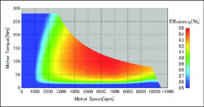

We've probably all seen this graph before: Looking at the peak power, it seems to be 275 N-m at 2750 RPM which of course equals 80 kW.

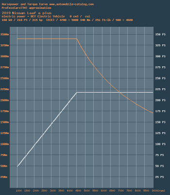

Then there's this chart for the 160 kW Leaf: Here, the motor makes constant torque all the way out to 4600 RPM.
I know the 160 kW Leaf has a higher capacity battery, but I thought the voltage was the same. My understanding was that in order to maintain a given torque into a higher RPM, the voltage input had to be increased to overcome field weakening, so I would have expected the 160 kW graph to look like the 80 kW graph but scaled vertically by a factor of 2 (at least, approximately, and assuming the battery voltage is the same). Similarly, I thought that if you wanted to increase the speed at which field weakening takes over, the battery voltage had to be increased.
So, if I wanted to set up my Openinverter to increase the max current by 50% (120 kW), what would my graph look like? And if I wanted to decrease the battery voltage by say 12%, then what?

Your understanding is pretty good. The horizontal line at the top of your first graph is set by the current limit set for the motor, the curved section is set either by the onset of field weakening or the DC limit of the battery (whichever happens sooner) and the diagonal section at the bottom right is the RPM limit for the inverter controller/motor (not too sure why it's diagonal rather than vertical though?). In your first plot I'm guessing it is the battery current that is limiting the curved section while the transition to it in the second plot is probably due to the transition into field weakening.
BTW - field weakening isn't quite the nice clean transition point usually described. There are components to the motor voltage due to the back emf but also due to stator currents. The more current being driven into the motor the earlier you run out of volts and the earlier the onset of FW.

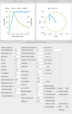

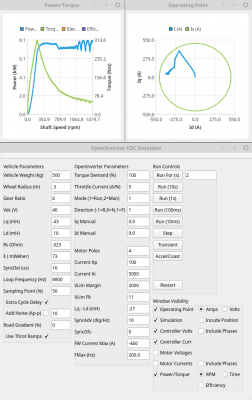

Re: Leaf EM57 estimated output at different voltage/current
Awesome, thank you so much!

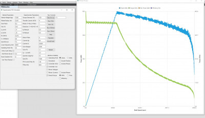

I suppose I should next ask if anyone has some Inverter settings that work well with this motor. And the latest firmware version. I started off with the Leaf motor example and GT86 parameters from the wiki, but it looks like some of the parameter fields have changed.
I can get it to spit this out, but I can't really figure out why the torque is dropping off at such a low RPM.
Glad you got it working
Try more FW Current Max, it should be set to around -flux linkage/ld so around -500.
Because of the low value set you are running out of -Id at higher speed and the control algorithm is having to back off the power instead to maintain control over the motor.

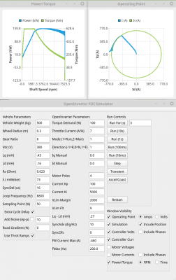

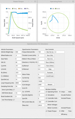

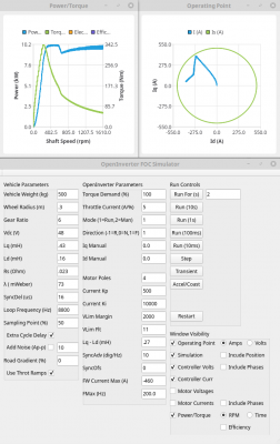

Okay, I think I am making progress! Thank you! I plugged in those settings and got some pretty weird graphs, but once I started adjusting the Current Kp and Ki settings, it started to look better:
It still seems down on peak power and the torque is still falling off at a lower RPM than I would have expected. Increasing the FW Current Max beyond 600 started to produce some weird results into the higher RPM range. Peak power is still only around 88 kW.
I also had to keep the vehicle weight pretty high, I think if you lower the weight too much, it starts doing some weird stuff (graph turns into a spiral). In any case, my vehicle should come in closer to 800 kg and probably won't be able to use much more than about 300 N-m of torque, which is why I'm so focused on where it starts to drop off (or, more to the point, where the torque begins to drop below ~300 N-m).
I'm reading up on FOC theory so I can better understand what's going on, and hopefully I can work out how the later models are holding more torque into higher RPM. I see from that 160kW graph I posted earlier that they are still getting >250 N-m at 6000 RPM. Even if I could hit 200 at that speed, I'd be thrilled!
Unfortunately I've not used the simulator much with the latest OI firmware, or with Leaf parameters, but had a quick go with it yesterday. It's definitely not as stable as I remember and the power does seem a bit down. When I have time I'll try to have another look. Johannes probably has most experience using it with Leaf settings - @johu - any suggestions?
Regarding power there are a few things that could affect it:
- Wrong parameters - flux linkage in particular has a big effect on torque. If anyone has a running Leaf/OpenInverter setup with a web interface some csv logs would be very useful to verify we have the right settings - see viewtopic.php?t=3047
- Mtpv - I'm sure there is more power to be had in FW but haven't been able to progress it recently (see viewtopic.php?t=3080 for more details).
- There is no point going above -flux linkage/Ld for FW current. The flux linkage/Ld is the point that gives minimal back emf, so maximum field weakening, moving away from it in either direction just makes things worse. The spirals you mention are usually when the control loops are trying to find the minimum but instead of hitting it are circling around it.
- Unchecking the extra cycle delay box will improve stability. It means that the simulator doesn't fully represent the way the PWM values are updated in the OI firmware but that shouldn't matter for what you are doing.
- Until we know we have the right parameters for the motor, and the Mtpv stuff sorted, it may be worth not focusing too much on the absolute power levels and just use the simulator to evaluate the relative change produced by different battery voltage and throttle current settings. The other option is to tweak flux linkage (probably the parameter with least certainty at the moment) till you get values that you believe.

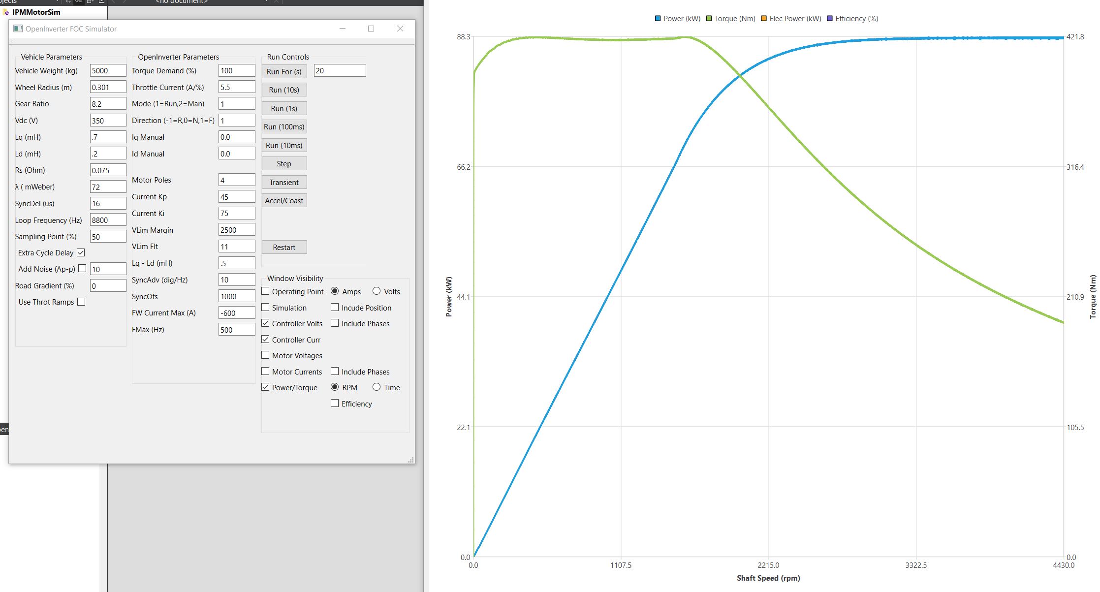

Two things. First Dusty4 very kindly took some logs from his Leaf motor (see viewtopic.php?p=52875#p52875) so we have some better motor parameters to try
Also I've had a look at the simulator to see what's causing the stability problems and have found a fairly obvious bug
. If the motor current goes above around 400A using the standard param_prj.h file the adc saturates and the stability issues start. Essentially this is simulating the behaviour of the inverter correctly but the default file is for a Prius inverter which has a lower range on the CTs, not normally a problem on the Prius but if the same file is used on a Leaf setup without revisions you get adc saturation and stability problems. Sorry about that.
This is probably why you found the need for the very low kp and ki gains.
To fix change the lines in the param_prj.h file (the one in the same directory as the IPMMotorSim.pro file) from
to
and rebuild the project. This should fix it in the simulator.
Here are a couple of plots using Dusty4's parameters and the fixed simulator code. First with the standard code: And next with the pseudo Mtpv derivative I'm working on: Unfortunately the later isn't ready to be released yet. (Edit - but it is getting a lot closer to your 250Nm @ 6krpm)
