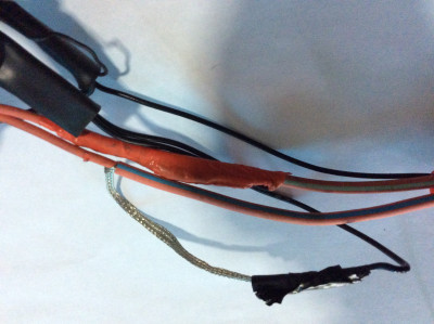

Not quite the charger but the internal charge cable from the j1772 end of a 2014 Outlander. I’m planning to put the socket behind the original fuel filler inlet for my Beetle conversion. Problem is this is about 2m further from the charger than it was in the Outlander and has a somewhat convoluted system where the main cables are individually screened and are crimped separately to a common earth. I have tried multiple sources and haven’t found anyone who can supply anything similar to the shielded orange with blue/green stripe cables to replace or extend the originals. Its only a 240v 10A system but apparently doesn’t correspond to any known Australian code. So, does it really need individual shielded cables? Should I consider running a slightly larger twin shielded cable if I can fit it in the requisite orange trunk with the PP and CP wires? Suggestions please.

Orange is just the color of HV. Are those 240Vac wires? In that case they are shielded because of EMI protection. If nobody at your DMV will fuss about it there is no reason you couldnt use twin shielded cables. But shield must be connected to chassis GND. Other cables are LV and they dont need to be shielded then...

Thanks arber, that’s just what I needed to hear. I can pick up some extra shielding, splice in some extra cable and keep the original connectors. It just seemed such an awkward original arrangement. It all has to be inside orange conduit for the ADR (Australian Design Rules) so no one will ever see it.

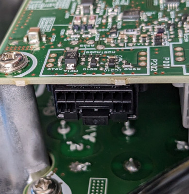

Does anyone have a charger on their desk and wants to beep out the internal signal connector?
I found out that it's a Hirose GT8E-12DS-HU connector (see catalogue: https://www.hirose.com/de/product/docum ... =D49379_en ), but I still need the pinout since my charger came without the pigtail.

crasbe wrote: Fri May 05, 2023 10:09 pm Does anyone have a charger on their desk and wants to beep out the internal signal connector?
Isnt there already pinout on wiki: https://openinverter.org/wiki/Mitsubish ... r_DCDC_OBC

arber333 wrote: Fri May 12, 2023 9:44 pm Isnt there already pinout on wiki: https://openinverter.org/wiki/Mitsubish ... r_DCDC_OBC
Yes, rstevens81 was so kind to add it to the wiki. I forgot to update the thread :)
