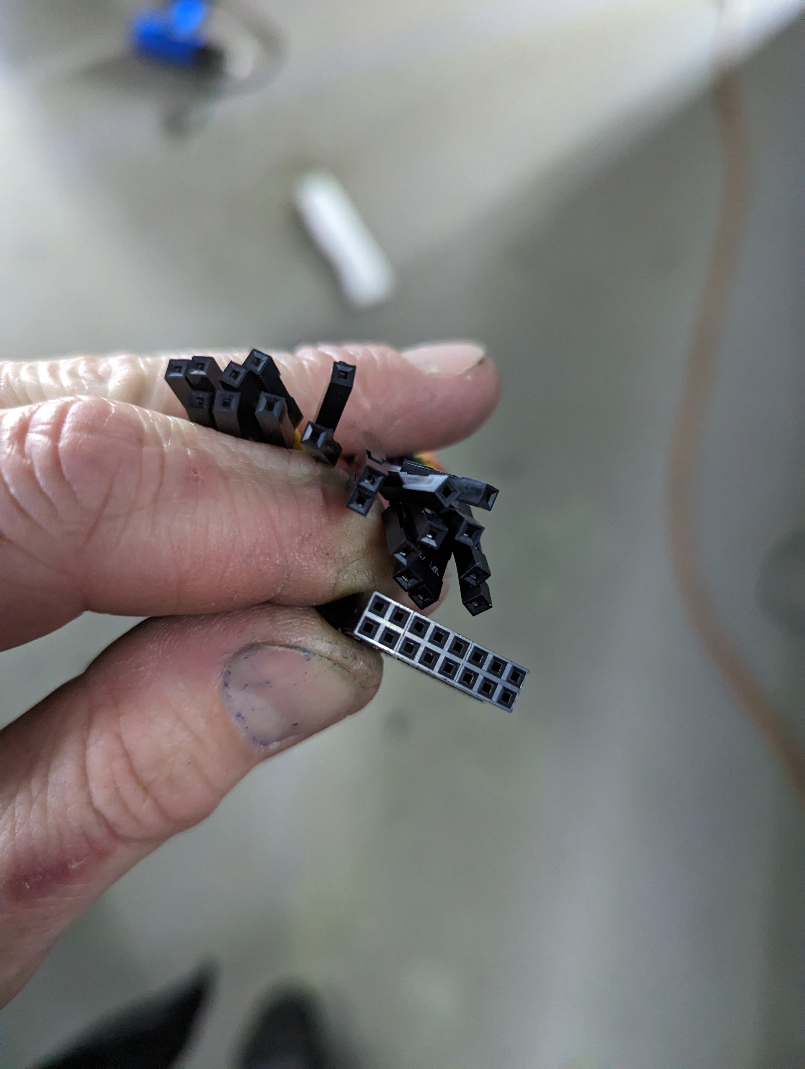

I bought this set of connectors and figured it's not an exakt fit. Am I doing something wrong? The horizontal distance of the pins fits perfect, but the upper and lower rows are further apart on the inverter pins than on the plugtom91 wrote: ↑Tue Mar 01, 2022 9:12 pm I just got my new Ender 3 S1 setup and wanted to test some small prints.
Have been in the progress of designing ways of reusing the Rear motor and Inverter, the biggest issue is the connectors.
I have now designed a basic connector starting point that use the "dupont" style header connectors.
The attached STL works for both the Vehicle connector and the Motor connector of the rear inverter and thus also on the motor. Will be working on making the print better to eventually include a seal and allow for potting the wires.
I know the plug in my hand has 2 pound too much, i just wanted to show the vertical distance and had this laying around

I guess o figured out of already
i should use two single row connectors?!

Yup that is needed in my print there is a little nub between them for spacing.
