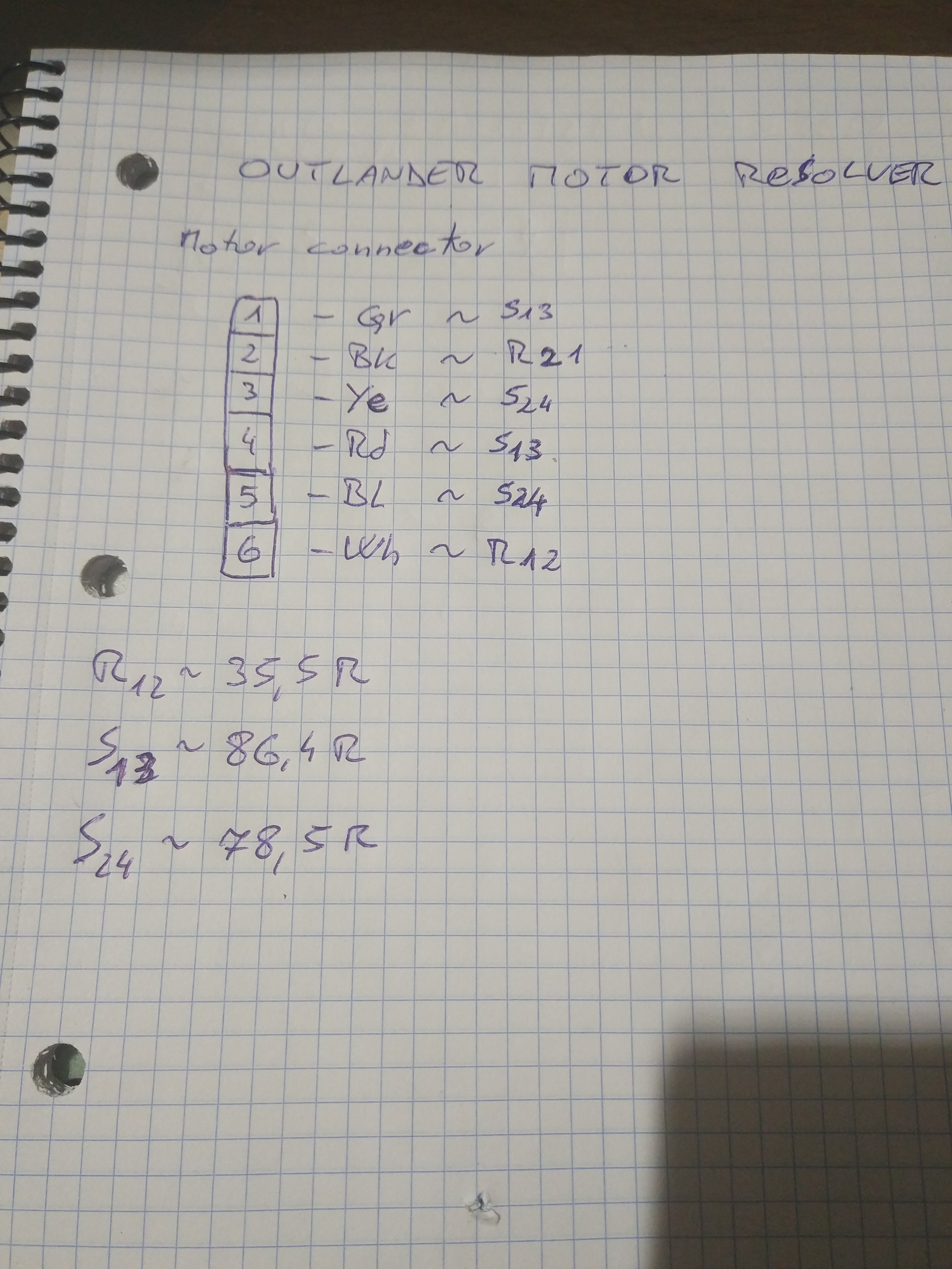

I got this resolver setup in my harness
R12 - 35,5R Black, White
S13 - 86,4R Green, Red
S24 - 78,5R Yelow, Blue
