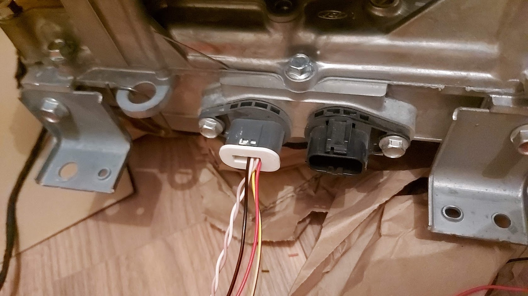

For me it was bad connection between inverter and motor ( Resolver)
I metered every pin on the inverter to check against the values listed in the service manual (see attached)
Note that RSDN should be pulled low.
Once that was sorted it all worked very easy, no particular sequence.

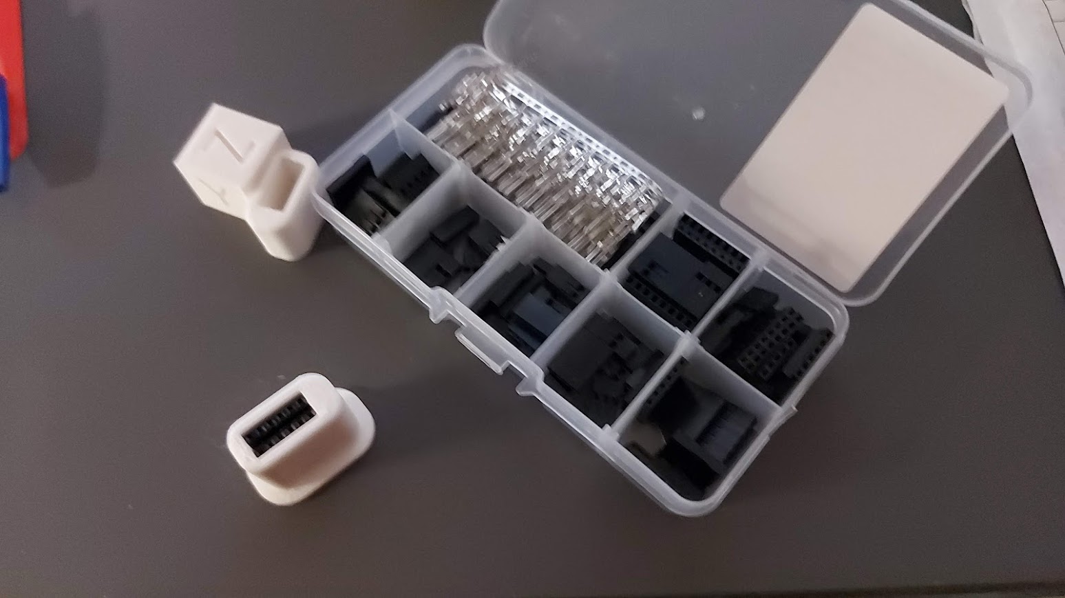

I just got my new Ender 3 S1 setup and wanted to test some small prints.
Have been in the progress of designing ways of reusing the Rear motor and Inverter, the biggest issue is the connectors.
I have now designed a basic connector starting point that use the "dupont" style header connectors.
The attached STL works for both the Vehicle connector and the Motor connector of the rear inverter and thus also on the motor. Will be working on making the print better to eventually include a seal and allow for potting the wires.

Is there an updated version of the plug?
So I'll need 2 on the inverter and one on the motor? Does this connect to the resolver on the motor?
Thanks, Philip
Thanks, Philip

Attached are two updated models.
Now including a perimeter outside the mating parts, this is so you can really only fit it one way and to add alot of grip onto the OE connector.
It slips on tight and if printed right will be a pain to remove so it means it will stay put.
I have modelled it with the TE AmpModu housing 1-87499-1 in mind as this one has the largest wire size range available officially.
Here is a print with the Chinese Dupont housings What it looks like with the correct housings The idea of the extended section is so you can pot the wires and add a boot onto the 3d print. And how they fit on the OE parts
