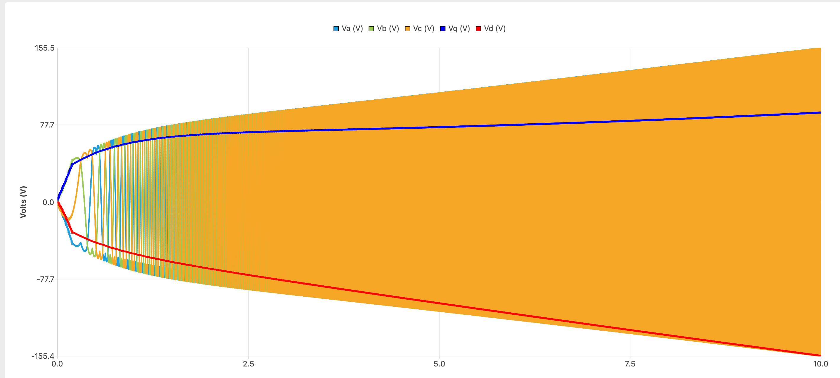

While resaerching the V/Hz definition I came across overmodulation. That is increasing the amplitude so that the sine wave is clipped and approaches a square wave. This yields higher amplitude at the cost of increased EMI, apparently.
But it seems it can wrangle a bit more power from the Prius motor: All I changed is modMax in foc.cpp to 45000
Same settings without overmodulation:

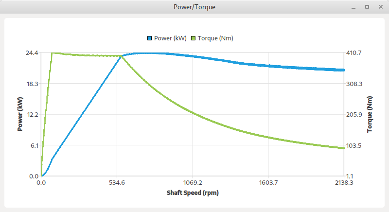

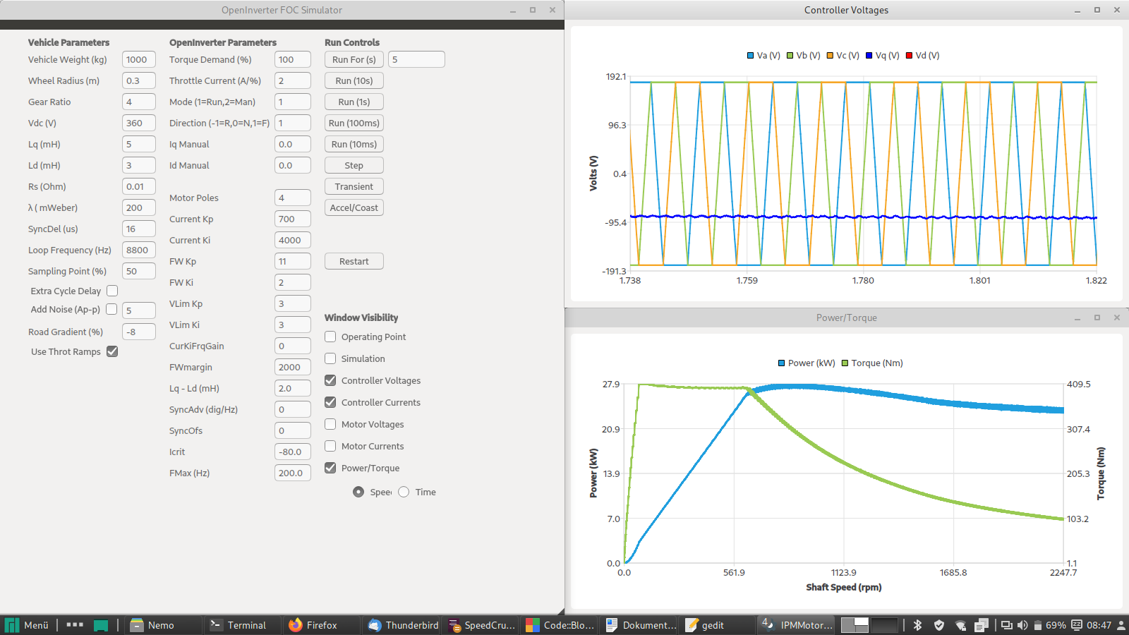

Does 27mWeber seem reasonable?
Not calculated icrit just used -75 for now The simulation looks OK to my limited understanding
- Posts: 1801
- Has thanked: 102 times
- Been thanked: 350 times
Agree, 27mWb does seem a little low but it's what the maths says. Were iq, id and vq all zero when you took the measurement? Without spinning up a motor on the bench and measuring the voltages it's difficult to come up with a better estimate.
Graphs look good
Only comments are stick with loop freq set to 8800. That is the frequency the control loop runs at, its also the pwm update frequency (double update at 4400Hz). The current rise times do look a little slower than expected though (although nice and stable when they hit the setpoint), might be the loop freq but if it doesn't improve when you change to 8800 try upping the loop gains slightly.
With those values for Ld and flux linkage icrit should be nearer -270A (although not familiar enough with Johannes code to comment how to set things up for that - still need to give it a try and then do the final simulator update)
Edit - I also tend to reduce the car weight most of the time - it makes the simulations run quicker! And increase it back to a realistic number just for final runs.
Edit2 - what power is the simulator showing for your setup?
Edit3! - and keep the extra cycle delay ticked. It's needed to include the delay before the new pwm values are loaded in the real hardware.

I'll go make specific logs for this purpose, I'm not sure what the values for iq, id and vq were 0, was just coasting down hill, 0 throttle or regen, low rpm, but was only logging with the old esp8266.
Simulator shows a max of 45kw, which is lower than I've seen using my shunt. Increasing the FWmargin to 5500 gets the power up to 68.8kw on the simulation, not tested that in the car though.

That's interesting, you haven't even hit the constant/max power region of the plot yet. Would be worth letting the simulation run a bit longer (or reducing car weight - doesn't affect the power, just how quickly it gets there).
Dont need to be coasting down a hill, coasting on the flat should work fine too.
Interesting on the fwmargin, should go the other way! Making it bigger reduces the max amplitude on the pwm which should reduce power
Edit - what speed do you run the motor up to in the car?
Edit2 - for the flux linkage measurement it is better to coast at a higher speed as the larger numbers improve accuracy, say half base speed?
