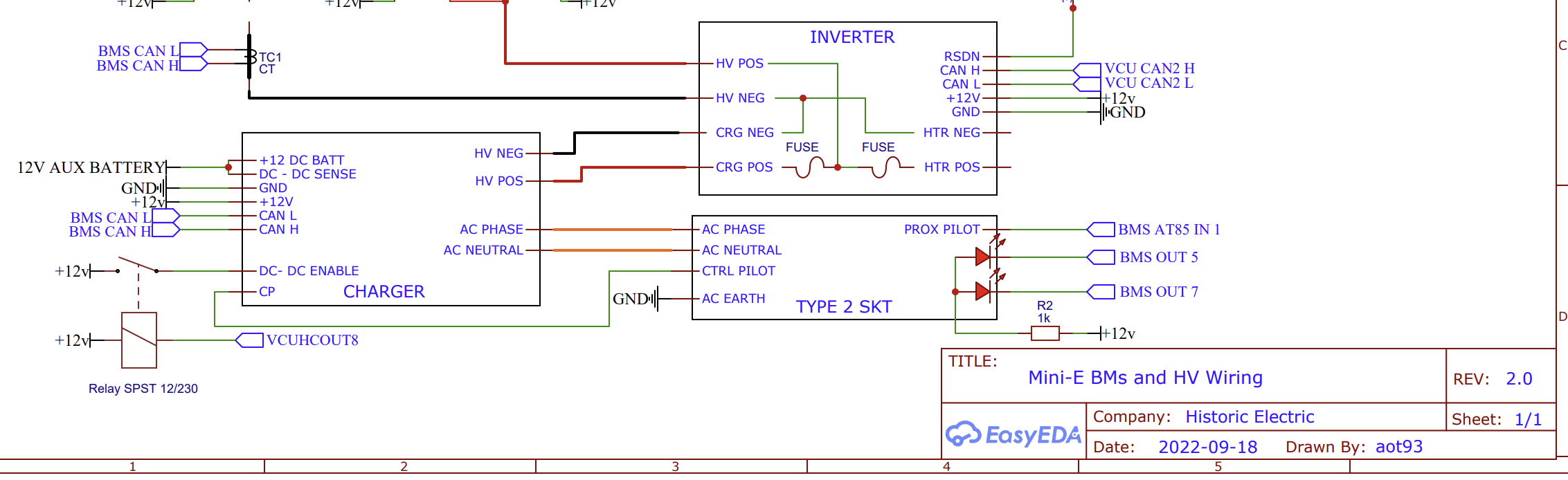

- aot93
- Posts: 212
- Location: UK, West Sussex
- Has thanked: 8 times
- Been thanked: 49 times

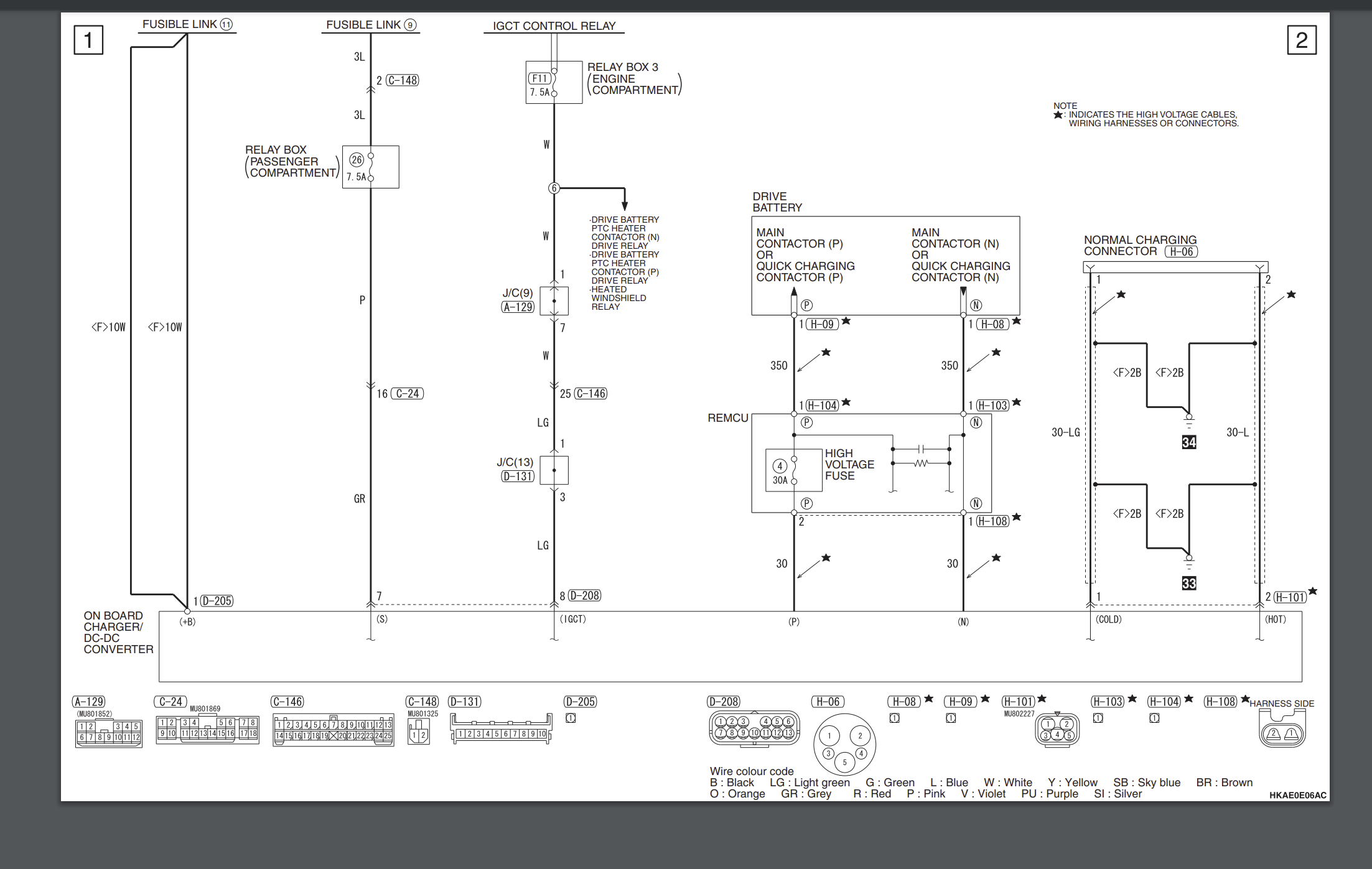

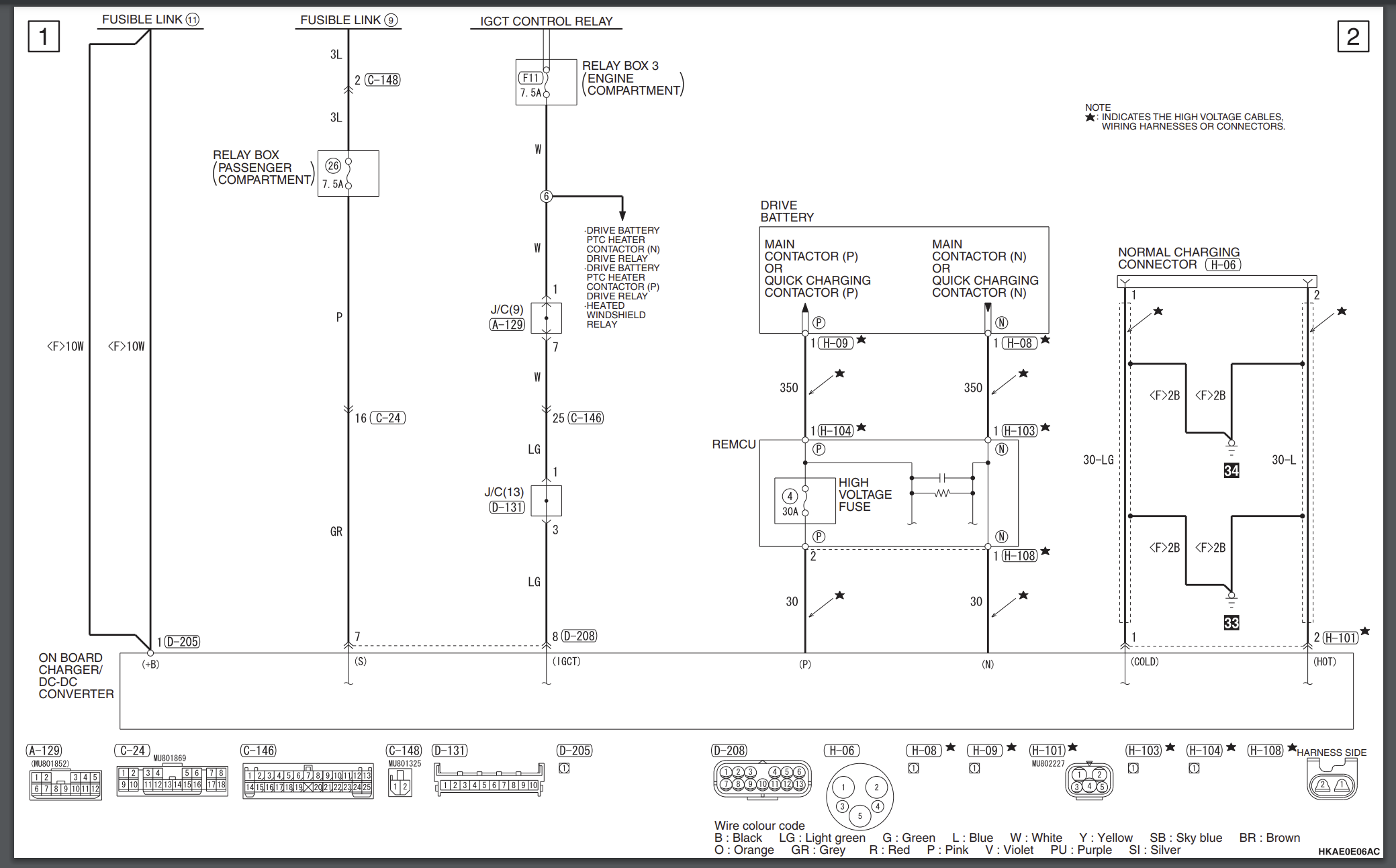

Re: Mitsubishi outlander charger and DC:DC
What sort of wiring diagram are you looking for?
I've posted the OEM wiring diagrams only a few posts up.
The Wiki page also has all the relevant info.
If you want to see an example of how I installed the charger in my conversion my diagrams are here:
https://oshwlab.com/aot93/mini-e-wiring
this is the relevant part:

Outlander wiring diagram is on this thread, second post or maybe this one https://openinverter.org/forum/viewtopi ... 8566#p8566
