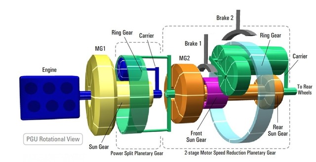

Beginning to answer my own questions by *gasp* reading thru the forums.ggeter wrote: ↑Sun Dec 05, 2021 9:22 pm Anybody got any workarounds for this oil pump? Aux pump with adapter plate?
And honest question: if I do not lock up input shaft and command MG1 to turn to mimic the input rotation of the ICE, and run only MG2 with proper solenoids engaged to move the car, can I forego the electric pump?
If I'm to believe the drivetrain animation and Damien's video of the transmission making its own pressure while free-spinning, I propose the following for those with tiny British roadster projects like mine who a) don't really need MG1 for power generation, b) are afraid of burning out an expensive electric oil pump, and c) are far too deep in their project to go with another power unit:
1. DO NOT lock input shaft
2. Engage Brake 1 solenoid
3. Engage electric oil pump (EDIT3: don't even need to do this. Keep MG1 spinning to keep pressure up, no elec pump required. Car will creep, but then so do all ICE automatics...)
4. Increase throttle to get car rolling
5. Shut off electric oil pump
6. Apply a small amount of torque on MG1 so that the blue part of the drivetrain diagram rotates/slow down as needed to apply pressure (IS THIS EVEN NEEDED since in Damien's video, pressure rose to 100# and held fast?)
7. Use flywheel aspect of MG1 to add to regen constantly
8. BONUS: put an electric clutch on the input shaft so you can add in MG1 for poor man's "Plaid" mode when one really needs it
Poke holes, please.

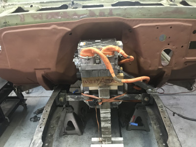

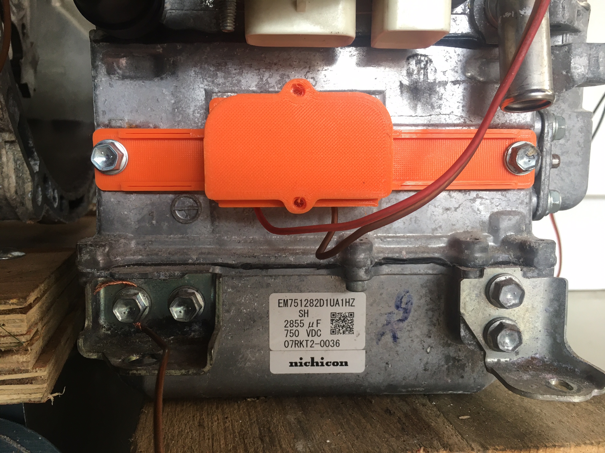

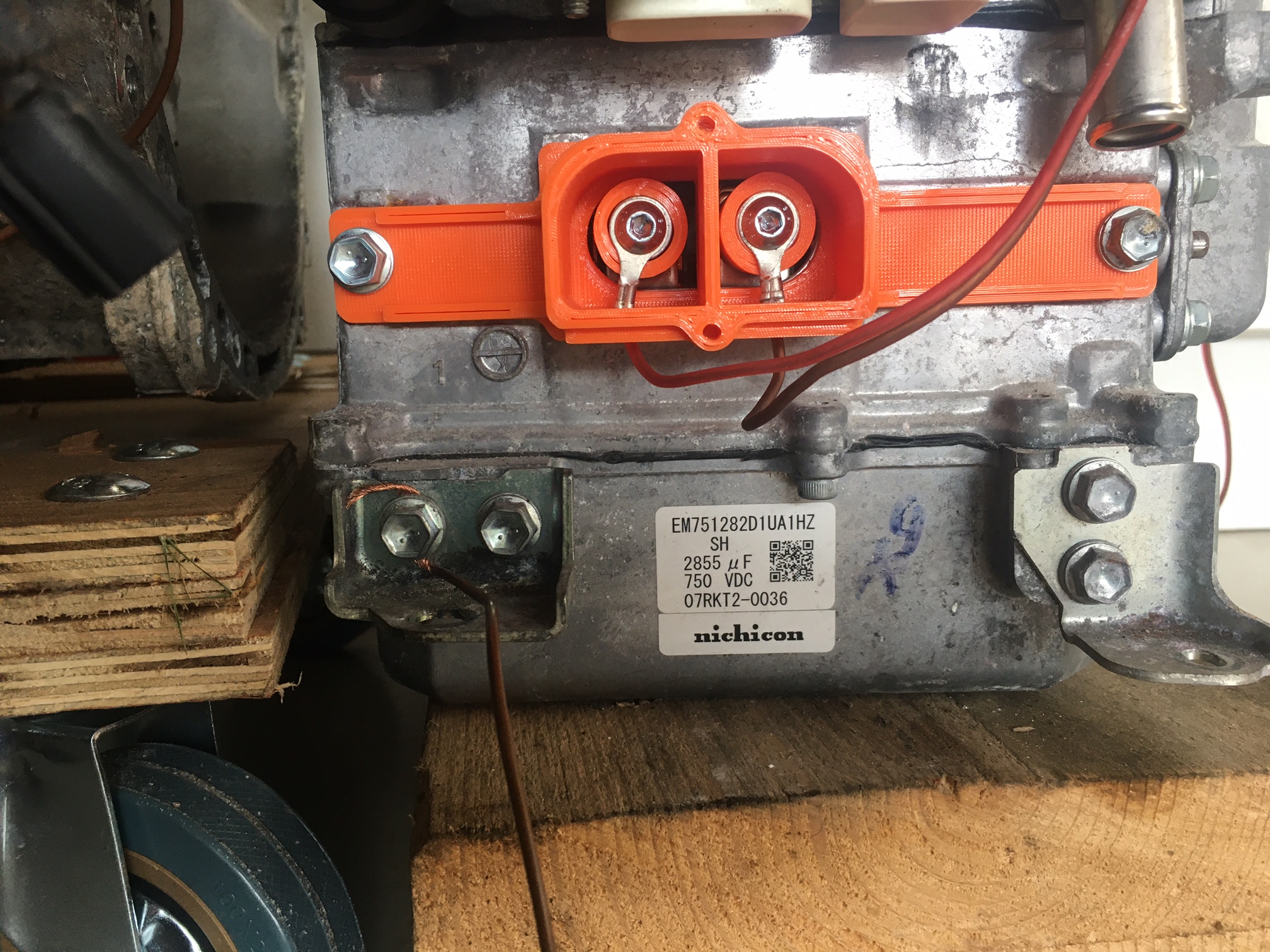

I think this has been done before. For my 24volt test rig, I needed a cover for the GS450 inverters high voltage connectors, so I printed this in orange PETG.
If you would like to do the same, the gcode files are attached.(you'll need to rename them from.txt to .gcode)
Now the disclaimer - you use the files and cover at your own risk.

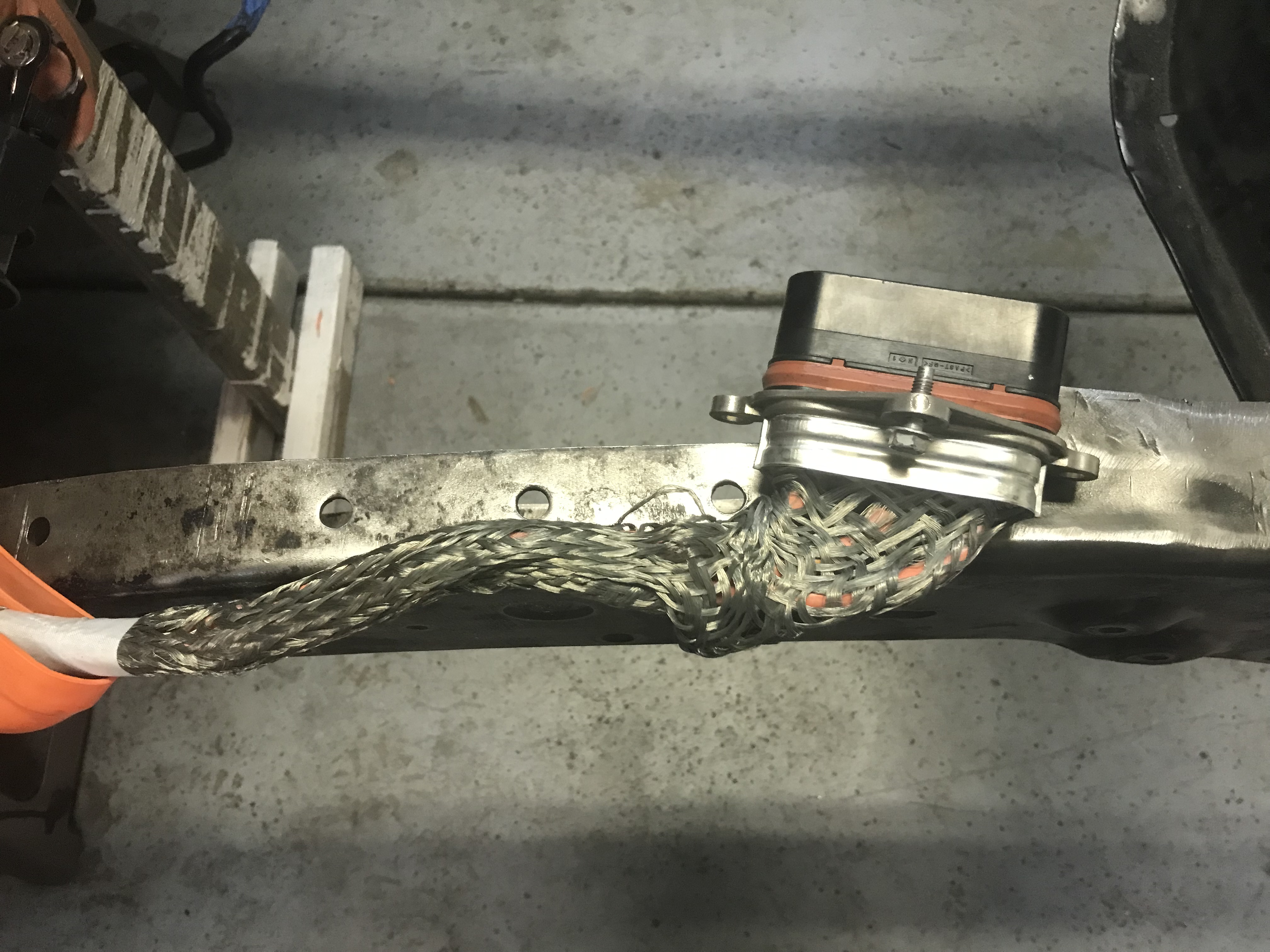

my GS450h transmission / inverter combo came with one of the high voltage orange cables with a nick in it, so I thought it would be a good time as any to unwrap it and see it's internal construction, thought I would share, I also hope to reroute one of them to go to the left from the inverter instead of both heading to the right
there were also two white zip ties inside the metal webbing helping it keep it's 90° shape
that's as far as I got with the transmission mocked up in the truck, I will unwrap more later

Yes, bearing limits on MG1 are a concern. My code will also have to monitor MG1 speed and I can apply negative torque to keep it within range. This will be an in-town car mostly, rarely getting up to highway speeds, so I may not ever see those rotational speeds.
For now, all I did in the code is set MG1 torque to zero right before the commands are sent to the inverter.
Interesting though, the flywheel effect of MG1 spinning down after accelerating to a constant speed generates regen while MG2 is consuming power (at least that what my amp meter is suggesting --- but as noted in my post, the meter is only reporting 10-12 amps under full acceleration, so it *has* to be wrong, right?).
*Lazy* is part of my excuse, too. But more than that, I did not want to have to replace the pump when it goes out. It's packed so tight in this little car I'd have to disassemble the entire battery pack to get to it. Plus, it's a shame to not use the more robust mechanical pump. I considered putting an electromagnetic clutch on the input spline so I could lock it up when I needed more power. But honestly, I can't put down any more power to the ground than MG2 will give. It's a monster.
My build is pretty simple, and lots of random "what I can find in the garage" parts. Happy to share any more details with you.

I’ve been playing with the software in mine lately, I’ve got only MG2 active until 20% throttle (to 50% of it’s available torque), then MG1 ramps up from 20-50% throttle while keeping MG2 constant, then they both ramp up together after 50% as the original firmware had them.
This keeps the car more efficient in most use cases where you’re in light throttle, using one motor at higher torque/efficiency versus two motors at lower torque/efficiencies. This also eliminated some gear lash noise I was getting around 20mph (~2k RPM).
Tuning the transition from one motor ramping to another forced me to roughly learn the torque/power split between the two. When MG2 is in second gear, MG1 provides approximately 50% more torque/power to the output shaft than MG2, assuming that torque commands are linear.
As MG2’s transmission is a 1.9:1 ratio (from memory, correct me if I’m wrong), that would put MG2 in First gear at 27% more torque/power than MG1.
Either way, MG1 makes a very significant contribution!

That's cool. In my case, all MG1 will be used for is priming the oil pressure and flywheel regen. A waste to be sure, but unless I beef up the rear end on this car and double the tire width, I would never be able to use the extra power!

Be mindful, with out powering MG1 it "may" be turning backwards as MG2 is spun up, along with turning the mechanical oil pump backwards. Running the electric pump would keep the system supplied in oil.Gregski wrote: ↑Mon Apr 25, 2022 2:36 pmthank you so much for your post, I intend to do the same for the following reasonsggeter wrote: ↑Mon Apr 25, 2022 2:23 pm I've got my 450h MG Midget running. Post here: viewtopic.php?p=39419#p39419
Of note in this thread: I am running w/o the input spline locked. Once underway, I don't need the pump since the internal mechanical pump is allowed to turn. At 1500 max torque setting in the VCU, this car is plenty fast enough on just the one motor. Will post code here as I intend to modify VCU to use MG1 to pre-charge the oil pressure at stop signs. Right now, I engage the pump to get rolling and then can turn it off once underway.
1. I am lazy and don't feel like locking out the input shaft (dumb, yes I know)
2. I wan to dyno the vehicle with just MG2 to see what horse power it truly puts out
3. keep the build very simple I also plan on running just a single BMW 530e (six cell module) 9 kWh battery pack to start
could you please check out the following comments on my build thread about how locking the input shaft can limit the top RPM

You’re a prime candidate for welding the planetary carrier!
