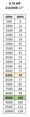

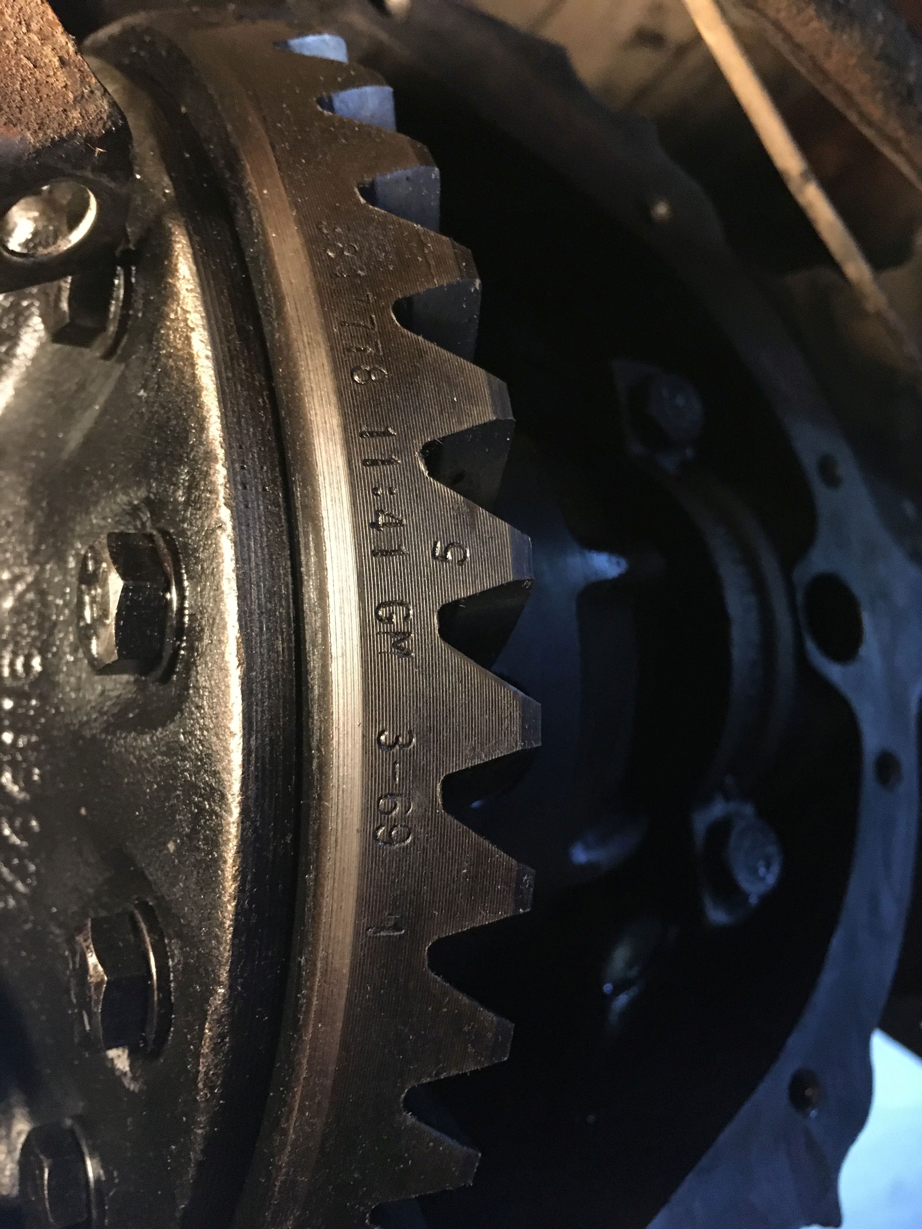

Since my 1971 Chevy truck aka GMC used a mechanical speedometer which I am ditching I plan on using MG2_Speed to calculate my miles per hour MPH
so I punched some numbers into the good ol' Lotus 1-2-3 (pronounced: Excel) ha ha to correlate RPMs to Miles Per Hour based on my 3.73 rear end and 215/65R-17 wheels
I relied on the good ol' folks at x-engineer.org to provide the complicated formulas, (and our daughter to recite pi to the 57th digit):

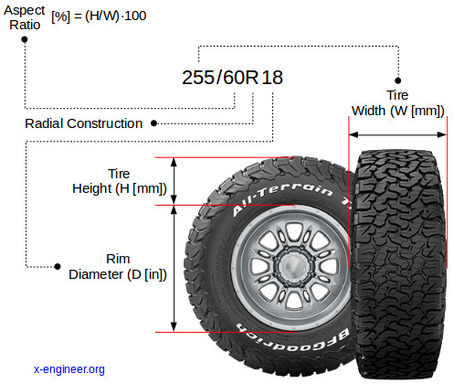

How to calculate wheel and vehicle speed from engine speed
How to calculate wheel radius

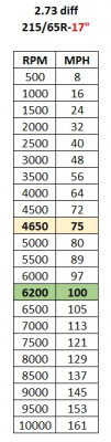

Re: Lexus GS450h RPM vs MPH Speedometer
this made me consider Taller / higher differential gears like the 2.73 for my GM 12 bolt to drop the RPMs by approximately 2 grand, I'm pretty sure (97.1%) that electric motors don't have a traditional Power Band, so did the "Royal We" determine at what RPMs this Unicorn is most happy happy?
and let's not forget how simply changing our tire aka wheel size can impact RPMing and MPHing
below I use the exact same tire profile on three different size rims 16", 17", and 18"

Don't forget to account for the gear reduction from MG2 speed.

is it 1.900 ?PatrcioEV-ATX wrote: ↑Wed Dec 08, 2021 6:22 pmDon't forget to account for the gear reduction from MG2 speed.

Yes, these are the pieces of my mph calc, though others have done it slightly differently:
float speedCalc;
int tireRpm=737; //revolutions per mile for tire size
int MPH;
float diff=3.31; //your diff ratio
void Calc_MPH()
speedCalc=((abs(mg2_speed/1.9))/diff);
MPH=((speedCalc*60)/tireRpm);

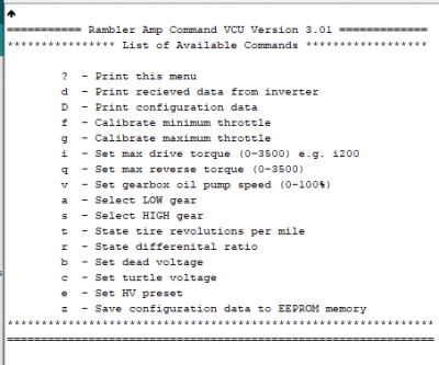

I even added tire RPM and rear diff (since I’m not entirely sure what mine is) to the serial menu for easy updating.xp677 wrote: ↑Sat Dec 11, 2021 12:49 pm I covered this a while back in another thread: viewtopic.php?f=14&t=396&p=32431#p32431

I'm not sure this is the right place to ask, but does anyone have a way for a simpleton to work out my expected top speed etc?
(ie a formula rather than code please?)
The rear diff on my Reliant Scimitar is 3.58.1 and I'm wondering if I'll need to change that to use the GS450H transmission.

It's actually fairly simple...
(Motor RPM*60)/[trans ratio/final ratio tire revs/(mi or km)]
The word version: Motor turns per hour divided by the total gear ratio over tire revolutions per unit measure (miles or km) = Distance Per Hour

MG2 max speed is 10000rpm, divide by 1.9 which is the high gear internal ratio gives 5263rpm out the back of the transmission.
Divide by 3.58 gives 1470rpm at the wheels at top speed.
The Scimitar came with various tyre options, a common one was the 185 HR 14 tyre which has a diameter of 650mm, therefore a circumference of 2.04m.
Therefore, the distance travelled at full speed in one minute is 2.04m * 1470rev. Which is 3000.18 metres per minute, or 180 kilometres per hour.
180kph is 112mph.
