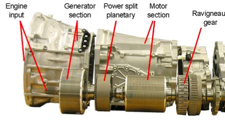

Kevin Sharpe wrote: Fri Mar 27, 2020 12:02 am People love to speculate but lets bring this thread back on topic and focus on Lexus GS450H VCU Support :)
Question, what is the solenoid pattern for low and high gear? I thought I read that Low/Low is high gear (and that is what is in the current code from Damien).
What is the feedback for PB1, 2, and 3?
Dilbert
Posts: 410
Location: Dublin, Ireland
Re: GS450H Discussion
Post by Dilbert »
On the diagrams they show as 3 switches, I believe they are pressure switches for oil pressure.
slow67
Posts: 151
Location: Texas
Post by slow67 »
Dilbert wrote: Fri Mar 27, 2020 7:07 am On the diagrams they show as 3 switches, I believe they are pressure switches for oil pressure.
Right, but I was wondering if anyone deciphered which switch is active, and when. I have some guesses, but I won't have my plug for the solenoids/pressure switches until sometime next week so I can't test them.
Edit: Here are my guesses looking at the pictures of the valvebody (and my background on valve bodies):
PB2: High unless the electric pump is making pressure
PB3: High unless the mechanical pump is making pressure
PB1: Either High/low based on low or high gear, based on actuator feed pressure (pressure circuit the solenoids use to move the shift valve), or based on lube circuit pressure.
Im very certain TransSP is to control line pressure in the transmission (after the check valves for the 2 pumps).
If TransSL1 Low and TransSL2 Low = high gear, then most likely High/High is high gear. One of them is likely for brake 1, and the other for brake 2. We may need to time the the shift to prevent drag/flare.

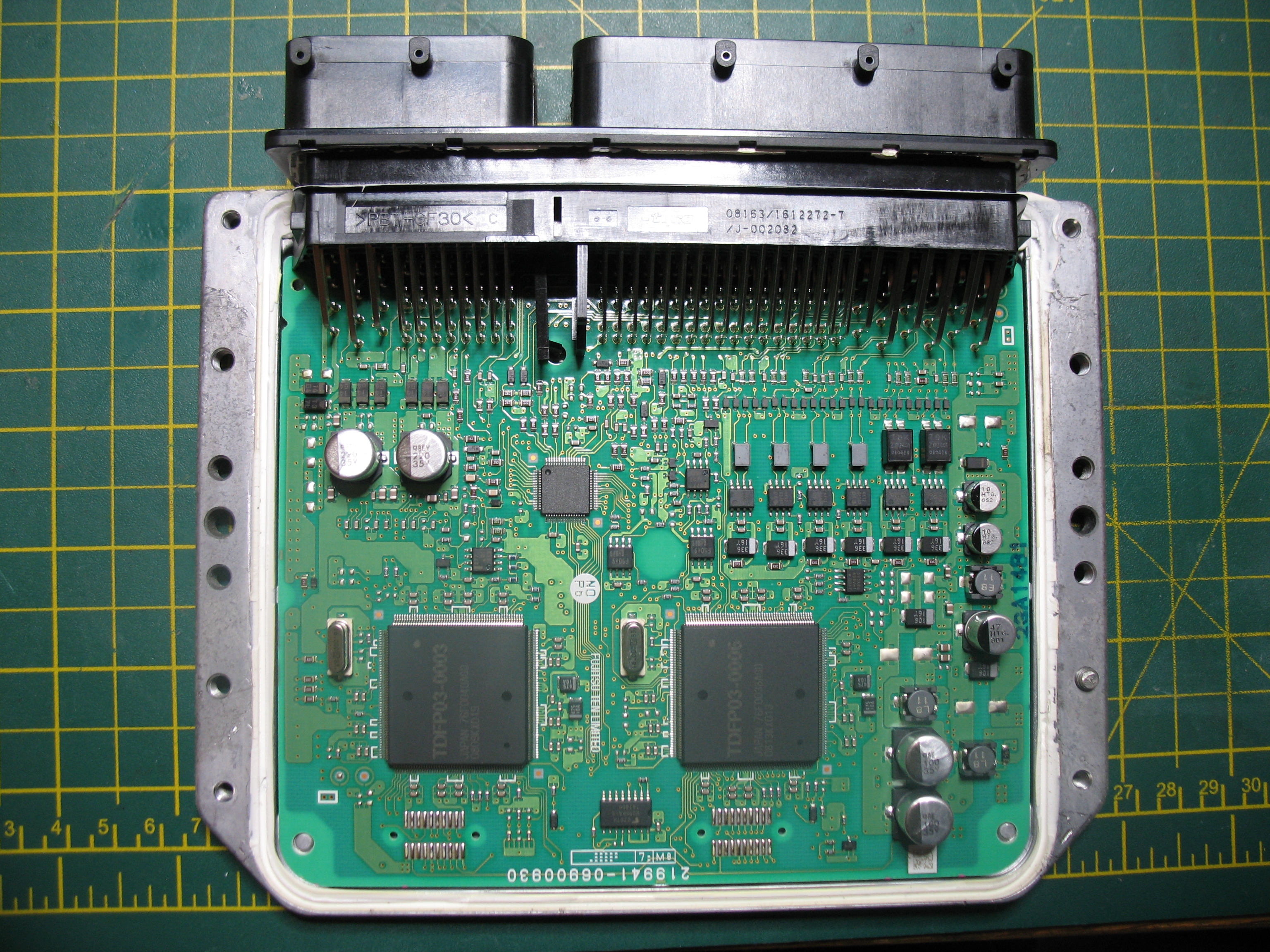

Do you happen to have the diagram of where the HV ECU is and which connector has the 5(PB3), 6(PB2), and 7(PB1) wires I need to tap into? I just took a quick look in between work and kids so I didn't want to take the whole dash apart.
Behind the glovebox
Beside the kick panel
xp677
Posts: 442
Location: UK
Been thanked: 15 times
Post by xp677 »
It's in the engine bay, just in front of the LH shock tower. Might be on the other side for LHD market but I don't think so.
Those wires are on connector B as shown in the wiring diagram. That is shown as E77 here. Again, LHD may be different, doesn't look like it for these wires from the diagram though.
