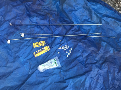

Post by Gregski »
then it was off to Ace Hardware (where they treat me like Norm on Cheers since I'm there every day) for some [ahem] hardware

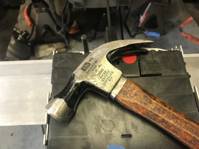

Post by Gregski »

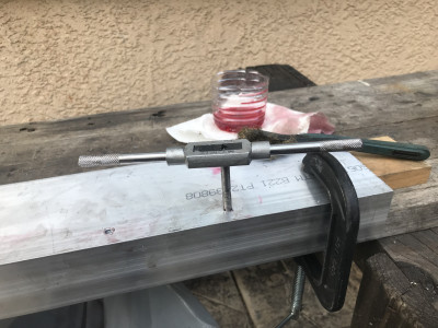

I love these ALMOST on center every time punches

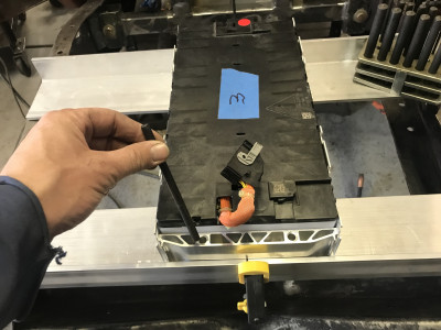

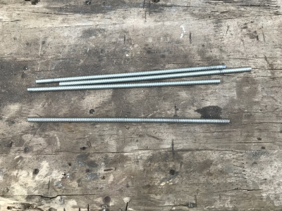

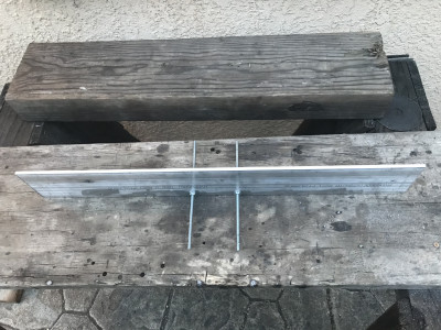

Post by Gregski »
Fun Level = 0
36" divided by 4 equals enuff sticks for 2 battery modules
Gregski
Posts: 3171
Has thanked: 635 times
Been thanked: 1611 times

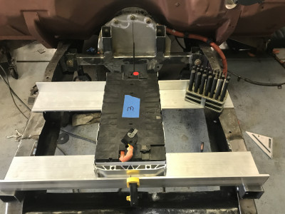

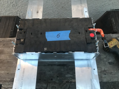

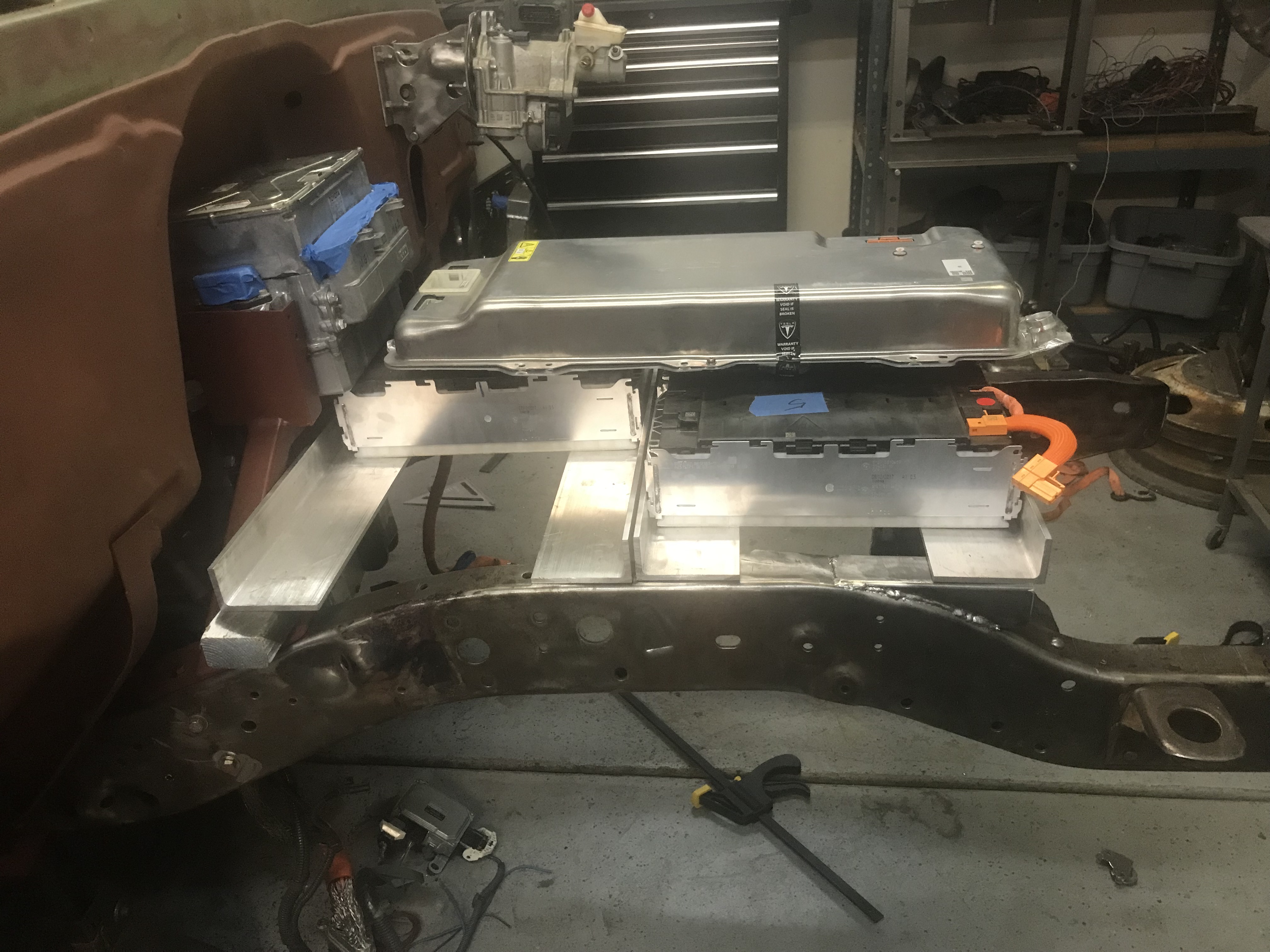

Post by Gregski »

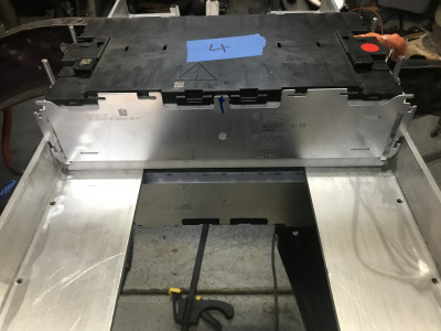

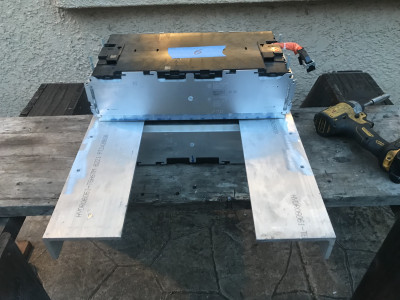

so one on top and one on the bottom, upside down, bat style
Gregski
Posts: 3171
Post by Gregski »
so this is the Oreo Cookie battery tray design, respectfully stolen from Sir Artur Kustusch
you know the saying: Good EV Converters borrow, Great ones steal!

Post by Ev8 »
Nice work, never even thought of mounting bmw modules upside down

Post by Gregski »
so here's a peak looksee what we are going for, I don't even know if that Tesla Model 3 battery charger / DC-DC converter combo unit [ahem, sorry Power Conversion System, PCS] is laying on there right side up or upside down, (you tell me, ha ha)
I am also entertaining shoving it under where the oil pan used to live there may be just enough of a cavity to bolt it up to the battery tray from underneath, for that German like impossible to get to to troubleshoot feel
