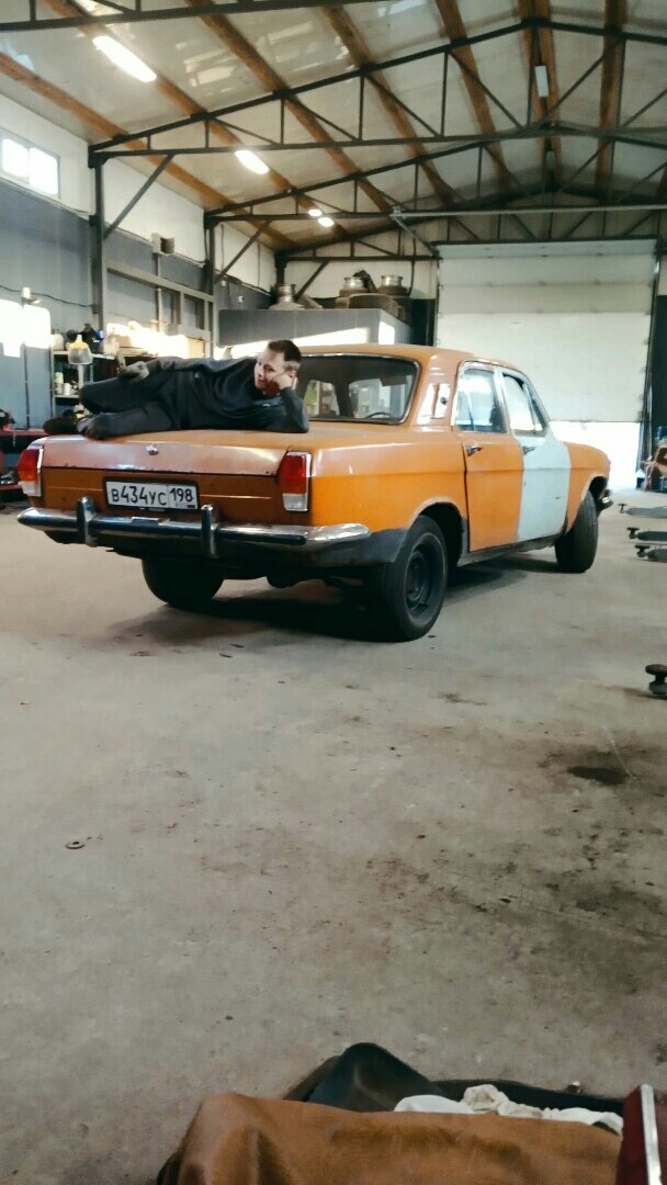

GAZ-24 Volga 1983г.
Post by Vijaya »
Hello dear friends.My name is Vadim,I'm from Russia.Please give me some advice where to buy me the simplest electricity and a motor to make it go? I don't understand anything yet. My compliments to yo

Been thanked: 1918 times
Re: GAZ-24 Volga 1983г.
Welcome, sexy photo :D
Cheapest option is probably Toyota Prius Gen2 inverter & transaxle plus a hybrid battery. We have some Russian speakers here who are using this.

The Volga is RWD so maybe easier with the GS450h gear? You could probably also make it the fastest (and scariest) Volga in the world, for about 3 minutes until the diff or driveshaft or something else only meant to only handle about 100hp breaks.

This is the best advice. The Volga is being built as the most terrible. Looking for a bridge from GS. Thank you very much.All Glory to you

gearbox from GS450h found.Now I'm looking for the driveshaft .But where do I get an electric motor and powerful batteries?

"gearbox from GS450h" is the electric motor, but check if you have with oil pump -it's commonly removed.
If you have one -change bearings.
https://openinverter.org/wiki/Motors

Thank you, dear Zilian.I wanted to say that I found a differential on the rear wheel for good speed. Now I'm looking for a driveshaft combined with a good gearbox and a separate good engine.
