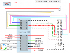

New SMT control board with enclosure and designated pinouts
Please add pictures and description.
Pin Mapping - Note : Smaller 12-pin socket is the interface to the inverter & 20-pin to the motor
20 - Pin socket
Pin#01 - ENC_B/S3
Pin#02 - S1S4
Pin#03 - ENC_A/S2
Pin#04 - R1
Pin#05 - R2
Pin#06 - 5V
Pin#07 - THROTTLE 1
Pin#08 - THROTTLE 2
Pin#09 - START_IN (12V)
Pin#10 - BRAKE_IN (12V)
Pin#11 - FORWARD_IN (12V) (3 way switch)
Pin#12 - REVERSE_IN (12V) (3 way switch)
Pin#13 - MTEMP -
Pin#14 - MTEMP +
Pin#15 - DCSW_OUT (Ground signal)
Pin#16 - PRECARGE_OUT (Ground signal)
Pin#17 - CAN L
Pin#18 - CAN H
Pin#19 - GND
Pin#20 - 12V
12 - Pin socket ( starts at pin number #21) - Corresponding pin on Main White 32 pin Inverter connecter is in brackets.
Pin#21 - GIVA (2)
Pin#22 - MIVA (7)
Pin#23 - GIWA (18)
Pin#24 - MIWA (23)
Pin#25 - VH (12)
Pin#26 - MIVT (26)
Pin#27 - MFIV (27)
Pin#28 - MUU (9)
Pin#29 - MVU (10)
Pin#30 - MWU (11)
Pin#31 - CPWM (13)
Pin#32 - GINV/GCNV (16/32)
Connect MSDN Pin#25 in inverter (not 25 on controller) permanently to 12V to enable the MG2 Inverter
Connect CPWM to 12V via a 470 Ohm resistor for charge mode.
Connect the 2-pole white power connector (inside inveretr) to 12V and Ground to power up inverter electronics.
