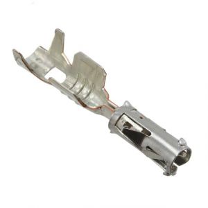

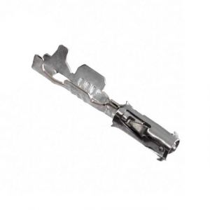

064323-1039 CP terminal 4
064323-1029 CP terminal 32
064325-1010 CMC plug 8
064325-1023 CMC plug 4
