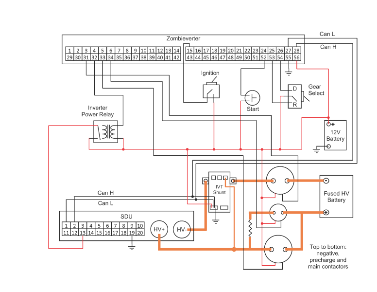

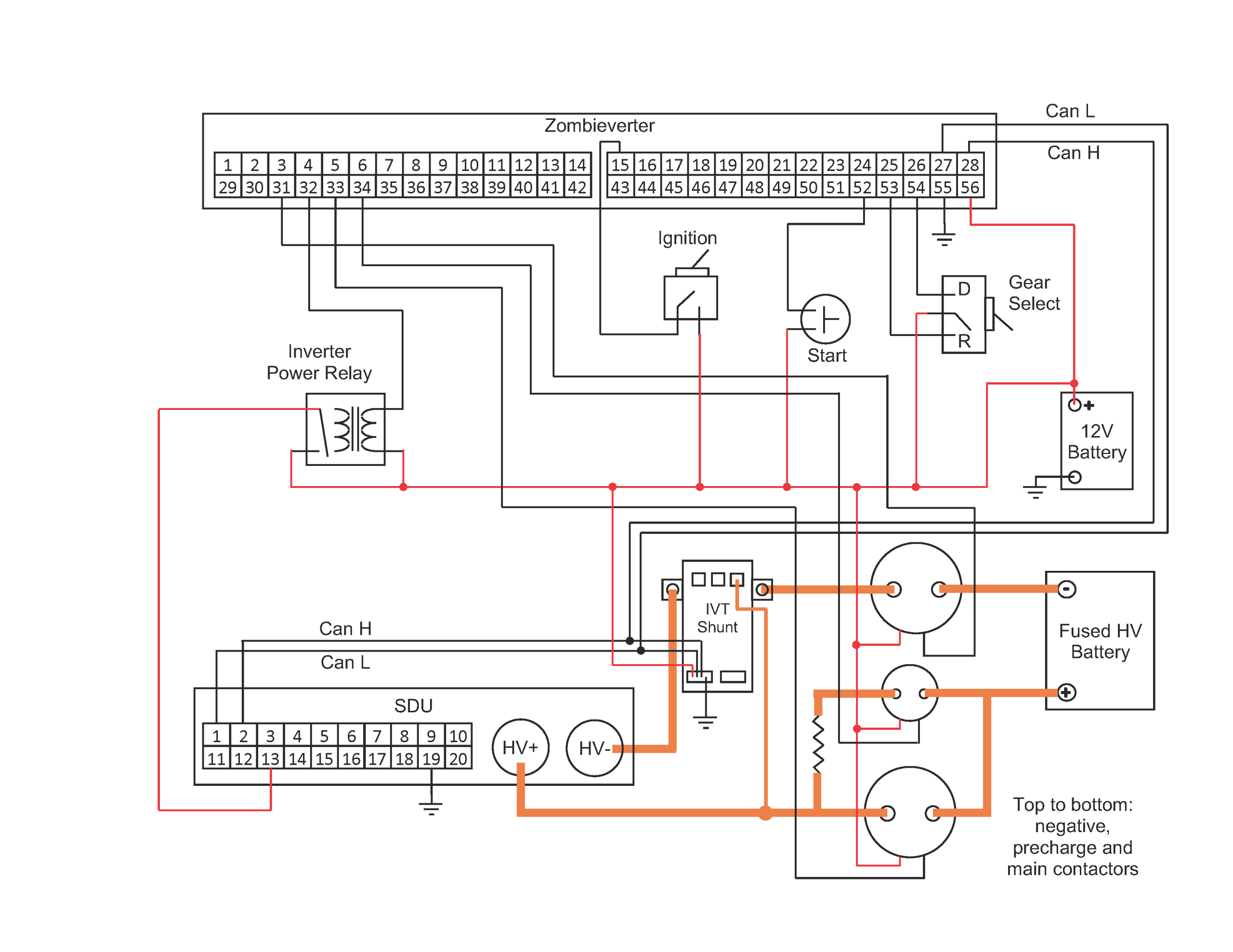

Tesla SDU with Zombieverter
current02:35, 1 February 2025Thumbnail for version as of 02:35, 1 February 20253,300 × 2,550 (72 KB)Steve16 (talk | contribs)Simplified diagram, all 12V powered deviced moved to permanent 12V
22:12, 13 December 2024Thumbnail for version as of 22:12, 13 December 20243,300 × 2,550 (71 KB)Steve16 (talk | contribs)
