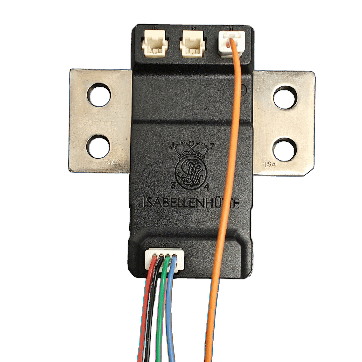

File:Isa connections CAN and U sense.png
Revision as of 16:48, 11 April 2024 by J0hannes (talk | contribs)
Original file (1,500 × 1,500 pixels, file size: 467 KB, MIME type: image/png)
A typical connection of the IVT-S Three voltage measurement terminals have two pins each. As they are internally shorted, it is irrelevant which pin is connected for voltage measurement. CAN and power supply: Pin a = Vcc, Pin b = CAN L, Pin c = CAN H, Pin d = GND
