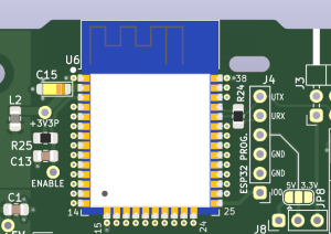

Programming the ESP32 Wi-Fi module
Solder jumper JP8 & J8 set the programming header voltage to either 5v or 3.3v. Use only 1 header to set the voltage to your programmer's output voltage.
If 5v is used the 3.3v regulator will convert it to 3.3v for the ESP32.
| Position | Description |
| 1 | IO0 |
| 2 | GND |
| 3 | GND |
| 4 | +3.3v / +5V, (J8 / JP8) |
| 5 | ESP32 USART_RX |
| 6 | ESP32 USART_TX |
Note that the enable line is broken out on the other side of the ESP32 if needed.
R25 and C13 are for boot delay to assist programming.
Follow instructions here **add link*
**add info about programming with the STM32 processor programmed already**
**add info about the boot delay** ESP32 boot delay R & C is set to the commonly recommended 10k resistor & 1uF in V0.0.1. Not sure how / why 4k7 / .1uF was chosen but can easily switch back.
