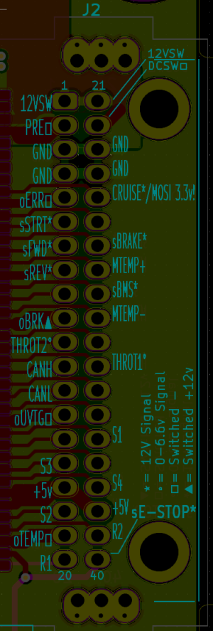

40 position Leaf connector modifications
If you are using the factory Leaf 40 position connector there are many open inverter specific wires that need to be added.
**add which pin numbers or mark them somehow in the table below**
40 position connector pin out:
The 40 position female housing has the following known part numbers:
Part # | Manufacturer Link | Sourcing | Found Where? |
1318389-1 | https://www.te.com/usa-en/product-1318389-1.html | https://octopart.com/1318389-1-te+connectivity-42270477?r=sp | |
2325415-1 | https://www.te.com/usa-en/product-2325415-1.html | https://octopart.com/search?q=2325415-1¤cy=USD&specs=0 | Listed as mating with 2322791-1 |

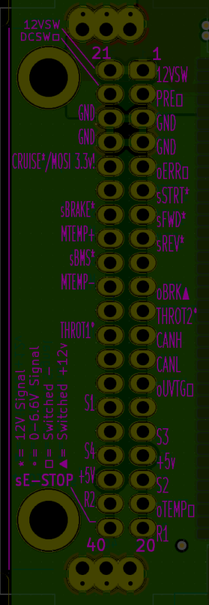

The adapter board is labeled at the 40 position connector to help with wiring up the inverter / harness. Images of these are to the right and a table is below with the positions in order.
The surface mount version of this connector starts with position 21, then 1, 22, 2, etc. The position labeling is offset slightly on both sides to help with this.
The pc board renderings / pin labeling can be used to help populate the connector and wire the vehicle.
Pos. | Abbreviation | Description | AKA | Details | Pos. | Abbreviation | Description | AKA | Details | |
1 | +12VSW | Switched +12v | 21 | +12VSW | Switched +12v | |||||
2 | PRE□ | Precharge contactor switched ground | 4.5 amps recommended to use an economizer | 22 | DCSW□ | EV battery contactor switched ground | 4.5A recommended to use an economizer | |||
3 | GND | Ground | 23 | GND | Ground | |||||
4 | GND | Ground | 24 | GND | Ground | |||||
5 | oERR□ | Output - Error signal, switched ground | 1 amp | 25 | CRUISE*/MOSI3.3v! | Cruise control signal 12v / MOSI 3.3v | 12v set as cruise. 3.3v as MOSI | |||
6 | sSTRT* | Input, 12v start signal pulse | 26 | empty | empty | |||||
7 | sFWD* | Input, 12v forward | 27 | sBRAKE* | Brake light input 12v | |||||
8 | sREV* | Input, 12v reverse | 28 | MTEMP+ | Motor temp senor + | |||||
9 | empty | empty | 29 | sBMS* | Battery Management System error +12 signal | |||||
10 | oBRK▲ | Output, brake +12v (see SJ4) | 1.5 amps | 30 | MTEMP- | Motor temp sensor - | ||||
11 | THROT2° | Throttle 2, 0-6.6v signal | 31 | empty | empty | |||||
12 | CANH | CAN high signal (see SJH1) | 120 ohm termination resistor solder jumpers | 32 | THROT1° | Throttle 1, 0-6.6v signal | ||||
13 | CANL | CAN low signal (see SJL1) | 120 ohm termination resistor solder jumpers | 33 | empty | empty | ||||
14 | oUVTG□ | optional output? 1amp max switched ground | 1 amp | 34 | empty | empty | ||||
15 | empty | empty | 35 | S1 | Encoder S1 wire | |||||
16 | S3 | Encoder S3 wire | 36 | empty | empty | |||||
17 | +5V | +5V for sensors (like throttle) | 37 | S4 | Encoder S4 wire | |||||
18 | S2 | Encoder S2 wire | 38 | +5V | +5V for sensors (like throttle) | |||||
19 | oTEMP□ | over temp signal, switched ground, 1 amp max | 1 amp, has EMI filter capacitor (C11) for PWM | 39 | R2 | Encoder R2 wire | ||||
20 | R1 | Encoder R1 wire | 40 | sE-STOP | Optional Emergency stop switch (see SJ5) | Can add an E-Stop switch to 12v. |
KEY |
* = 12v Signal |
° - 0-6.6v Signal |
□ = Switched ground |
▲ = Switched +12v |
