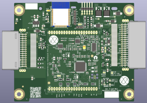

If you scanned the QR code on your gen 3 Leaf adapter board you are in the right place to help set it up!
This adapter board is compatible with Gen 3 Nissan Leaf (model year 2018+) inverters and the open inverter mini main board
This is a work in progress...

There are optional jumpers on both the adapter board and the mini mainboard.
Setting up the mini mainboard jumpers
SJ1 (mini mainboard back) enables a 500 ohm pull-up resistor that is needed for open collector encoders. In the case of the EM57 motor it **is / is not required**.
SJ3 (mini mainboard) soldered to the left is setup for cruise control 12v input. Soldered to the right is 3.3v MOSI for SPI communications. Do not apply 12v to this input while shorted to the right of the jumper or damage likely will result. In this case the 3 position solder jumper should be connected middle and the left and should arrive with a small copper trace between the 2.
Setting up the 3rd generation Leaf adapter board jumpers
SJ4 on the Leaf adapter board's lower right side is a shorted jumper. This jumper allows disconnecting the brake output circuitry from the board address circuitry for testing (see Mini Mainboard Hardware Detection.) This IO is shared between a board address and a brake light output. Once this is proven out there should be no need to change this jumper.
SJ5 Is an Emergency Stop (E-Stop) input to quickly, non-destructively, and safely shut down the inverter. To use an E-Stop function, cut the SJ5 jumper. To ignore the E-Stop functionality just leave the SJ5 jumper closed / shorted.
SJH1 & SJL1 connects the CAN high line to a resistor pair to provide a 120 ohm termination resistor if desired. These should be either both soldered or open only, not one open one closed. There is a capacitor in the middle of the 2x 60 ohm resistors to help filter noise on the CAN lines. There is also a TVS diode (D6) right next to the 40pos. connector for static protection.
