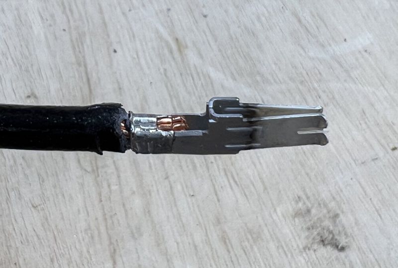

Molex 8 AWG open barrel terminal, modified by removing the rear insulation crimp section, then crimped using Pressmaster MCT and die 4300-3146, using the 10 AWG position.
