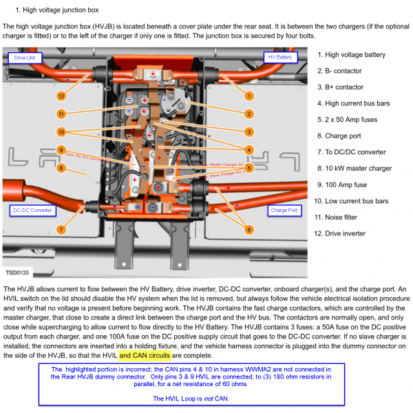

Tesla Model S GEN1 Rear HVJB component details, from Tesla Service Manual, "Theory of Operation" section.
current02:48, 27 March 2023Thumbnail for version as of 02:48, 27 March 20231,354 × 1,354 (1,011 KB)Asavage (talk | contribs)Annotated some of the diagram with fuse purposes, and added '-' & '+' to some wires and bus bars.
