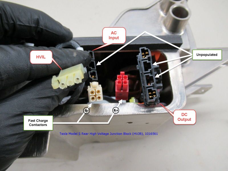

File:Tesla Model S Rear HVJB 04b.jpg
Revision as of 16:23, 24 March 2023 by Asavage (talk | contribs) (Asavage uploaded a new version of File:Tesla Model S Rear HVJB 04b.jpg)
Original file (1,600 × 1,200 pixels, file size: 275 KB, MIME type: image/jpeg)
Tesla Model S Rear HVJB: Single/Master OBC interface connectors. All (5) of these are in use for the Single/Master OBC; only the AC and DC connectors are in use for a Second/Slave OBC (no HVIL or Fast Charge Connectors are used for the Second/Slave OBC).
current16:23, 24 March 2023Thumbnail for version as of 16:23, 24 March 20231,600 × 1,200 (275 KB)Asavage (talk | contribs)Added Fast Charge contactors connectors' HV polarity (B+, B-), matching "Theory of Operation" documentation.
