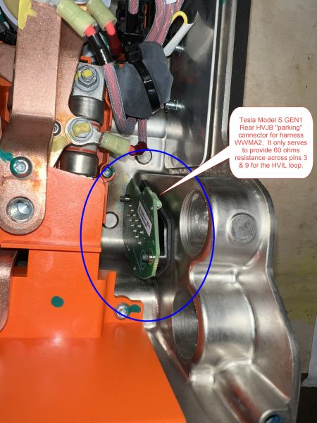

Telsa Model S GEN1 Rear HVJB: rear views of harness WWMA2 "parking" connector which contains only a 60 ohm resistor.  This connector is used when a Tesla does not have a Second/Slave OBC.
