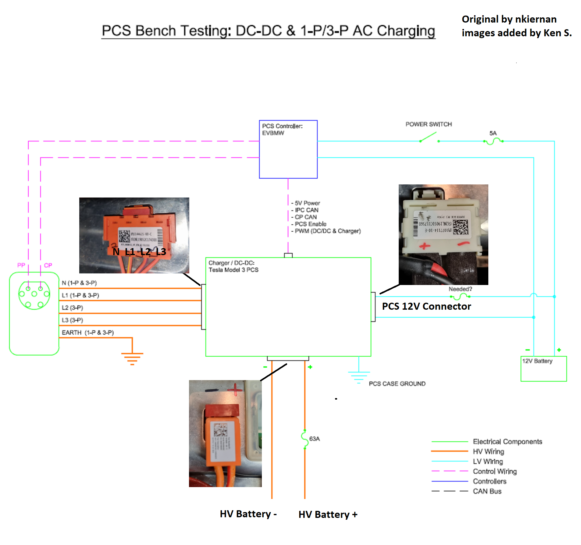

File:Tesla PCS Connection diagram 8162022.png
Revision as of 16:34, 22 August 2022 by Ken S (talk | contribs)
Original file (1,906 × 1,788 pixels, file size: 692 KB, MIME type: image/png)
Basic wiring diagram for using the Tesla PCS
