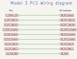

Data Connector on PCS (12-way)
EDITOR'S NOTE: my research shows some conflicting/different part numbers mentioned - would appreciate some clarification here once validated
As per: https://openinverter.org/forum/viewtopic.php?p=26614#p26614
The connector used for communications with the PCS: [2][3]
Pins: [4]
In true Muskian fashion it seems they use the 1379662-5 natural color variant of the plug which has no coding tabs. It is of course unavailable from mouser. The black and green variants are functionally identical and should work with coding tabs removed.
However, as per: https://github.com/muehlpower/EV-FFB, there is also mention of 1318774-1 (white) or 1318774-2 (black) for the comms/data connector.

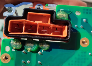

Power Connectors
The power-side connector assemblies are not widely available. The housings are a Tesla internal part (photos/part numbers here), however, 3D printable housings have been made available here. The terminals also aren't widely available, but are known. As per https://github.com/muehlpower/EV-FFB:
Note: the US variant of the charger (1-phase) has a different AC pin layout; see photo for reference.
The contacts for 400V are Uni F630 from MTA, part number 1107940. For 12V Kostal PLK 14.5, part number 23124734300. The connector for the data is from TE connectivity, part number 1318774-1 for white or 1318774-2 for black.

The minimum wiring needed to wake the PCS:
- PCS controller connected to PCS via 12-way X420
- PCS controller is powered via 20-way +12V input pin and grounded to chassis via 20-way ground pin
- +12v and Chassis ground applied to PCS 12v Connector input terminal
- Chassis ground on the PCS case
