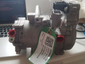

Mitsubishi Outlander AC Compressor
The Outlander PHEV has a CAN bus controller AC compressor.
Weight 6.2kg
Length
Height
Width
Low Voltage Connection
The mating connector is Sumitomo 6189-0126 https://www.auto-click.co.uk/6189-0126?search=90980-10942 and the pinout is the same as the water heater. Connector also available cheap on aliexpress.
1 - 12v, 2 - GND, 3 - CAN H, 4 - CAN L
