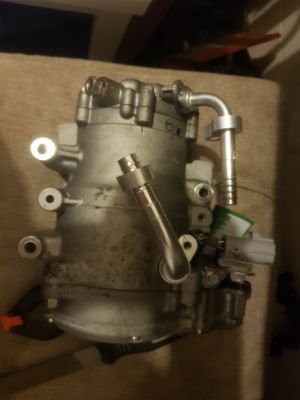

Connections

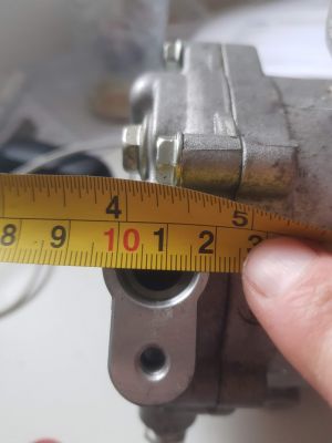

Refrigerant Connections
The part numbers for the Mitsubishi hoses are AMD45418, AMD46168. Unconfirmed, but thought that these fit https://www.evcreate.nl/shop/airconditioning/adapter-set-airconditioning-compressor/ The correct fitments on Aliexpress
Outlander compressor hose connections
https://www.aliexpress.com/item/1005001688953296.html R134 4 curved and R134 5 curved was what I ordered, so 11.5mm and 14mm.

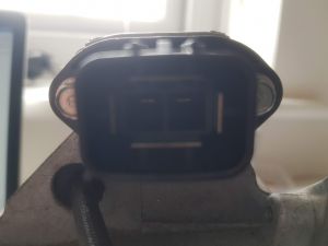

Low Voltage Connection
The mating connector is Sumitomo 6189-0126 https://www.auto-click.co.uk/6189-0126?search=90980-10942 and the pinout is the same as the water heater. Connector also available cheap on aliexpress.
1 - 12v, 2 - GND, 3 - CAN H, 4 - CAN L

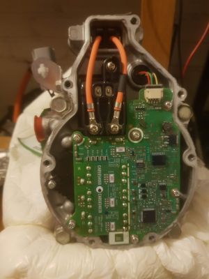

High Voltage Connection
The compressor is connected with a 40amp fuse to high voltage. Older models don't have the HV socket as shown above, but have the wire attached. Polarity is the same as the heater.
Newer models have a socket. [Place holder for part number]
HV connector. Left is negative, right positive.
AC compressor driver board.
