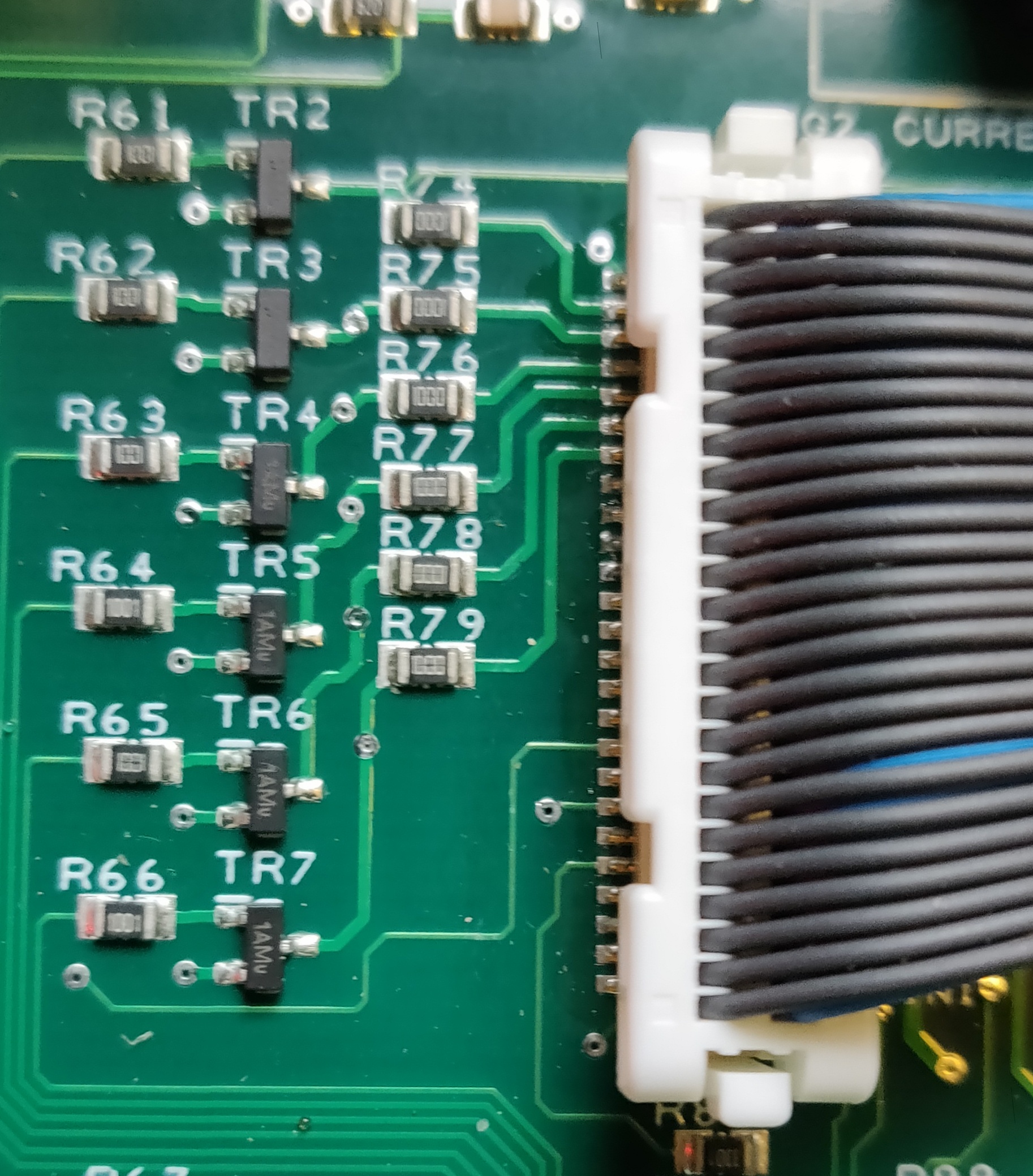

Partial shot of the 50 pin connector showing the location of the resistors which can be used as test points to check for the PWM signal on MG2 A/B/C Hi / Low.
