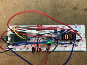

Prototype CAN SoC display
This is a CAN bus state-of-charge meter based on a Teensy 4.0. Teensy's aren't the cheapest boards (an STM32 is a tenth of the price), but they are tiny, have on-board CAN and are very easy to develop for.
It displays a state-of-charge or voltage value according the integer number sent over CAN bus to the configured address(es)
SoC values between 0 and 1000 will be displayed as " 0.0" to "100 ". The display flashes " 0.0" when it reaches zero. Anything else (or no data) will be displayed as "----"
Voltage values between 1 and 999 will be displayed as " 1V" to "999V ". Anything else (or no data) will be displayed as "---V"
A touch sensor allows you to toggle the display between SoC and voltage.
It includes automatic night time dimming.

Wiring
Teensy 4.0 connections
Follow the Teensy 4.0 connection schematic
  1. Connect the CAN transceiver to Teensy 3.3V, GND, CRX2 and CTX2
  2. Connect the LED D1, D2, D3 and D4 digit pins to Teensy 5, 4, 3, 2
  3. Connect the LED a, b, c, d, e, f, g and DP segments to Teensy 16, 17, 18, 19, 20, 21, 22, 23 via 220R resistors
  4. Connect the Photocell to Teensy 3.3V and A0. Connect A0 to GND via a 10k resistor and 47uF capacitor in parallel.
  5. Connect the Touch Switch to Teensy 3.3V, GND and 15
You'll need suitable 12V -> 5V power supply for automotive use. For development, it'll work fine off 5V USB.

Try it out!
Compile and upload the code to your Teensy board. The code isn't very complicated, so I set mine to run at 150MHz.
If you send CAN data to the specified node ID, the display should spring into life.
<YouTube></nowiki>https://youtu.be/s-Gadj3Rnxw<nowiki></youtube>
