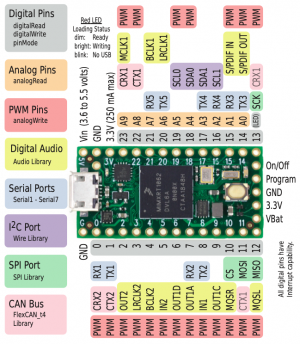

Wiring
Teensy 4.0 connections
Follow the Teensy 4.0 connection schematic
  1. Connect the CAN transceiver to Teensy 3.3V, GND, CRX2 and CTX2
  2. Connect the LED D1, D2, D3 and D4 digit pins to Teensy 5, 4, 3, 2
  3. Connect the LED a, b, c, d, e, f, g and DP segments to Teensy 16, 17, 18, 19, 20, 21, 22, 23 via 220R resistors
  4. Connect the Photocell to Teensy 3.3V and A0. Connect A0 to GND via a 10k resistor and 47uF capacitor in parallel.
  5. Connect the Touch Switch to Teensy 3.3V, GND and 15
You'll need suitable 12V -> 5V power supply for automotive use. For development, it'll work fine off 5V USB.
