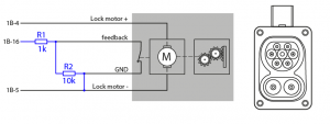

Charge port lock
Only important for type 2 (3-phase) charge ports.
In the i3 a quite expensive Phoenix CCS charge port is used and it would be nice to be able to use the cheaper Duosida CCS charge ports.
The charge port lock should work with the Duosida lock as well but the feedback (1k unlocked, 11k locked) is a bit different which requires some additional resistors.
CCS inlet lock
