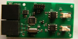

4-cell BMS
alt=4-cell module|thumb|4-cell module
The 4-cell BMS owes its name to the fact that every cell module can monitor and balance up to for Lithium cells. Depending on the populated resistors it can be used for LiFePO4 (3.3V) or NMC (3.7V) cell chemistries.
Its features are:
- High resolution (1mV) voltage measurement around the typical cell voltage 3.1-3.4 for LFP, 3.6-4V NMC
- Low resolution (10mV) voltage measurement outside the typical cell voltage
- Low resolution (+/- 5°C) cell group temperature (sensor embedded in controller)
- 20mA balancing current via a 2.4V (LFP) or 3.3V(NMC) LED. This prevents full cell drain in case of faults in the balancing software or circuitry
- 2mA balanced cell drain during operation
- 50µA balanced cell drain in sleep mode
- 1-wire bit-length-encoded current mode communication
The communication is terminated/translated via an isolator module. It translates the "proprietary" 1-wire protocol to a standard protocol, currently RS485. Its output connects the the first cell-groups positive terminal via a 1k resistor (Pin 3 of the 4-cell module) and the communication input. Its input connects to the last cell groups positive terminal, also via 1k resistor and the communication output.
All communication that goes into the first module is forwarded in a daisy-chain manner out to the last module. Each cell module can see the communication stream of the modules BEFORE it but not the modules after it. Exception: address mode, discussed below.

Isolator Command line interface
As already known from the inverter the isolator is controlled via a simple command line interface to carry out above operations. Since there can be more then 1 isolator on the RS485 bus each isolator is automatically assigned an address that has to be supplied to each command. This results in a hierarchical bus structure where the 1st module on the 1st isolator has address "1.1" and the yth module on the xth isolator has address "x.y". Com speed is 115200.
