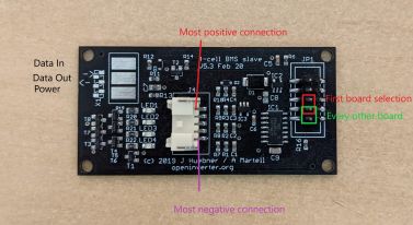

4-cell BMS
v5.3 slave board with annotations
The 4-cell BMS owes its name to the fact that every cell module can monitor and balance up to for Lithium cells. It can be used for LiFePO4 (3.3V) or NMC (3.7V) cell chemistries.
Its features are:
  • High resolution (1mV) voltage measurement around the typical cell voltage 3.1-3.4 for LFP, 3.6-4V NMC
  • Low resolution (10mV) voltage measurement outside the typical cell voltage
  • Low resolution (+/- 5°C) cell group temperature (sensor embedded in controller)
  • 20mA balancing current via a 2.4V (LFP) or 3.3V(NMC) LED. This prevents full cell drain in case of faults in the balancing software or circuitry
  • 2mA balanced cell drain during operation
  • 50µA balanced cell drain in sleep mode
  • 1-wire UART current mode communication, 10kbit/s
  • Very low cost due to generic component use and low component count

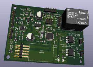

BMS Master Unit
BMS Master Unit
The communication is terminated/translated via at the master module. Its output connects the the first cell-groups positive terminal via a 220 Ohm resistor (Pin 3 of the 4-cell module) and the communication input. Its input also connects to the last cell groups positive terminal and the communication output.
All communication that goes into the first module is forwarded in a daisy-chain manner out to the last module. Each cell module can see the communication stream of the modules BEFORE it but not the modules after it. Exception: address mode, discussed below.
The master unit has two CAN busses that can be used for system integration. It continuously estimates vital parameters like SoC and SoH, calculates power limits etc. In electric vehicles it can control fuel gauges via a 2 channel analog output. Finally a relay can be used for basic charge or discharge control.
