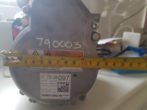

The Outlander PHEV has a CAN bus controller AC compressor. One thing to note, your old system components will likely need flushing of the old oil as it's damaging to compressor motor wiring lacquer. It can cause shorts. When getting your system refilled, it needs to contain compatible lubricating oil, POE MA68EV is listed in the manual, likely the same as other hybrids/electric cars.
Weight | 6.2kg |
Length | 19cm |
Height | 20cm |
Width | 12cm |
3D scans are here: https://grabcad.com/library/outlander-phev-ac-compressor-1 this appears to be of an older model than the one in the photos below. The photos are from a 2018 model year vehicle.
Refrigerant Connections
The part numbers for the Mitsubishi hoses are AMD45418, AMD46168. Unconfirmed, but thought that these fit https://www.evcreate.nl/shop/airconditioning/adapter-set-airconditioning-compressor/ The correct fitments on Aliexpress

Low Voltage Connection
The mating connector is Sumitomo 6189-0126 https://www.auto-click.co.uk/6189-0126?search=90980-10942 and the pinout is the same as the water heater. Connector also available cheap on aliexpress.
High Voltage Connection
The compressor is connected with a 40amp fuse to high voltage. Older models don't have the HV socket as shown above, but have the wire attached. Polarity is the same as the heater.
Newer models have a socket. [Place holder for part number]
