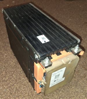

The Pack in the Volvo V60 D6 consists of 10 modules etch make up of 10 cells.
The Pack in the Volvo V60 D6 consists of 10 modules each made up of 10 cells.
The cells are Li_ion pouch cells with 32.5Ah of capacity. Making the modules 37V with a capacity of 1.2kWh
The cells are Li_ion pouch cells with a capacity of 32.5Ah. Making the modules 37V with a capacity of 1.2kWh

The Pack in the Volvo V60 D6 consists of 10 modules each made up of 10 cells. The cells are Li_ion pouch cells with a capacity of 32.5Ah. Making the modules 37V with a capacity of 1.2kWh
The BMS satellite module: LG calls them "Cell Voltage Temperature Node (CVTN).

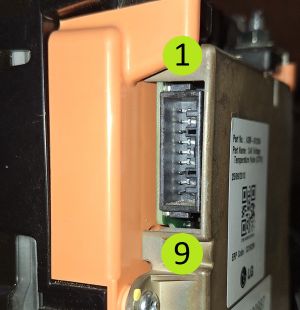

External connector (9 pin):
Pin 1 = +12V ('rough vehicle 12V', switched by the BMS master, not regulated) Pin 2 = CAN-L Pin 3 = CAN-H Pin 4 = Digital input (internally 50K pulled up) Pin 5 = GND (only first slave has this pin connected to the master, guess for some kind of 'first slave present' detection) Pin 6 = Digital output (open collector with 1K in series) Pin 7 = GND Pin 8 = CAN-L (parallel to pin-2) Pin 9 = CAN-H (parallel to pin-3)

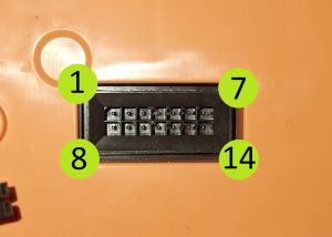

Internal connector (14 pin):
Pin 1 = Cell 1 positief Pin 2 = Cell 1 negative Pin 3 = Cell 1 negative Pin 4 = NC Pin 5 = Cell 10 positief Pin 6 = Cell 10 positief Pin 7 = Cell 9 positief Pin 8 = Cell 2 positief Pin 9 = Cell 3 positief Pin 10 = Cell 4 positief Pin 11 = Cell 5 positief Pin 12 = Cell 6 positief Pin 13 = Cell 7 positief Pin 14 = Cell 8 positief
