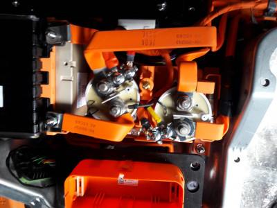

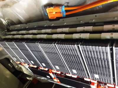

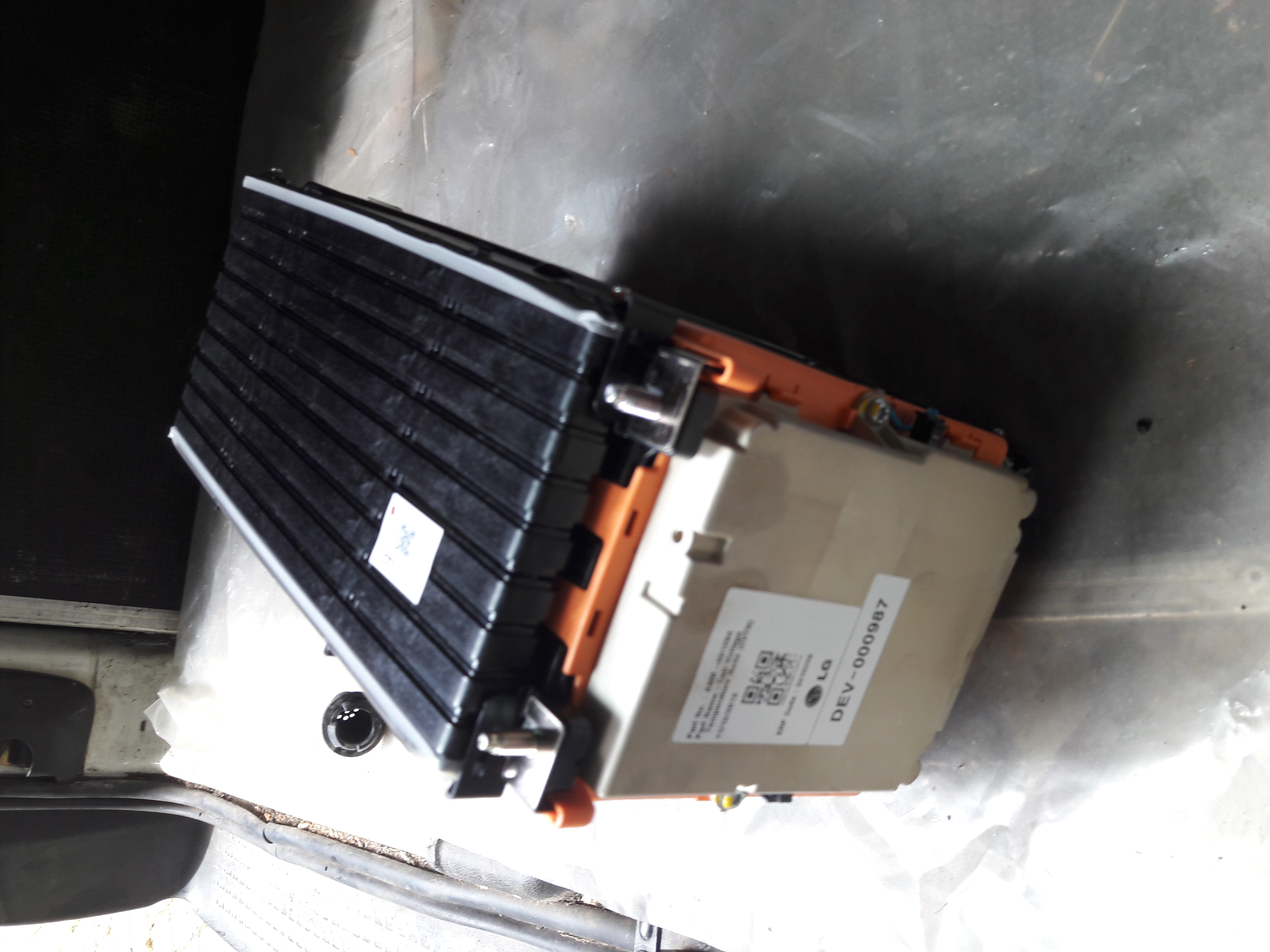

Hej all,
I recently bought a Volvo V60 hybrid battery pack, and since I did not find any info online, I decided to share some pictures and basic findings:

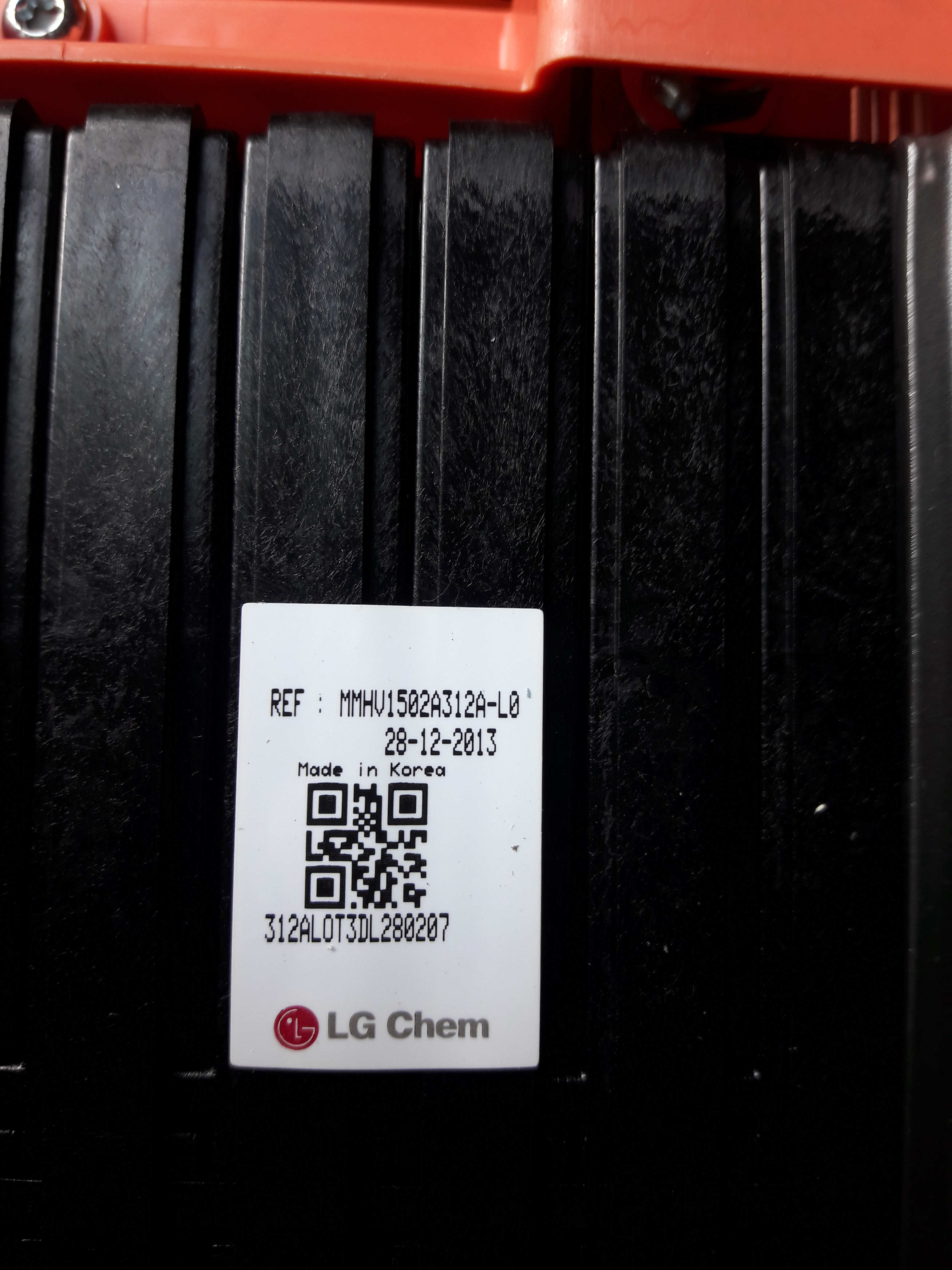

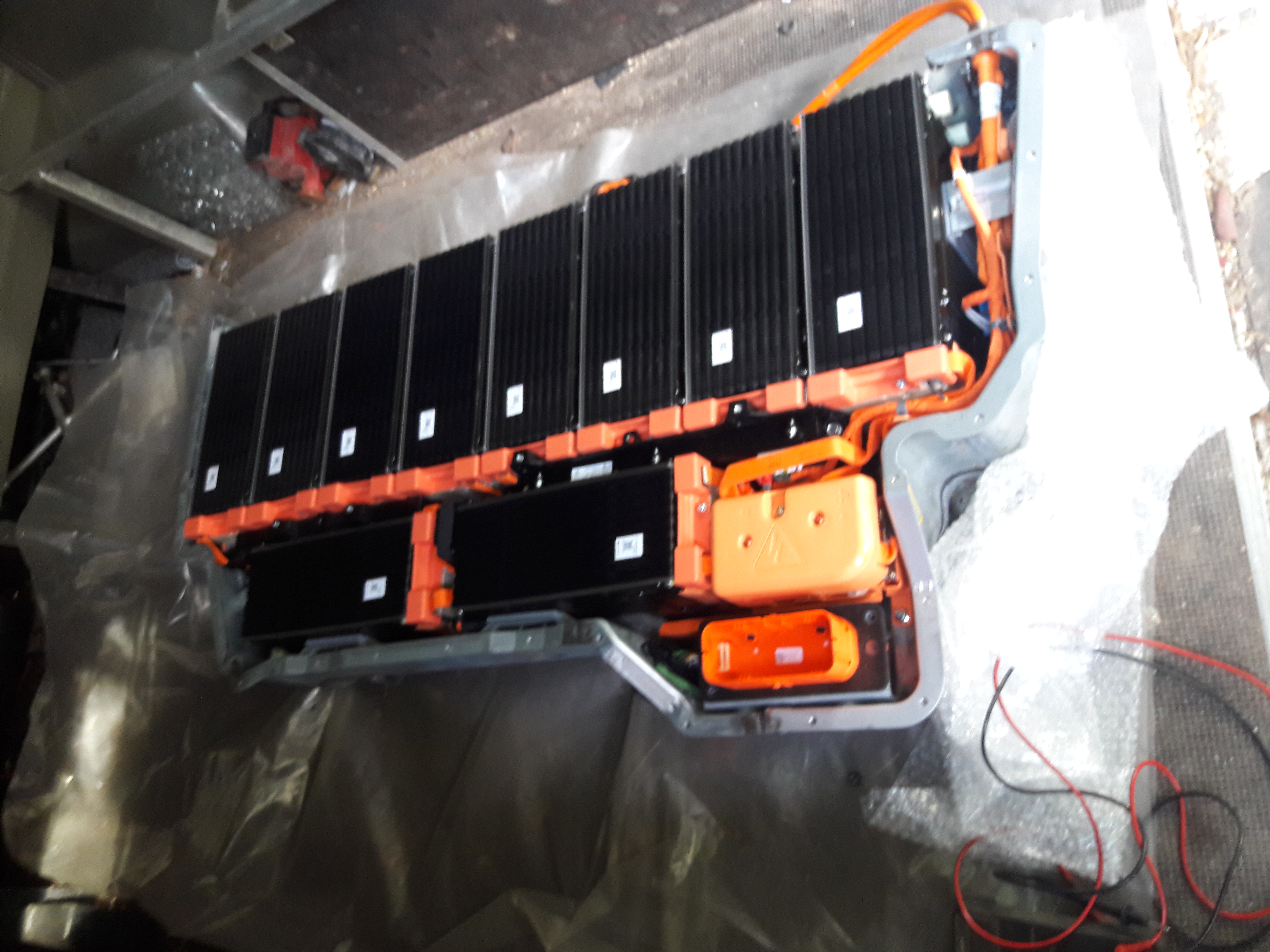

- The Li-ion battery pack is advertised as a 12 kWh pack, and estimating from my first charge, it seems to hold about 10-11 kWh (pack is from 2013).

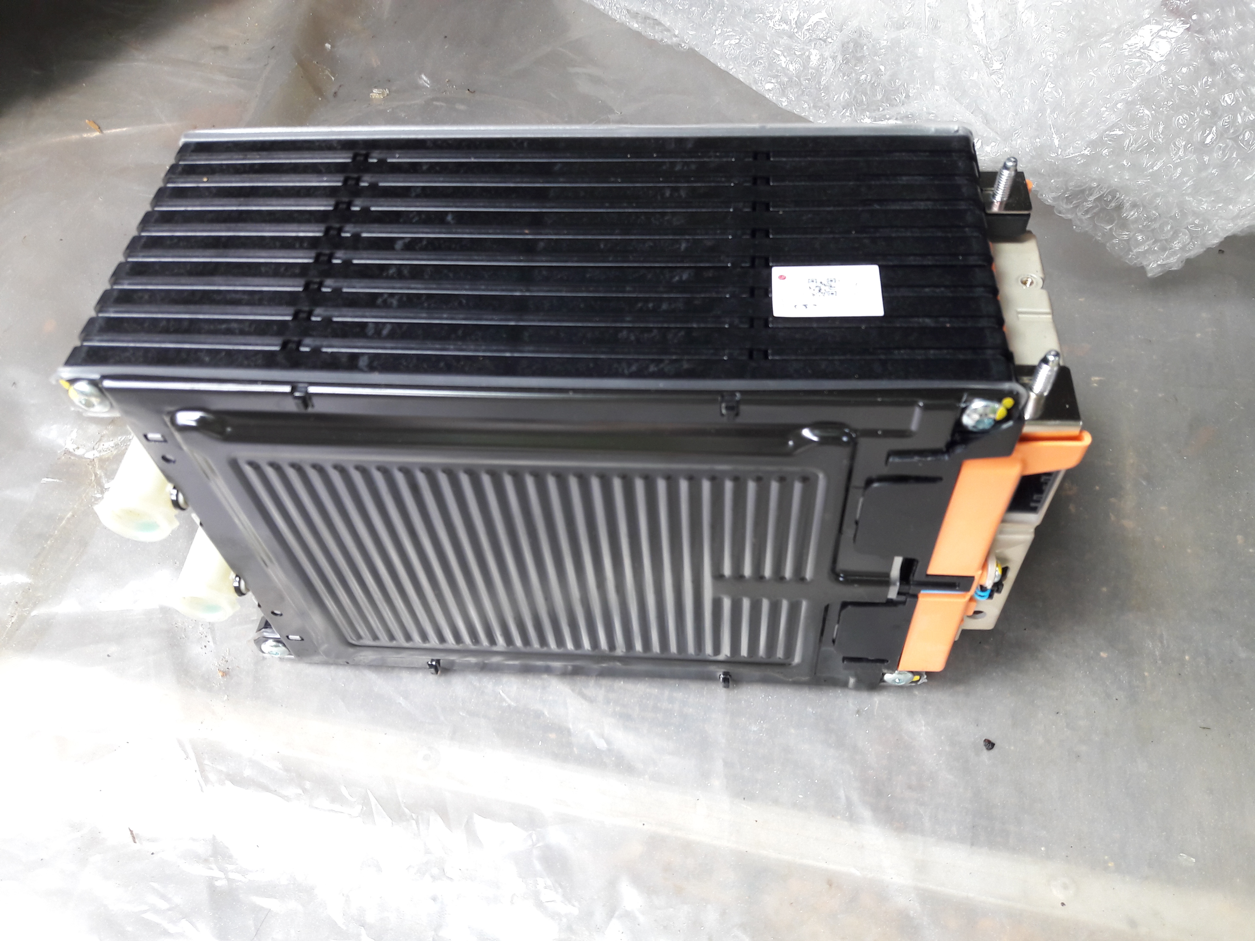

- Each (LG Chem) battery block is built in a 10s configuration, and there are 10 of those, making it 370 V nominal voltage.
- The approximate cell block size is: 120x310x185 mm.

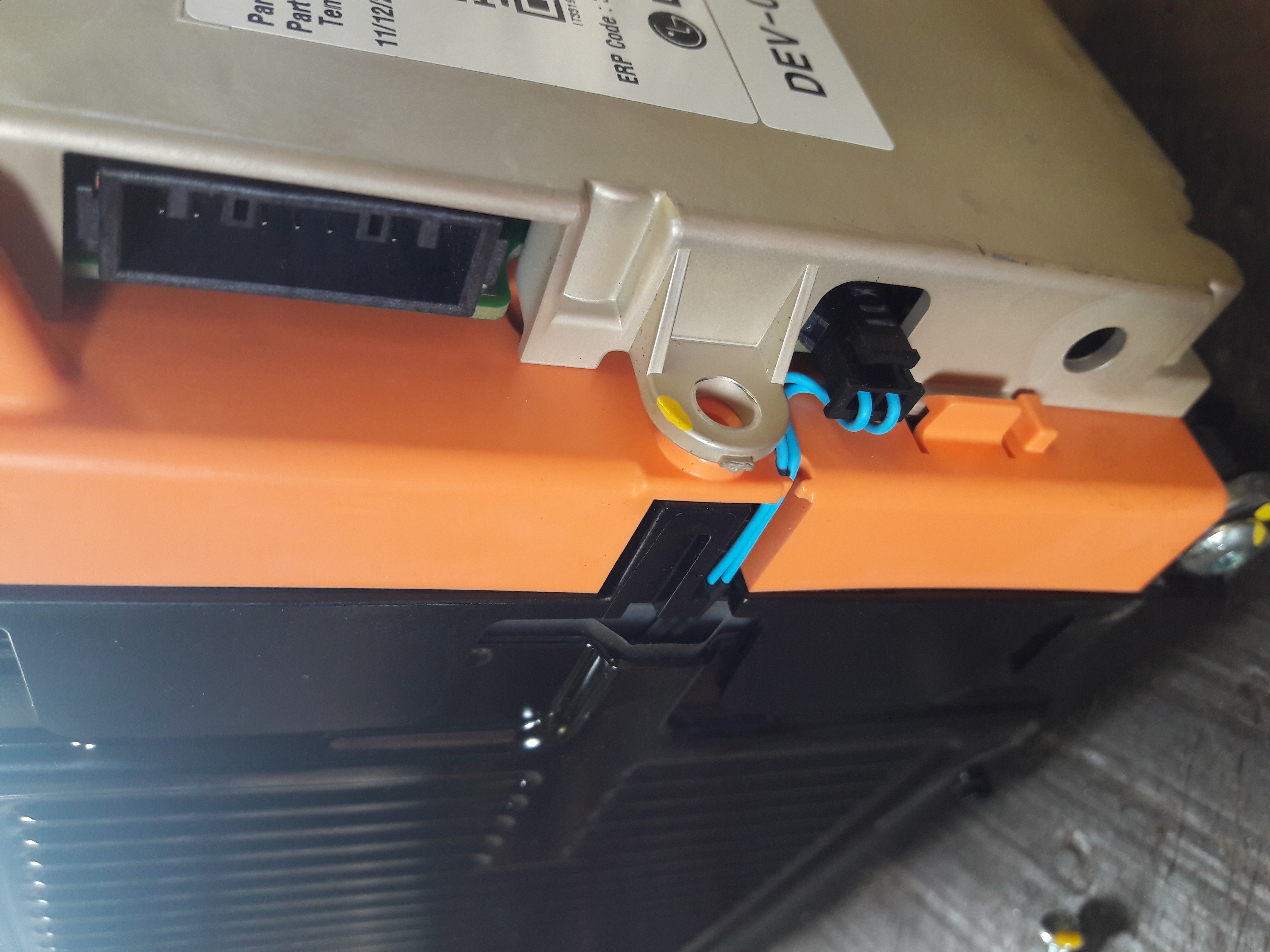

- There is a BMS (with thermistor) attached to each block, and I have no idea how to communicate with it. Maybe someone does, or sees similarities with other (LG) systems sold?

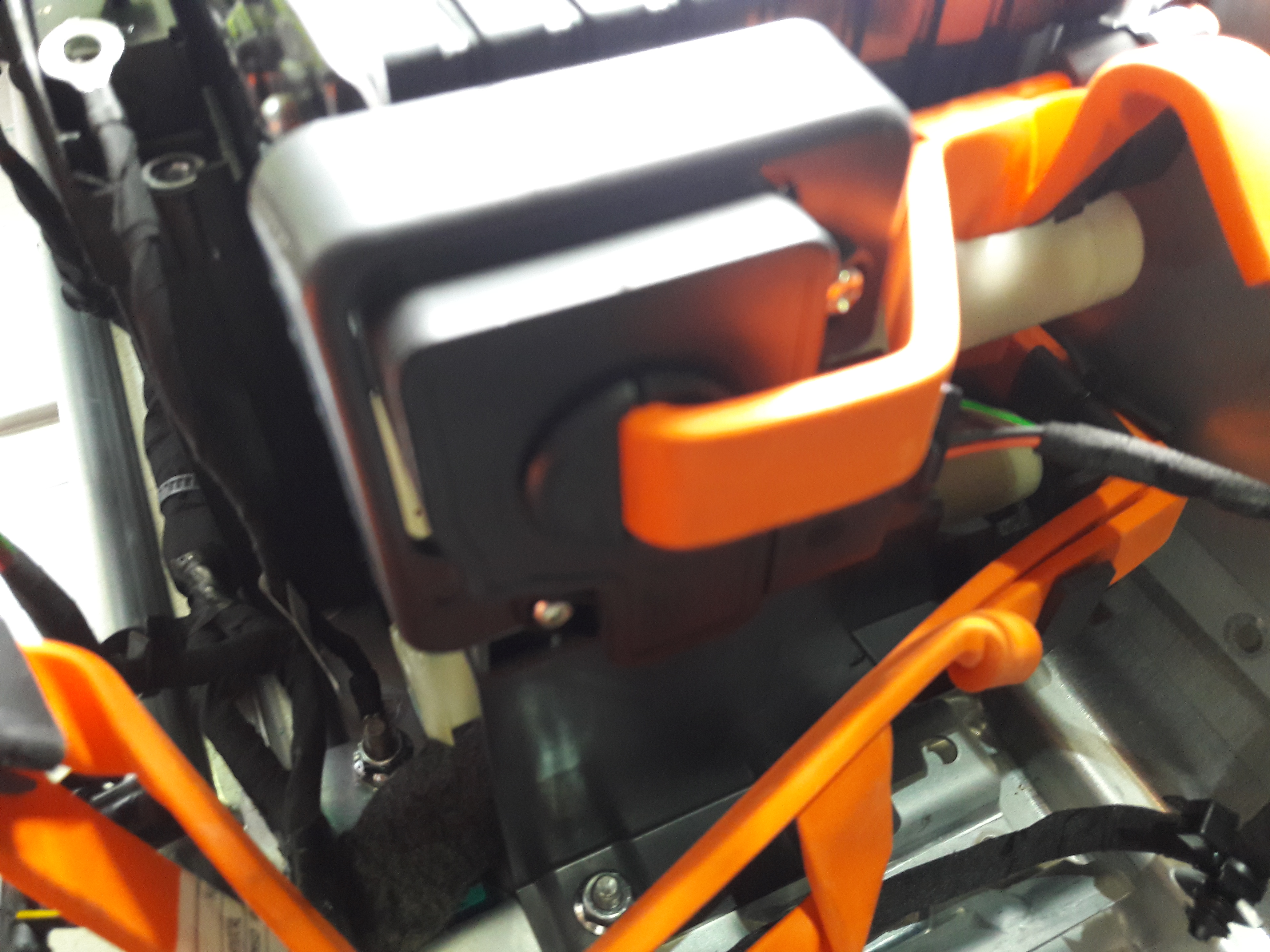

- The pack comes with two contactors and a current sensor.
- The battery box is built to be stored inside a car, it is built of rather thin sheet metal, and seems are sealed with rubber putty.
- The volumetric energy density seems quite high, compared to other hybrid batteries.
All in all, a very nicely built pack.

- I have weighed the battery modules, and these blocks weigh 11kg per block. So, I guess the entire pack might weigh about 120-130 kg.
- The total pack size is about 115x65x21 cm (largest dimensions).

Very good work Bart - do you have approximate dimensions of the full pack?

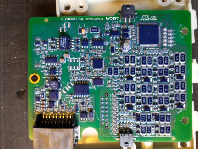

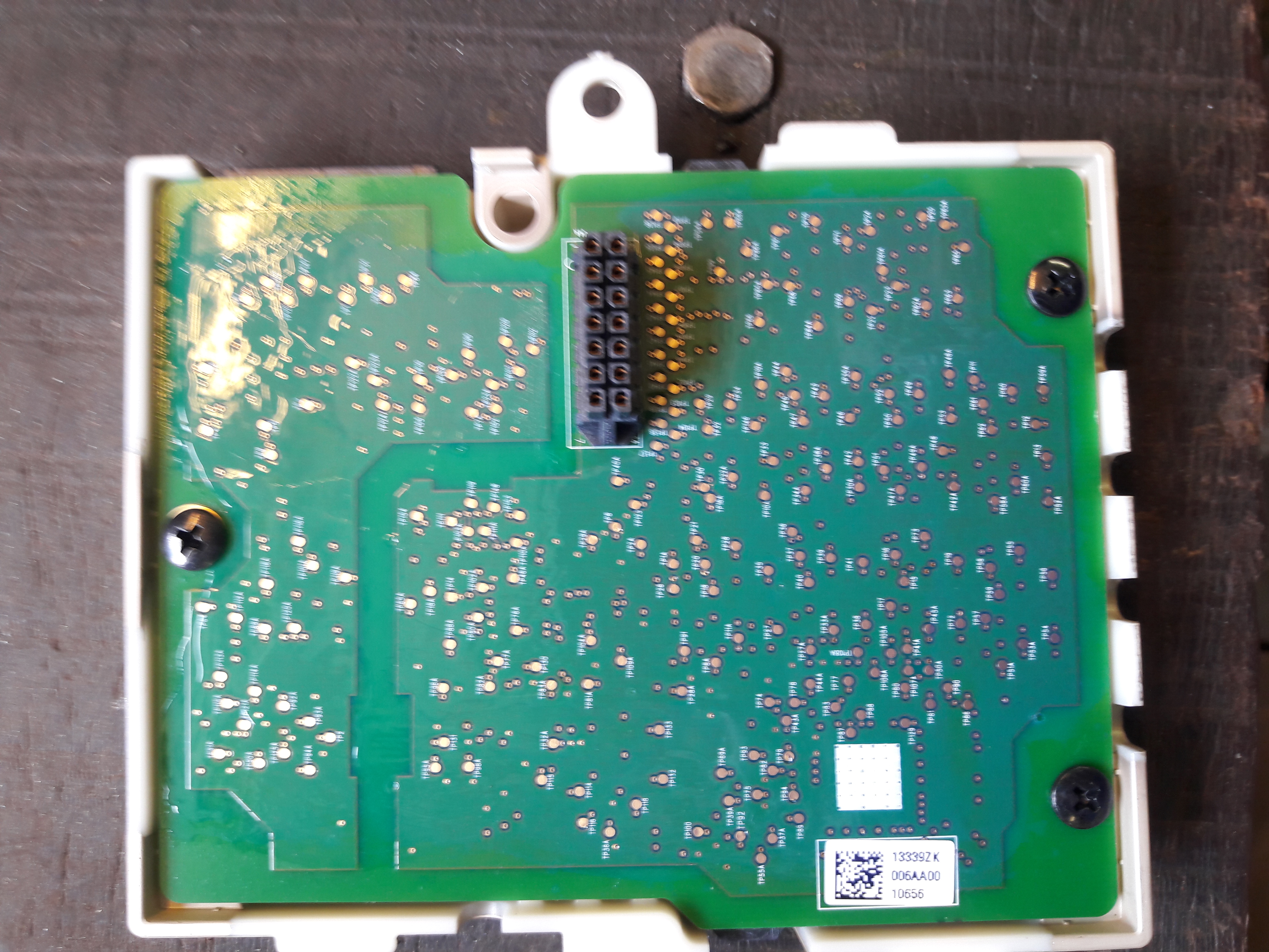

That's possible. I am going to use these packs for my build, and reverse-engineered the BMS-slave communication. Alle slaves are uniquely addressed, and reply the cellvoltages & temperatures after a CAN-request message. From my scratchpad:
- 0X17 (1byte, 100ms rate) requests all slaves to report cell voltages
- 0x1B (1byte, 100ms rate) requests all slaves to report temperatures (2 in the pack, one on the PCB (around the bleeder resistors)
- 0x1F (2bytes, 100ms rate) request some other status messages.
- Balance resistors are activated with telegram 0x1C (3bytes, 100ms rate), but there are some restrictions on the maximimum number of resistors you can simultanously switch on (I guess to limit dissipation).
I will document the messages it one of these days and put it online, or put my BMS-software online when it's fully working.

Remember that just a CAN-log of the HS-CAN or SENSOR/HV-CAN would not help, the internal CAN-bus of the pack is the one you need to use. There is a BMS-master in the pack (large right-up standing module) that I didn't use, I just simulated its function in an arduino (like the SimpBMS does).
If you would like to experiment, just supply the pack with 12V and you can log the communication between the BMS-master & 10 slaves.

Yes there are some similarities, but scaling & adressing is completely different.
From my scratchpad:
Pin 1 = +12V ('rough vehicle 12V', switched by the BMS master, not regulated)
Pin 2 = CAN-L
Pin 3 = CAN-H
Pin 4 = Digital input (internally 50K pulled up)
Pin 5 = GND (only first slave has this pin connected to the master, guess for some kind of 'first slave present' detection)
Pin 6 = Digital output (open collector with 1K in series)
Pin 7 = GND
Pin 8 = CAN-L (parallel to pin-2)
Pin 9 = CAN-H (parallel to pin-3)
Pin 4 & 6 are daisy-chained through the slaves. I suspect for slave addressing. I might have triggered it because the modules on my bench have different addresses to what I initially marked them with. Will test that within a few weeks when having a full pack wired up.

Correct ! Completely different design. V60 BMS has full insulation between LV / HV sides and onboard dc-dc converters for supplying the BMS-chip. So no hassly with putting the BMS-chip into sleep mode preventing it draining the cells.
