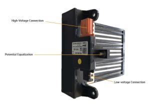

Connectors
High-Voltage Connection
TE HVU 280 series
- Mating housing: 1-2318082-2 (key B)
- Contacts:
- TE-NO: 2-968859-3 (WIRE SIZE 4mm²)
- TE-NO: 2-968857-3 (WIRE SIZE 2.5mm²)
- Seals:
- TE-NO: 828985-1 (WIRE SIZE 4mm²)
- TE-NO: 963292-1 (WIRE SIZE 2.5mm²)
Low-Voltage Connection
VW 1J0 973 723
Potential Equalization
M6x1 lug
