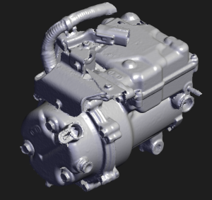

==First Generation (Part Number 7813A378)==
===Dimension and 3D Scan===
[[File:Outlander 7813A378 3D Scan.png|thumb|3D Scan of the Outlander 7813A378 Compressor<ref name=":1">Outlander AC Compressor 3D scan: https://grabcad.com/library/outlander-phev-ac-compressor-1</ref>]]
The 3D scan of the Outlander AC compressor is provided by Tomdb on GrabCAD <ref name=":1" />

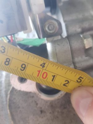

==Second Generation (Part Number 7813B097)==
Currently no 3D scan of the newer style AC compressor is available yet.
{| class="wikitable"
|+Sizes
|Weight
|Weight
|6.2kg
|6.2kg
|Length
|Length
|19cm
|19cm
| Height
|Height
|20cm
|20cm
|Width
| Width
| 12cm
| 12cm

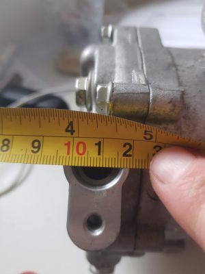

3D scans are here: https://grabcad.com/library/outlander-phev-ac-compressor-1 this appears to be of an older model than the one in the photos below. The photos are from a 2018 model year vehicle.
|[[File:Height.jpg|alt=Height|none|thumb|Height]]
|[[File:Length.jpg|alt=Length|none|thumb|Length]]
|[[File:Width.jpg|alt=Width|none|thumb|Width]]
=== Refrigerant Connections ===
<gallery perrow="3" caption="Dimension of the Model Year 2018 Outlander AC Compressor">
File:Length.jpg|Length
File:Height.jpg|Height
File:Width.jpg|Width
</gallery>

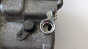

==Connections==
===Refrigerant Connections===
The part numbers for the Mitsubishi hoses are ''AMD45418'', ''AMD46168. Unconfirmed, but thought that these fit'' https://www.evcreate.nl/shop/airconditioning/adapter-set-airconditioning-compressor/
The correct fitments on Aliexpress

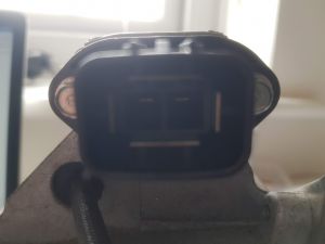

[[File:Heater Connector Pins.png|none|thumb|1 - 12v, 2 - GND, 3 - CAN H, 4 - CAN L]]
=== High Voltage Connection ===
===High Voltage Connection===
The compressor is connected with a 40amp fuse to high voltage.
Older models don't have the HV socket as shown above, but have the wire attached. Polarity is the same as the heater.

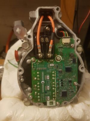

Line 49: Line 86:
[[File:20220712 172319.jpg|none|thumb|AC compressor driver board.]]
3D Scan of the Outlander 7813A378 Compressor[2]
The 3D scan of the Outlander AC compressor is provided by Tomdb on GrabCAD [2]

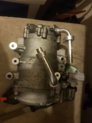

Connections
The part numbers for the Mitsubishi hoses are AMD45418, AMD46168. Unconfirmed, but thought that these fit https://www.evcreate.nl/shop/airconditioning/adapter-set-airconditioning-compressor/ The correct fitments on Aliexpress
Outlander compressor hose connections
https://www.aliexpress.com/item/1005001688953296.html R134 4 curved and R134 5 curved was what I ordered, so 11.5mm and 14mm.
Low Voltage Connection
The mating connector is Sumitomo 6189-0126 https://www.auto-click.co.uk/6189-0126?search=90980-10942 and the pinout is the same as the water heater. Connector also available cheap on aliexpress.
