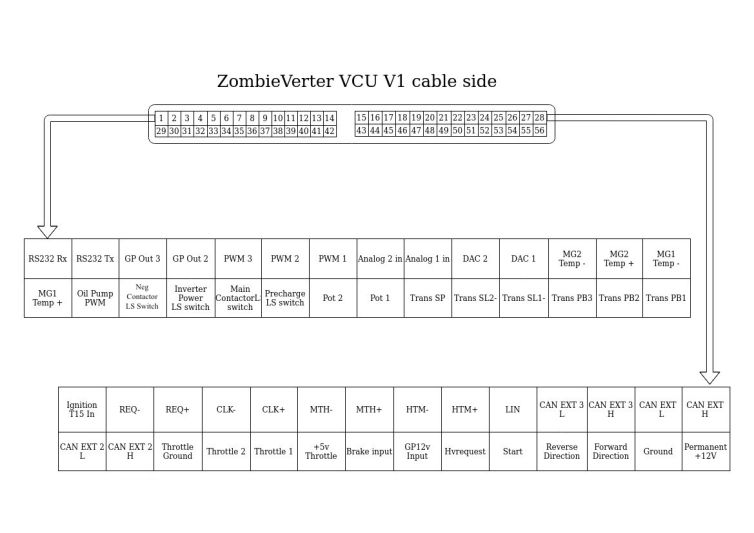

setting up a leaf stack with the zombiverter VCU
the full leaf stack ( motor/inverter, pdm (charger, dcdc, hvjb)) can be controlled with the zombieverter VCU
all you need is 12v and CANbus
wiring
wiring the zombiverter to the leaf harness
the motor/inverter and PDM each use there own canbus. they both can be used independent of one another with the zombieverter.
INVERTER to zombie wiring:
EV SYSTEM CAN-H (pin14) to CAN EXT H (pin 28)
EV SYSTEM CAN-L (pin15) to CAN EXT L (pin 27)
PDM to zombie wiring:
CAN H (ev system) pin 27 to CAN EXT 2 H
CAN L (ev system) pin 11 to CAN EXT 2 L
EVSE CONNECTING SIGNAL pin 29 to
EVSE COMMUNICATION (PWM) pin 30 to
chademo to zombiver:
chademo connector:
HV contactor coil + pin 2 to GP 12v input
HV contactor coil - pin 10
pin 1 to ground
CAN H pin 8 to CAN EXT 3 H
CAN L pin 9 to CAN EXT 3 L
pin 4 to GP out 3
zombiverter pinout
leaf inverter connector pinout
pinout of the pdm
em57 resolver pinout
