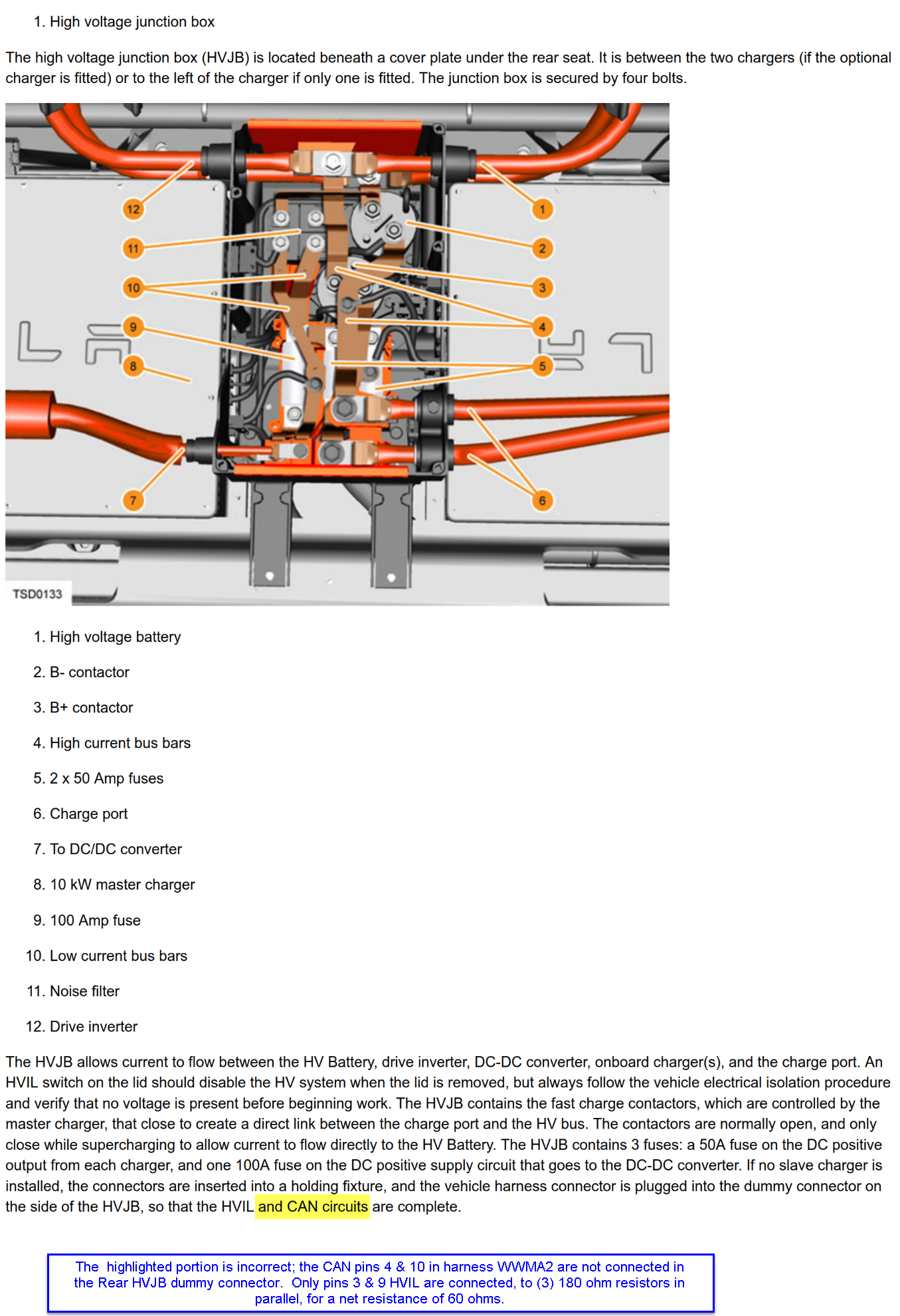

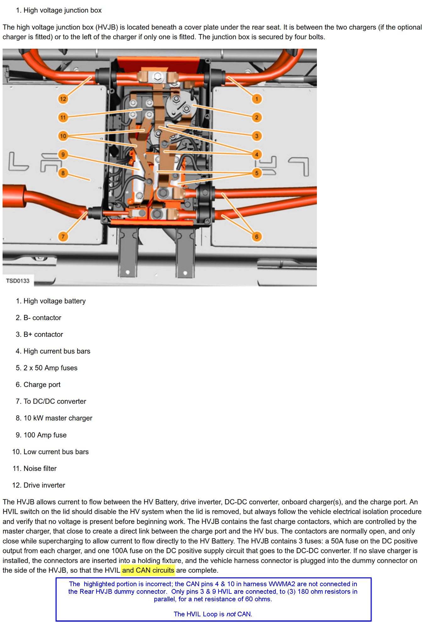

Tesla Model S GEN1 Rear HVJB component details, from Tesla Service Manual, "Theory of Operation" section.
current | 02:48, 27 March 2023 | ![]() | 1,354 × 1,354 (1,011 KB) | Asavage (talk | contribs) | Annotated some of the diagram with fuse purposes, and added '-' & '+' to some wires and bus bars. |
16:30, 24 March 2023 | ![]() | 1,355 × 1,980 (1,017 KB) | Asavage (talk | contribs) | Updated note to reinforce that the HVIL Loop is not CAN. | |
