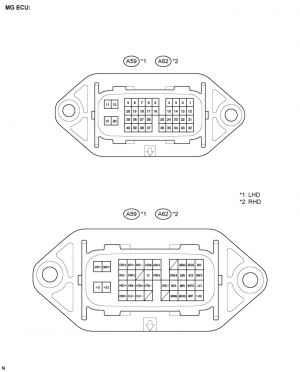

GS450h inverter external connector
GS450h internal inverter connections
The Lexus GS450h VCU is an open source project to repurpose 2006-2012 Lexus GS450h inverters for DIY EV use. It consists of a circuit board and programming that replaces the original logic board in the inverter and allows independent control of it without communicating with a GS450h ECU.
