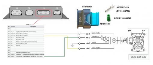

Connector for BMW i3 CCS plug locking actuator is BMW part number 12527549033. Pins and seals should be the same as used on the LIM module.

Charge port lock
Only important for Type 2 (3-phase) charge ports.
In the BMW i3 a quite expensive Phoenix CCS charge port is used and it would be nice to be able to use the cheaper Duosida CCS charge ports.
The charge port lock should work with the Duosida lock as well but the feedback (1k unlocked, 11k locked) is a bit different which requires some additional resistors.
If using an OEM BMW i3 CCS charge port, the Kuster lock uses connector BMW 12527549033, around USD$4.
